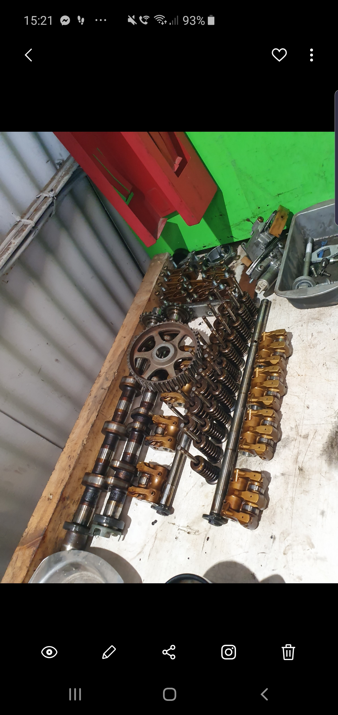

Re: rs6 c5 rebuild
heads 1 stripped and quick clean ready for work
