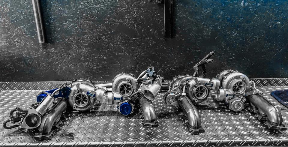

Well, this thread is called Turbos - options, and it appears that there may be another option coming up in the shape of the TTH 1100. The turbos are presumably made by Turbo Technik Hamburg, fitted by RS Engineers and tuned by THT Performance. They'll be licking their lips in Germany. Maybe they've had some good results from the prototype Wagner C6 SMICs, or it could be that it's old post that pre-empted the eventual TTH-1050 production units.

EDIT: I also found this 1000 bhp BUH turbo upgrade from Holex in Germany. Don't know much about them, but they've been around a long time and have great feedback:
https://www.ebay.co.uk/itm/Turbolader-U ... 364c5d9de5
Turbocharger Upgrade 1000hp AUDI RS6 5.0 TFSI V10 BUH 07L145701J 07L145702J
Click to enlarge the image
https://www.facebook.com/17183085750589 ... 827076592/
https://scontent.fltn1-2.fna.fbcdn.net/ ... e=5E12AA27
Product Name: Turbocharger Upgrade 1000hp AUDI RS6 5.0 TFSI V10 BUH 07L145701J 07L145702J
Original loader IHI (refurbished)
Additional modifications:
Compressor and rear wall CNC machined
larger milled compressor wheel with optimized wheel geometry
CNC machined exhaust housing for larger turbine wheel
reinforced pressure cans, 1.4 bar opening pressure
reinforced, lasered pressure can holders
Intake manifold arches CNC machined
Bypass flaps newly stored
This loader modification can be used for powers up to 1000PS (assuming appropriate hardware and software)

I asked the question about TTH and if anyone had any experience with them and no one replied. As I found these on ebay which I thought was a great price for their 850 bhp spec versions - https://www.ebay.co.uk/itm/Upgrade-Turb ... 1438.l2649

We are removing the TTE1000’s off my car and returning to the 850’s. We ran the 1000’s on the dyno with the airboxes removed and wastegates shut etc. Maxed out these turbos make 1.2 bar and 850ps with 1000nms on 99oct fuel. Given that these are maxed, race fuel won’t make a difference as we can’t run any more boost. I can make more power and more torque on the 850’s. If i wasn’t selling the car I’d be interested in continuing on with development

Sorry to hear about that, we've all been waiting with baited breath.
TTE routinely produce turbos that can push 2 bar, but something's gone wrong here. I wonder what TTH do differently?
Have TTE said what they're going to do?
Are you going to put your car back to how it was?

I’ll be returning the car to the previous 1000ps spec mate yes. Might make a little more as we’ve upgraded the exhaust. With regards to TTE I’ll find out tomorrow if they have any other proposals. For me though it’s time to bow out, I really want to get started on a TT R8 project. Whoever lands my c6 is getting a special car though
Re: Turbos - options.
With regards to TTH I have no idea what they do differently. They still run stock manifolds and I’ve yet to see a dyno with 1150ps. Highest I’ve seen is 1050 which I can do on the TTE 850’s
