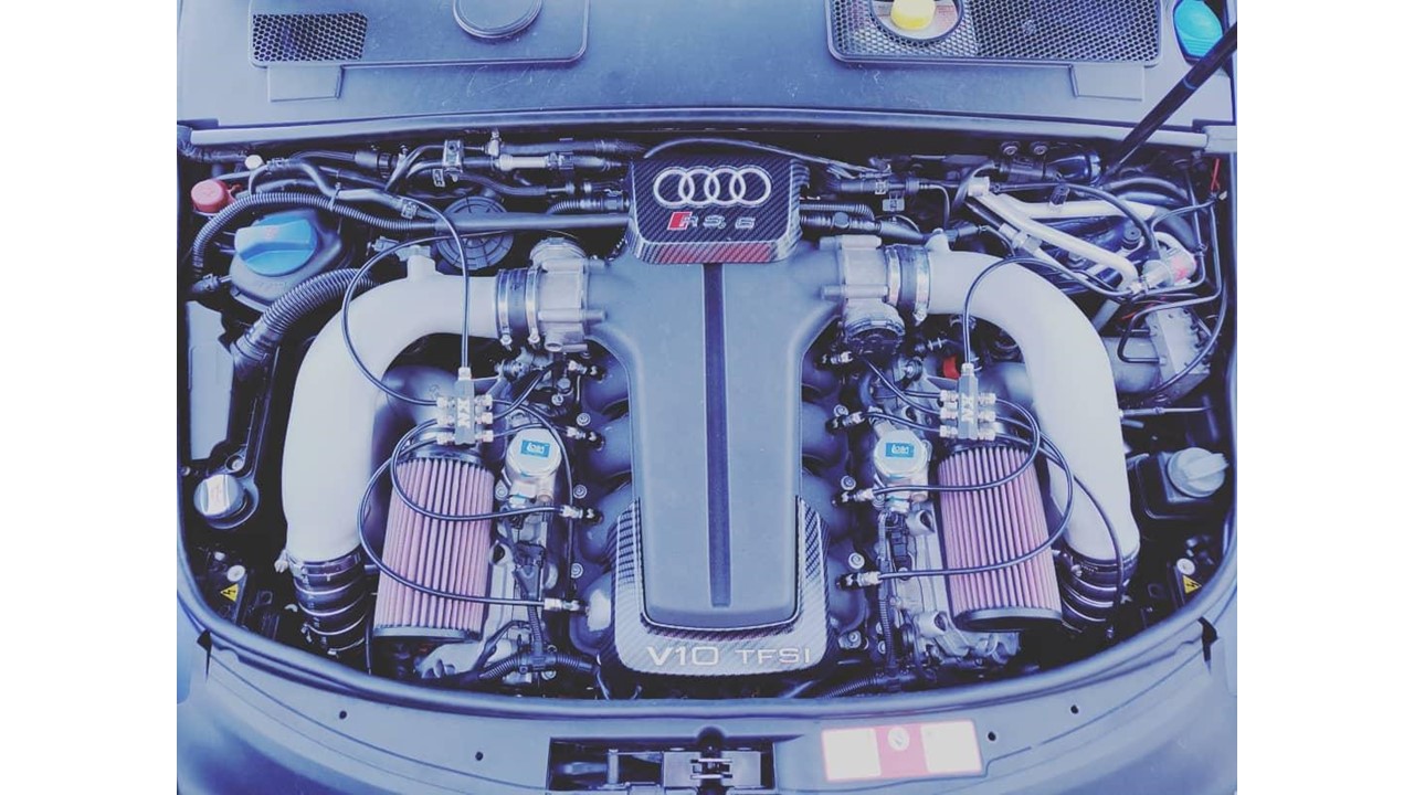

Anybody interested in big power might be interested in the Milletech intake that replaces the standard airbox and filter.
It looks very nice, with big pipes, smooth turns and big cylindrical filters.
However, there's no cold air intake, which might hurt real world performance.
https://www.audiboost.com/content.php?1 ... mm-intakes
https://www.boostaddict.com/images/impo ... 5332-1.jpg
If there was a way of integrating those filters into the stock airboxes they might be on to a winner.
Nick
