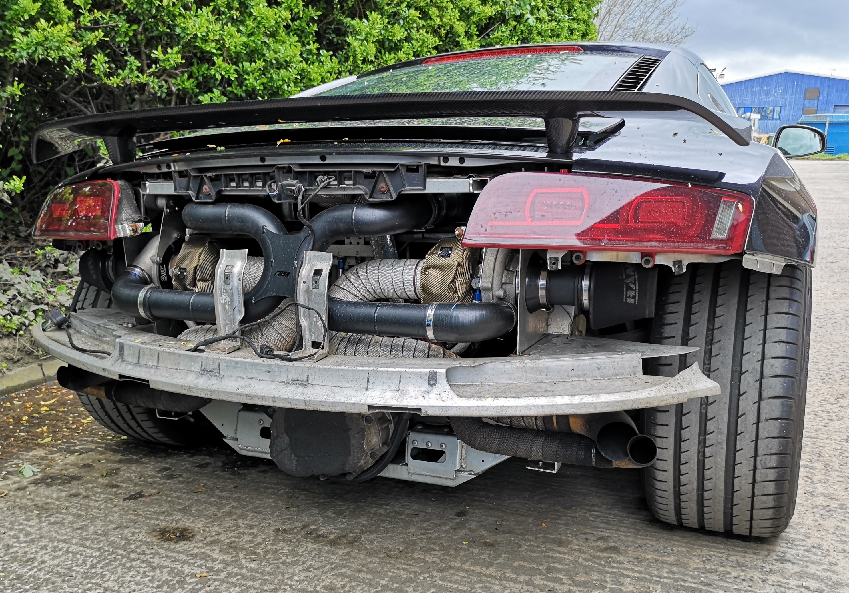

The Turbosmart Boost Controller is installed, along with turbo blankets and uprated high & low pressure fuel pumps.
The cats are out.
Boost is up, map is tweaked.
Was a bit of a scramble (with several complications, requiring ferrying of parts around the country to resolve and last-minute work), but got the car back just in time to attend the World Record attempt at Goodwood (largest number of R8s gathered in one place).

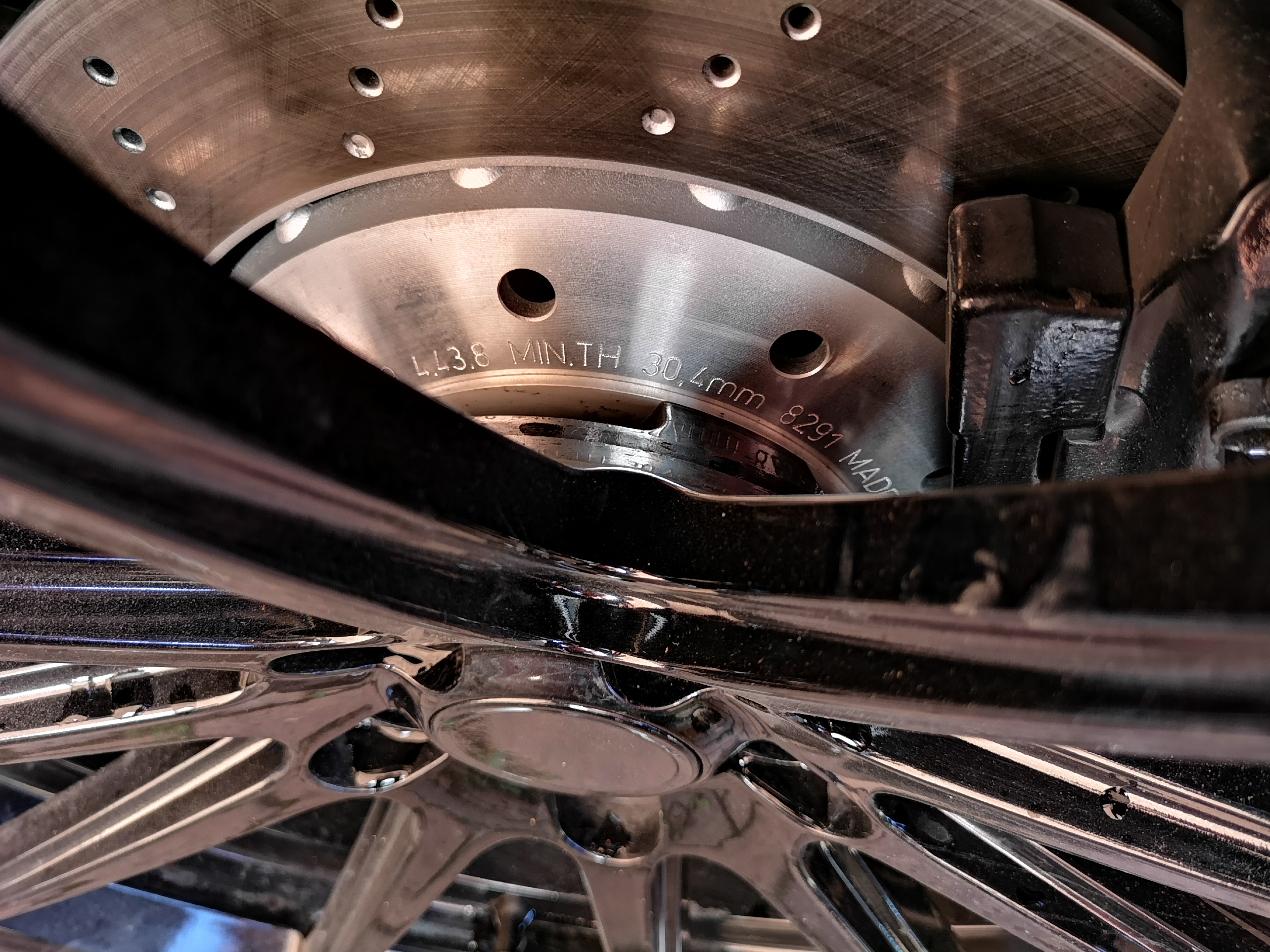

There was a bit too much poke for my liking, with the new wheels:
Rears were an easy fix, as previously had 10mm spacers fitted - so just needed to reduce them down a bit (to the minimum required to clear the calipers).
However, the front custom larger (380mm) discs had bells that, effectively, included a 10mm spacer. I could have just had new bells made up (especially as the existing 380mm rotors have very little wear), but didn't fancy the idea of the car being stuck on a ramp/stands for a week or two whilst they were being fabricated.
Also, the rear spacers were hiding a few other issues that needed addressing...
Net result? A bit of a shopping list of parts...
(Plus new rear hubs and bearings)
Happy with the outcome.
A lot of money for something that most people will never even notice the difference, but at least the new pads should help improve the braking performance even further (once bedded in!).
...plus, it's nice to have shiny rotors and bells!
