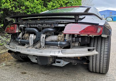

The steering wheel is now installed (much improved feel).
The Turbosmart Boost Controller is installed, along with turbo blankets and uprated high & low pressure fuel pumps.
The cats are out.
Boost is up, map is tweaked.

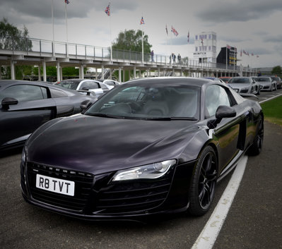

Was a bit of a scramble (with several complications, requiring ferrying of parts around the country to resolve and last-minute work), but got the car back just in time to attend the World Record attempt at Goodwood (largest number of R8s gathered in one place).
Created a couple videos of the event (mainly the convoy there):
https://youtu.be/Kq42y7oUCPs
https://youtu.be/aALdx3IGJVg
It's getting there...! 8)

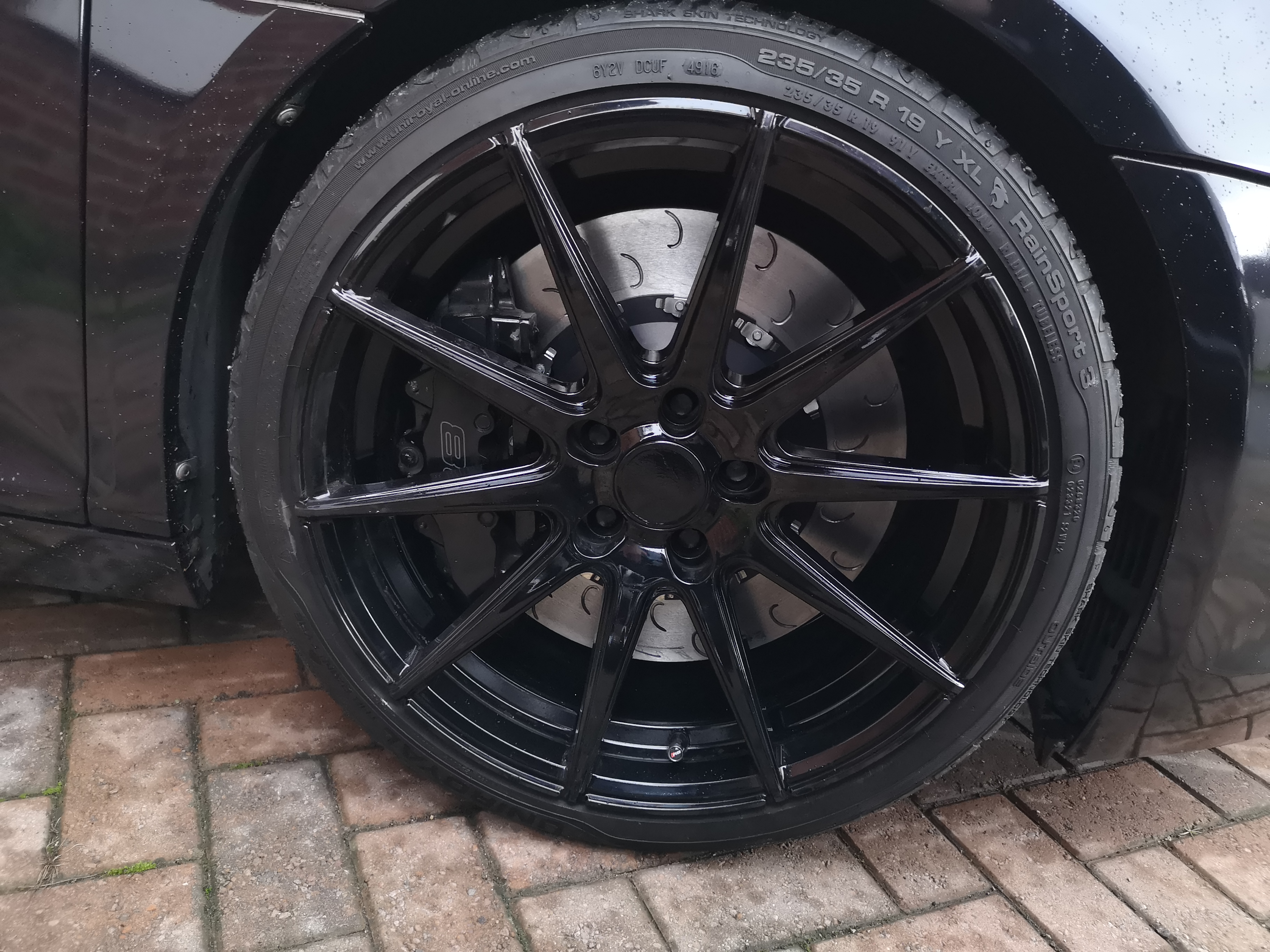

Post by TechNick » Fri Aug 23, 2019 6:25 pm

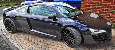

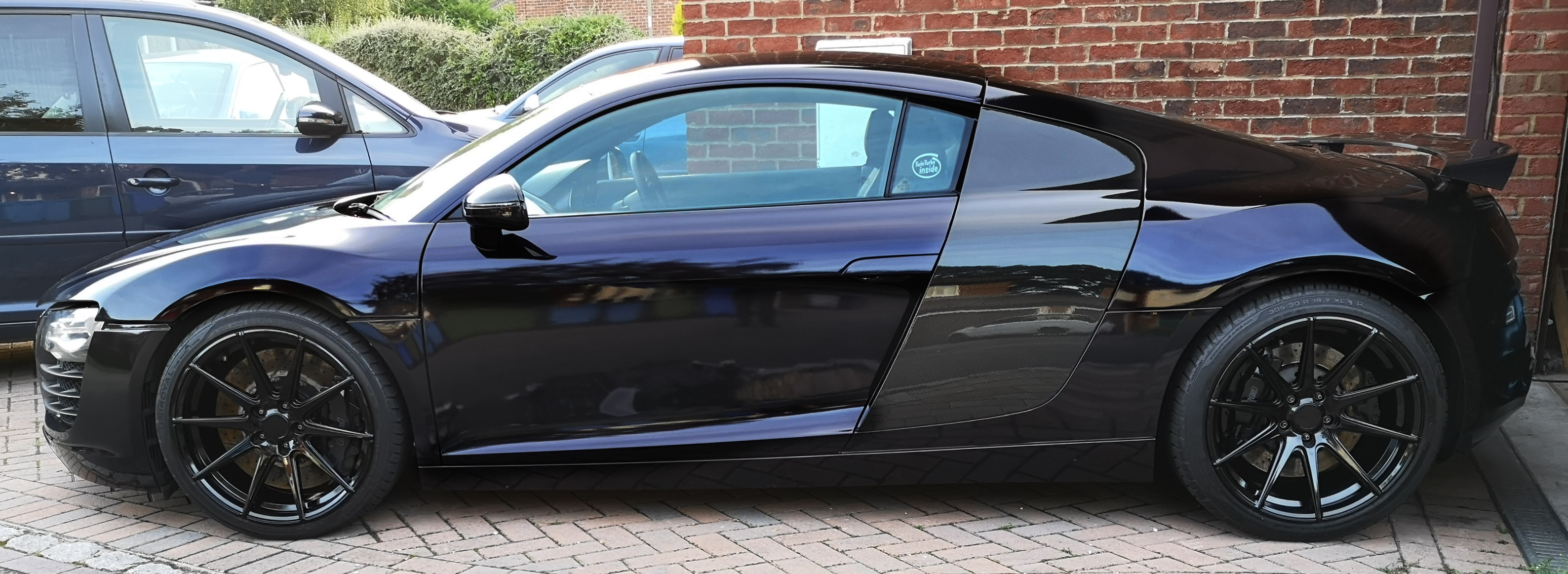

New shoes :boots: :boots:

FrazerD wrote:They look great. Are they Inspiri? If that’s how you sell them?
Cheers :thumbs:
Thanks Frazer.

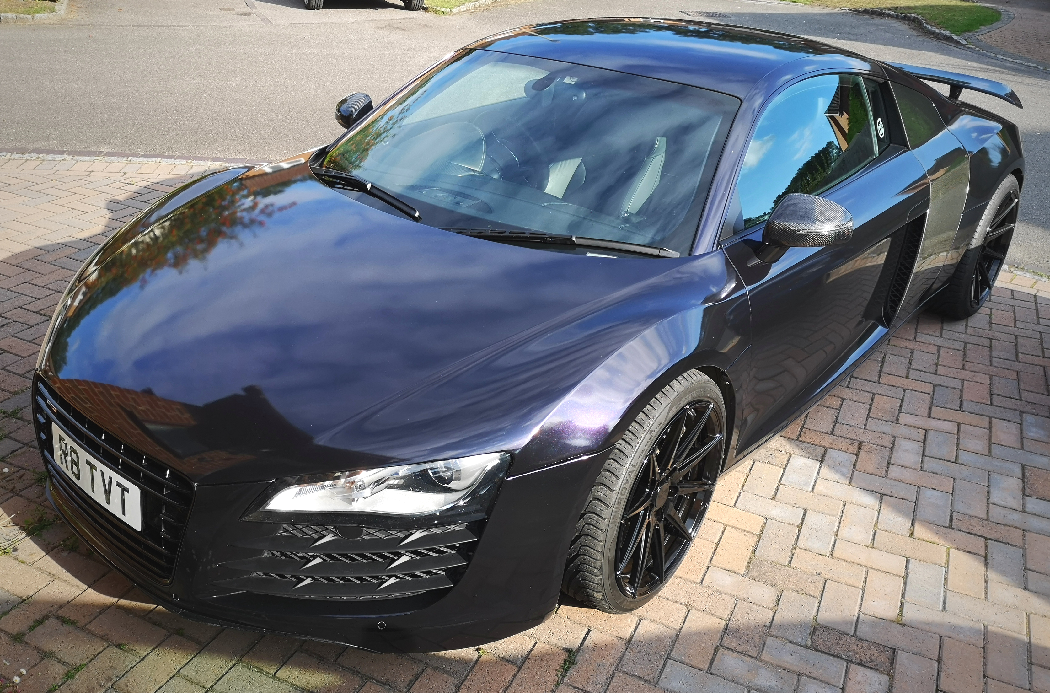

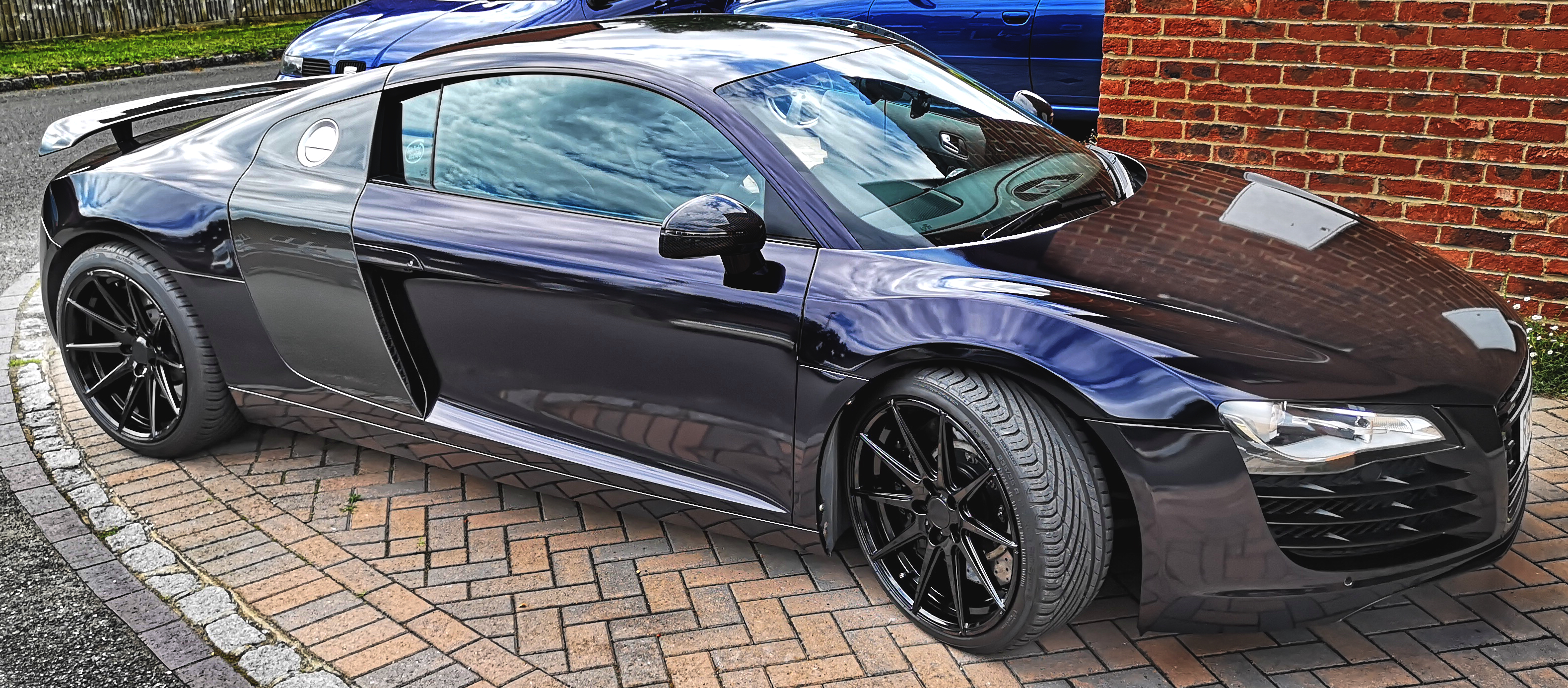

Very similar look to the Ispiri FFR1 (which I'd also considered), but these are Judd T311R - I wanted to retain OEM sizes (19x8.5J fronts, 19x11J rears), and most manufacturers (including Ispiri) just don't seem to make them.
Fitment's not easy on these, especially when going for concave! ImageImage
FrazerD
Posts: 837
Location: Suffolk/Moray
Re: TechNick's Twin Turbo R8
Post by FrazerD » Fri Aug 23, 2019 10:12 pm
TechNick wrote:
Fri Aug 23, 2019 9:32 pm
Thanks Frazer.
Can I ask why out of curiosity? Surely going wider at the front would look better and also put more rubber on the road?
Cheers :thumbs:
TechNick
Posts: 1147
Post by TechNick » Fri Aug 23, 2019 11:10 pm
FrazerD wrote: Can I ask why out of curiosity? Surely going wider at the front would look better and also put more rubber on the road?
Cheers :thumbs:
There just isn't much space to play with - everything's very compact and precise. As it is, the slight concave on the fronts means I've had to space them out slightly to clear the calipers (and they only just clear the arch liners on full lock). Even the rears only clear the calipers with a bit of spacing.
Wider wheels would really need wider trak - i.e. wider arches, different suspension and steering setup, etc.
FrazerD
Posts: 837
Post by FrazerD » Sat Aug 24, 2019 12:54 pm
Interesting, a lot more involved then. Regardless, they look very good.
Cheers :thumbs:
TechNick
Posts: 1147

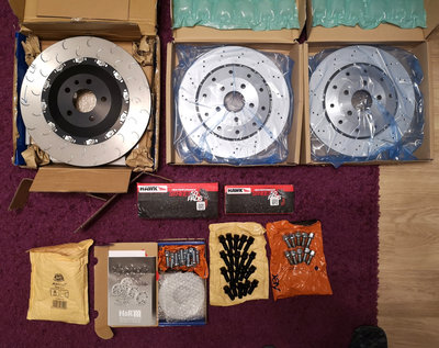

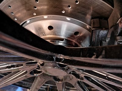

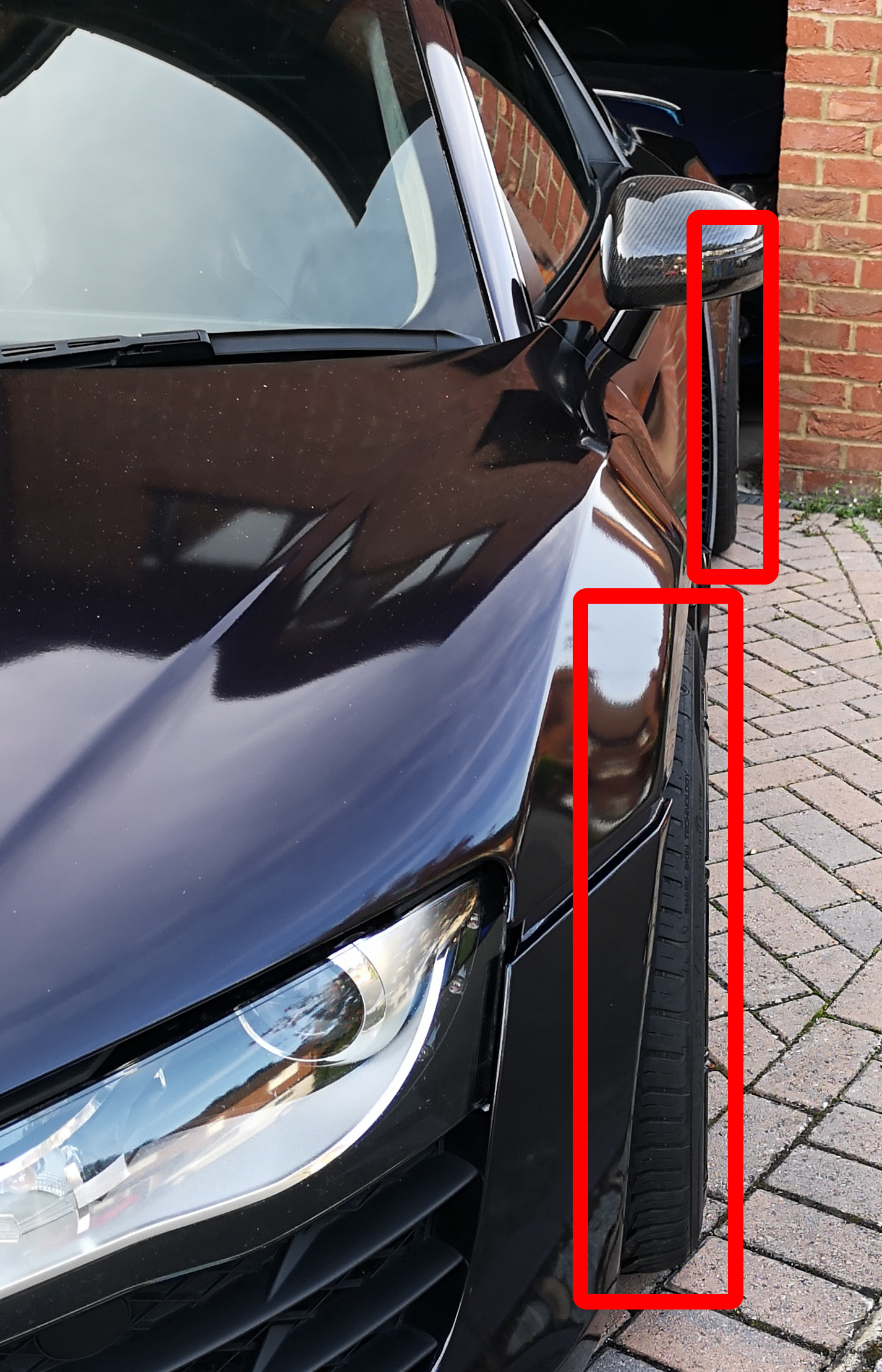

Post by TechNick » Sun Oct 20, 2019 1:55 pm

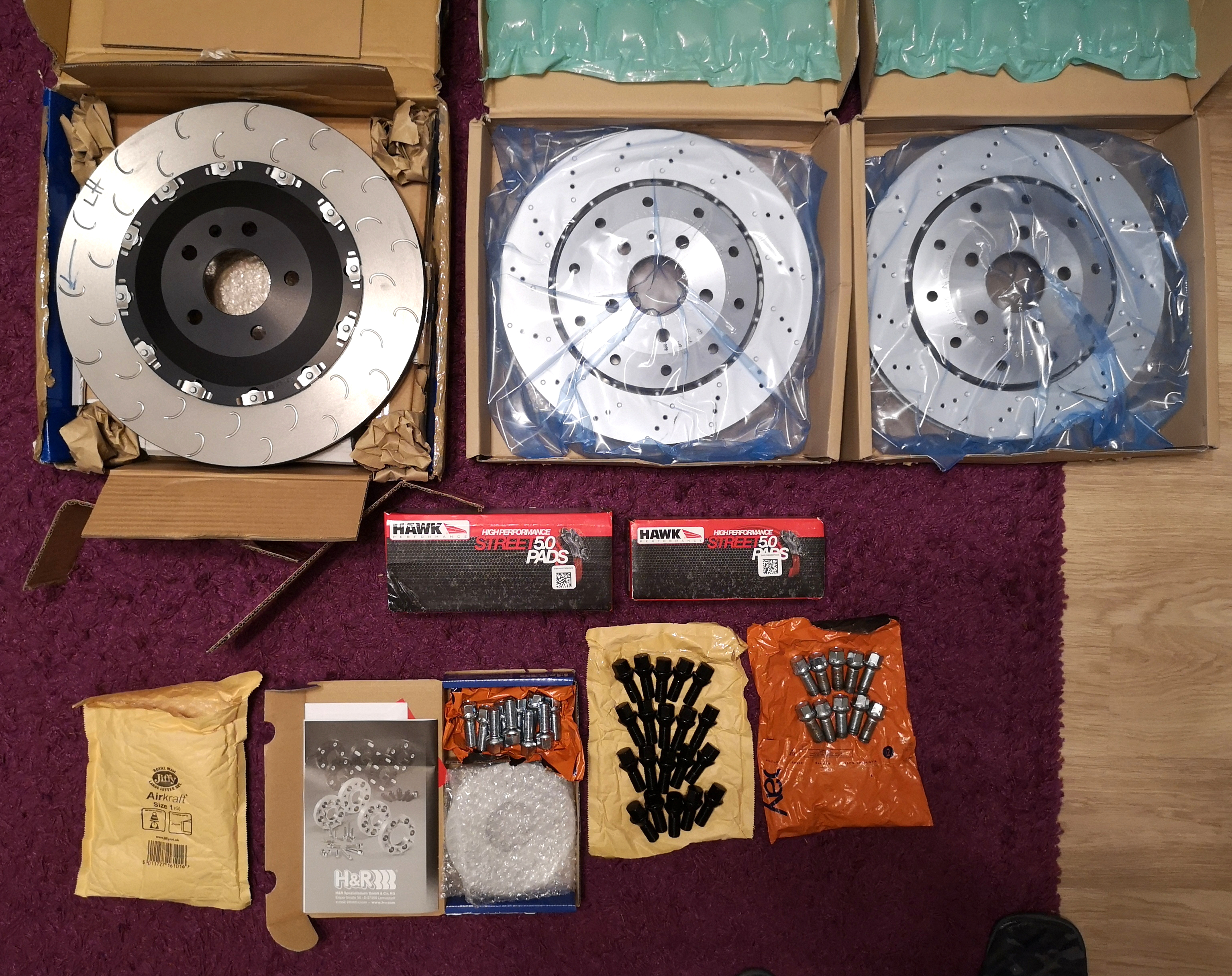

There was a bit too much poke for my liking, with the new wheels:
Rears were an easy fix, as previously had 10mm spacers fitted - so just needed to reduce them down a bit (to the minimum required to clear the calipers).
However, the front custom larger (380mm) discs had bells that, effectively, included a 10mm spacer. I could have just had new bells made up (especially as the existing 380mm rotors have very little wear), but didn't fancy the idea of the car being stuck on a ramp/stands for a week or two whilst they were being fabricated.
Also, the rear spacers were hiding a few other issues that needed addressing...
Net result? A bit of a shopping list of parts...
(Plus new rear hubs and bearings)
Happy with the outcome.
A lot of money for something that most people will never even notice the difference, but at least the new pads should help improve the braking performance even further (once bedded in!).
...plus, it's nice to have shiny rotors and bells! 8) :lol:
