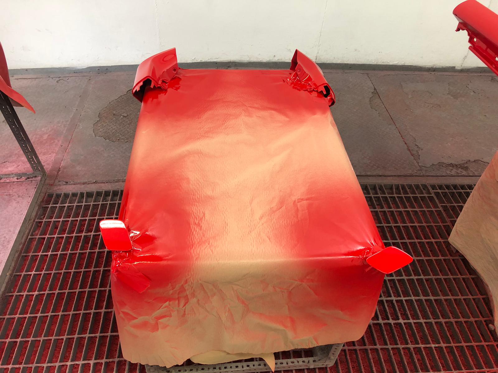

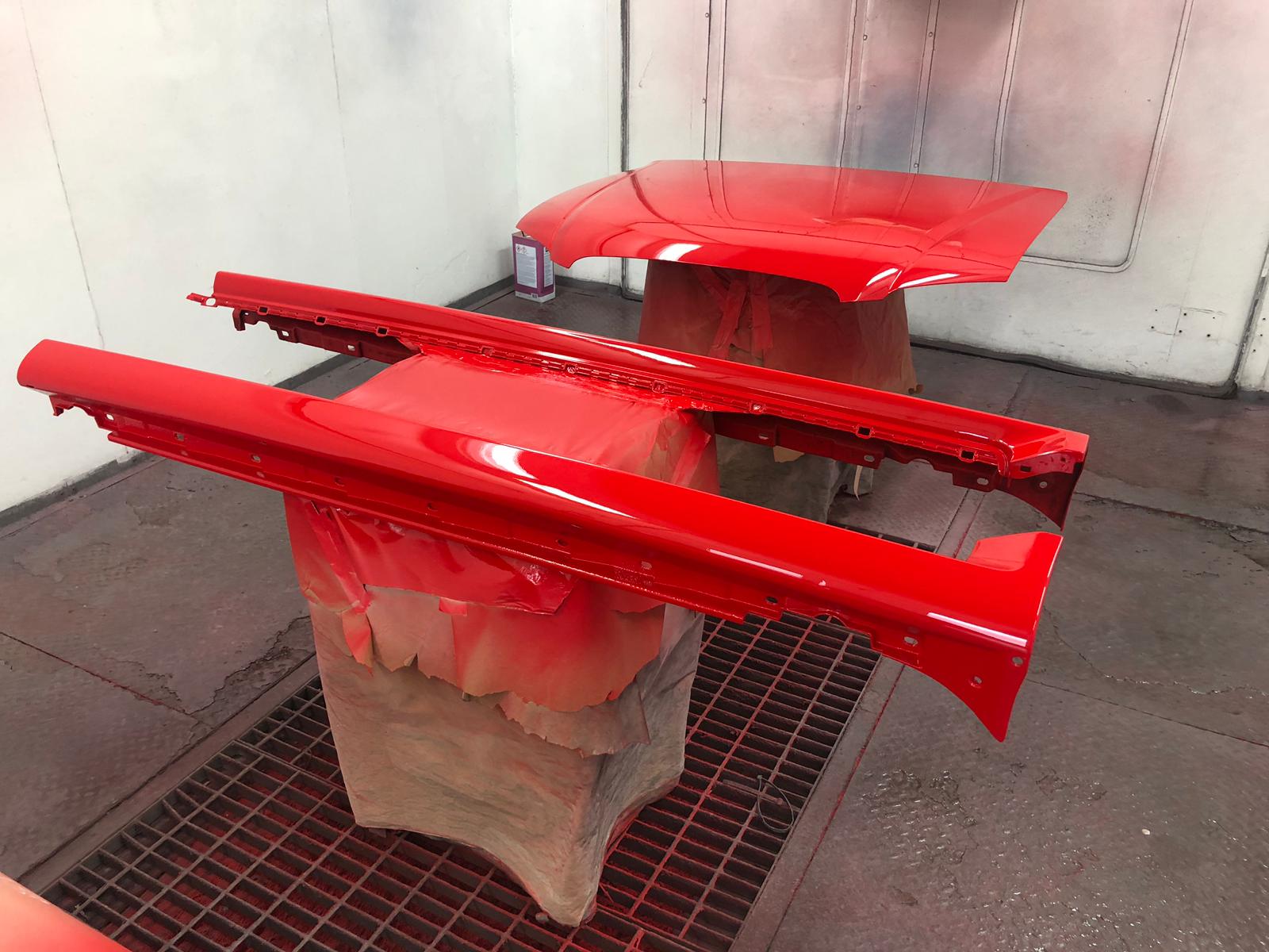

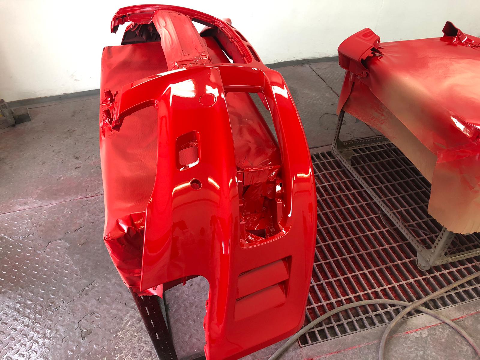

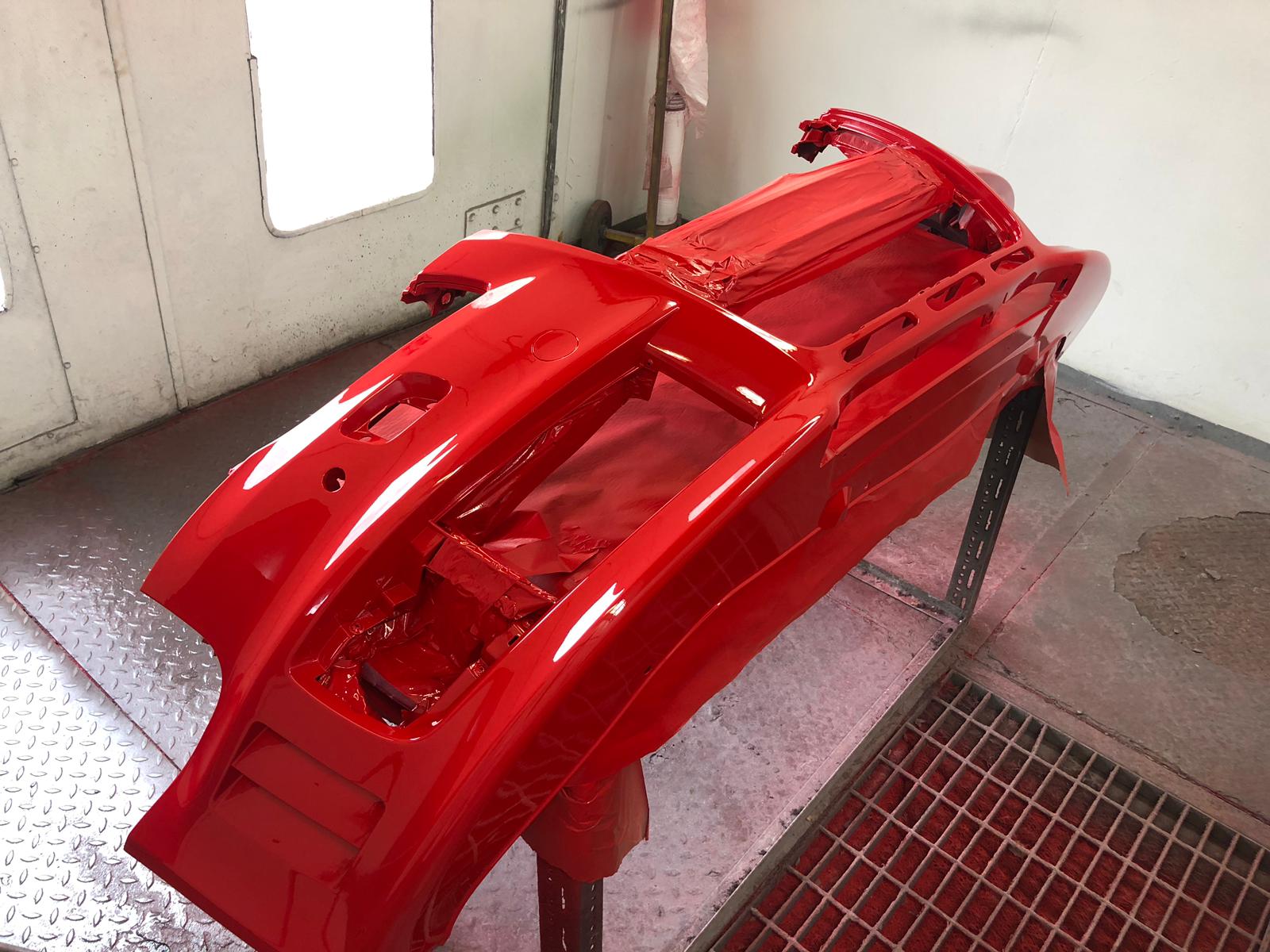

The bonnet, bumper and side skirts all have fresh paint on them now.
If these are anything to go by, the car is going to look great when finished.

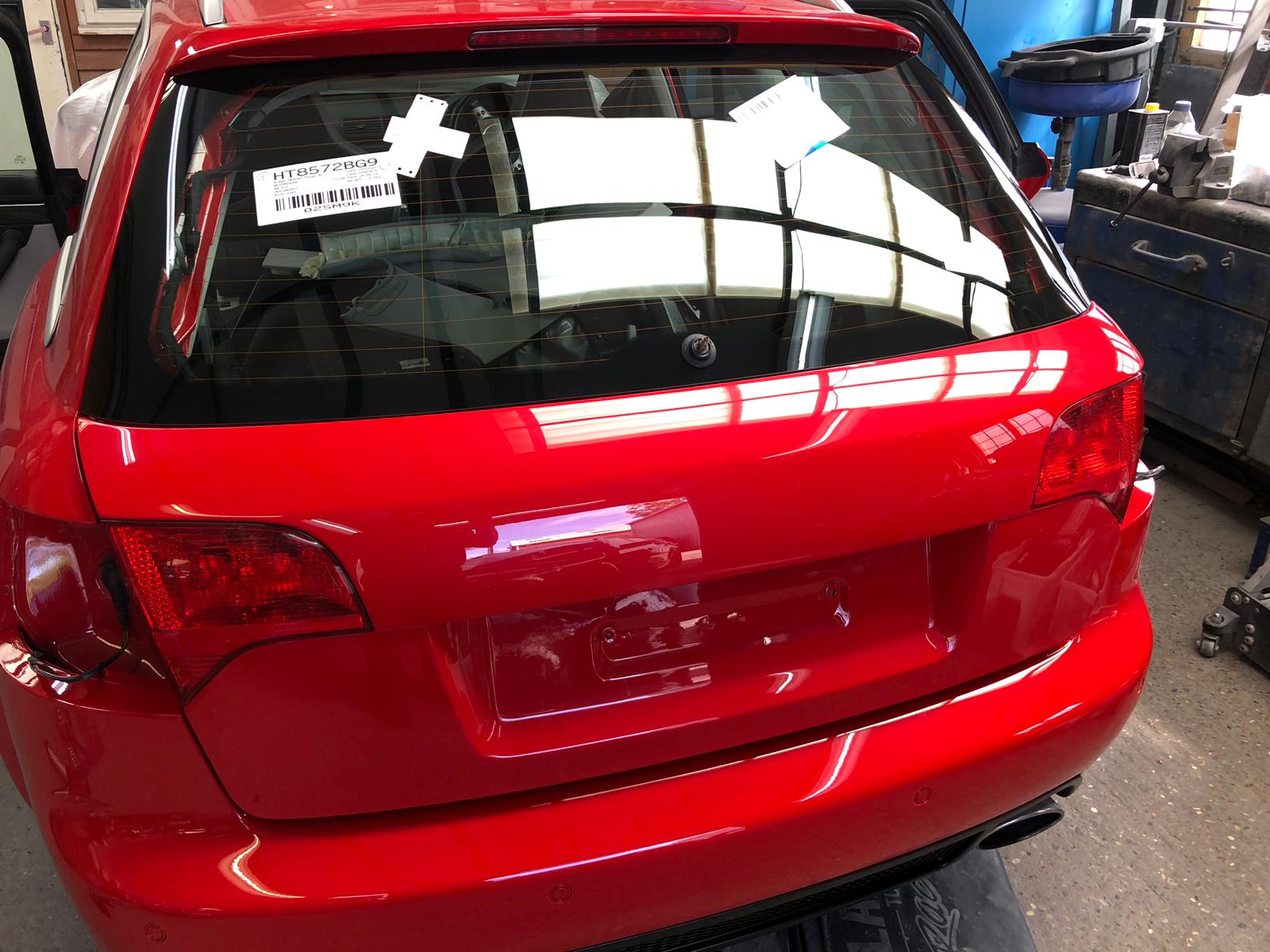

Update from the paintshop, the car is almost fully back together, just some bits of trim, bonnet and badges to go back on.
All going to plan, I will be picking it up next week!
Been planning this for a long while now and having not seen the car since the beginning of April, I am really looking forward to picking her up
Booked in for a full geometry alignment the following day so I will get them to set the front arb to soft and adjust the rear ride height to SS+.
And then finally get around to changing that coolant expansion tank.....

Picked the RS4 up from the bodyshop on Monday, I can't fault the quality of the finish, it has turned out much better than I could have hoped for.
Panel gaps and shut lines are spot on. The new front and rear screens make a huge difference, it feels like a new car now.
Full geometry check carried out on Thursday and it turns out the anti roll bars were already on the softer settings. Rear ride height raised up as it was sitting a bit too low vs the front. Might have went a touch too far but will see how it settles.
The front can't go any lower as the downpipe flexi-hoses already catch on a speed bump near my house.
Nice to have the car back again and another step closer to getting it how I want it.
