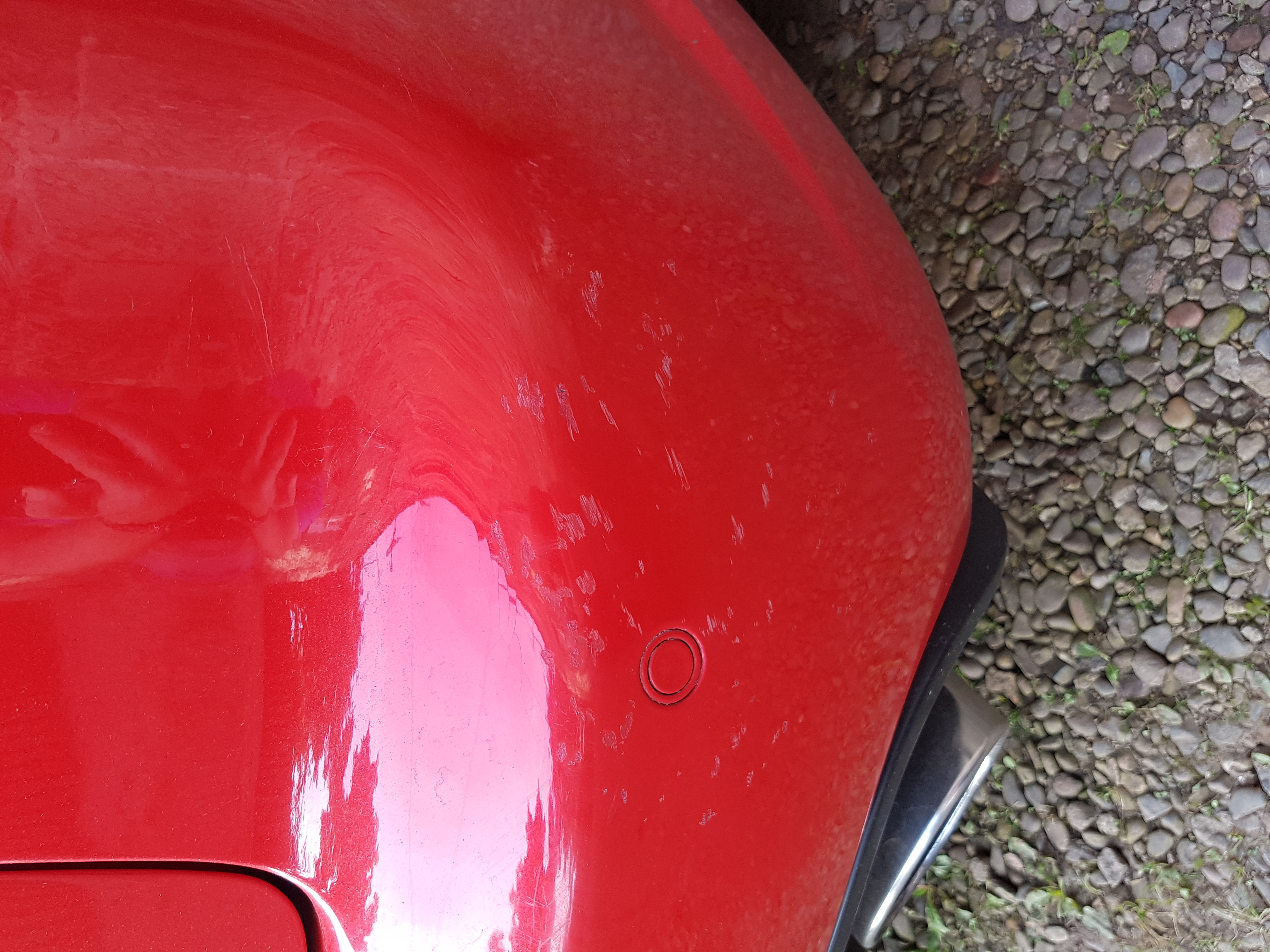

So, after owning my B7 RS4 Avant for over 8 years I slowly started to notice that the body work was starting to need attention in a few places. Not surprising really, it was now almost 13 years old with 161,000 miles on the clock.
I did briefly consider selling it, but in the end there was honestly nothing else out there that I would prefer to drive.
The worst of the paint defects were on the rear arches, these were starting to bubble quite badly and my local indie also pointed out that there was a bit of corrosion on the sills when it was in for a service.
There was also a minor incident involving a postman and reversing into my own house that left a bit of damage on the rear bumper.....
Now, after reading some horror stories about dodgy full resprays and with the prospect of potentially having to have the rear panels cut out and new ones welded in, the hunt was on to find a body Shop with a good reputation.
Being based in Scotland narrowed it down a bit but I did manage to get some local quotes. The places I went to were a bit hit and miss. Some were suspiciously cheap, others appeared knowledgeable but never had much stuff in being work on. One paintshop never even bothered sending me the quotation in the post because they could not see the logic in painting the whole car...it was just an old Audi to them. In the end I decided to bite the bullet and take it to a well respected bodyshop in England.

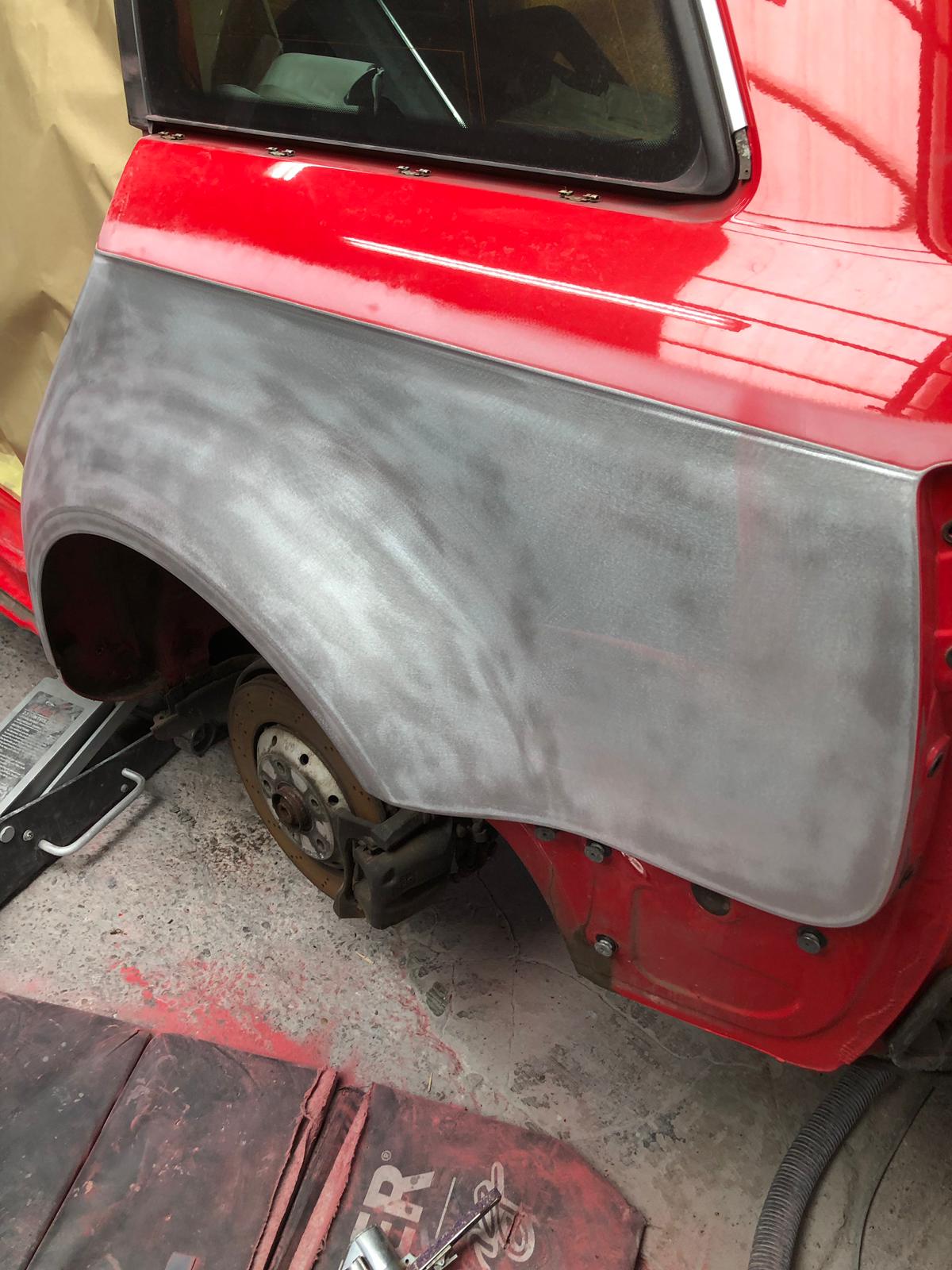

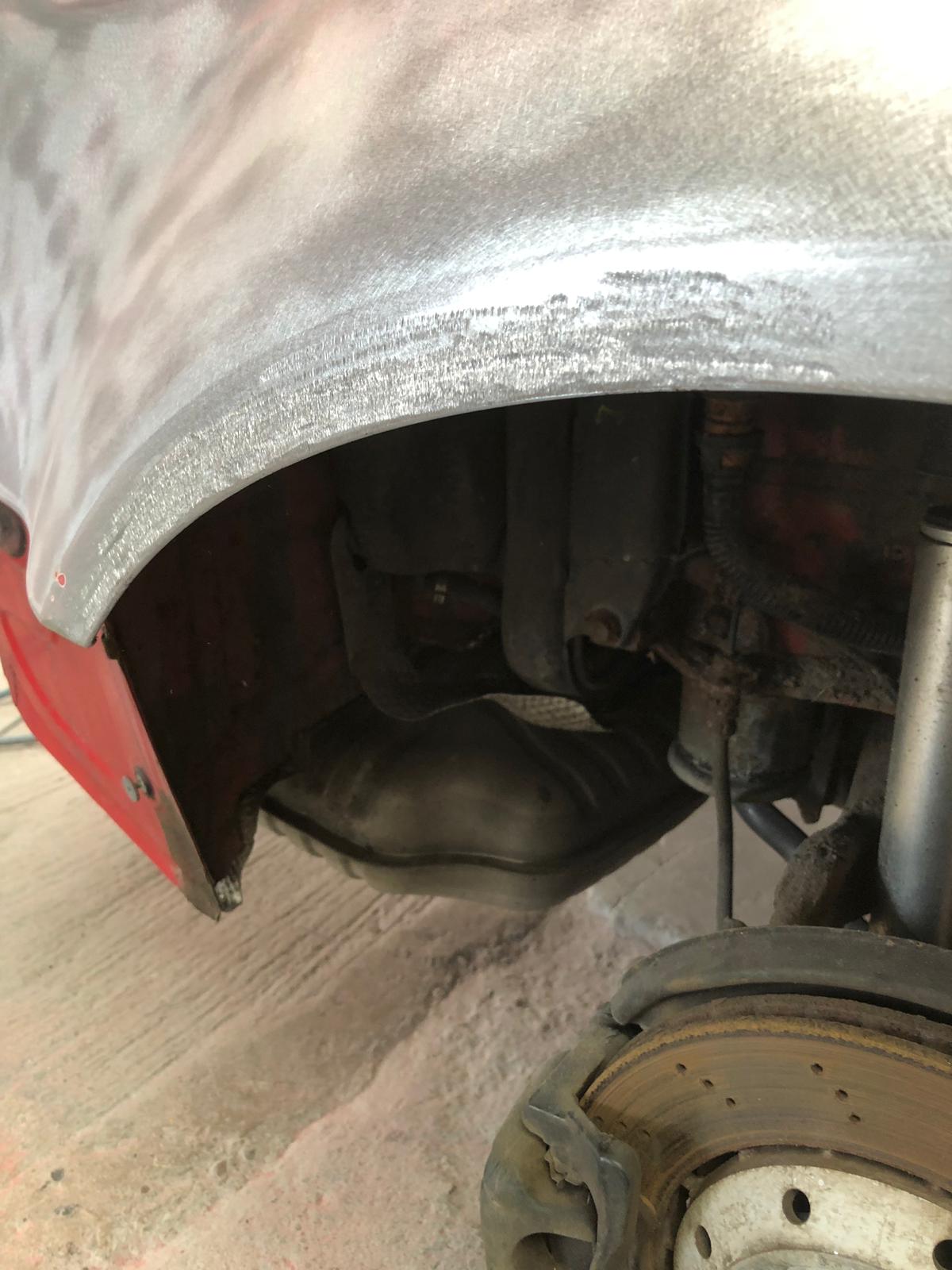

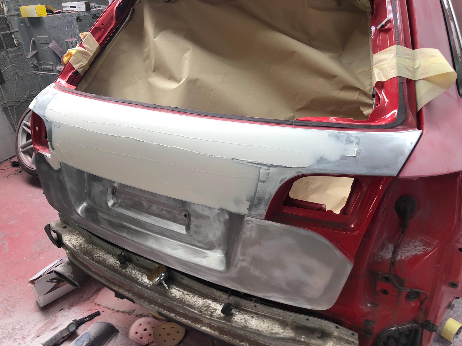

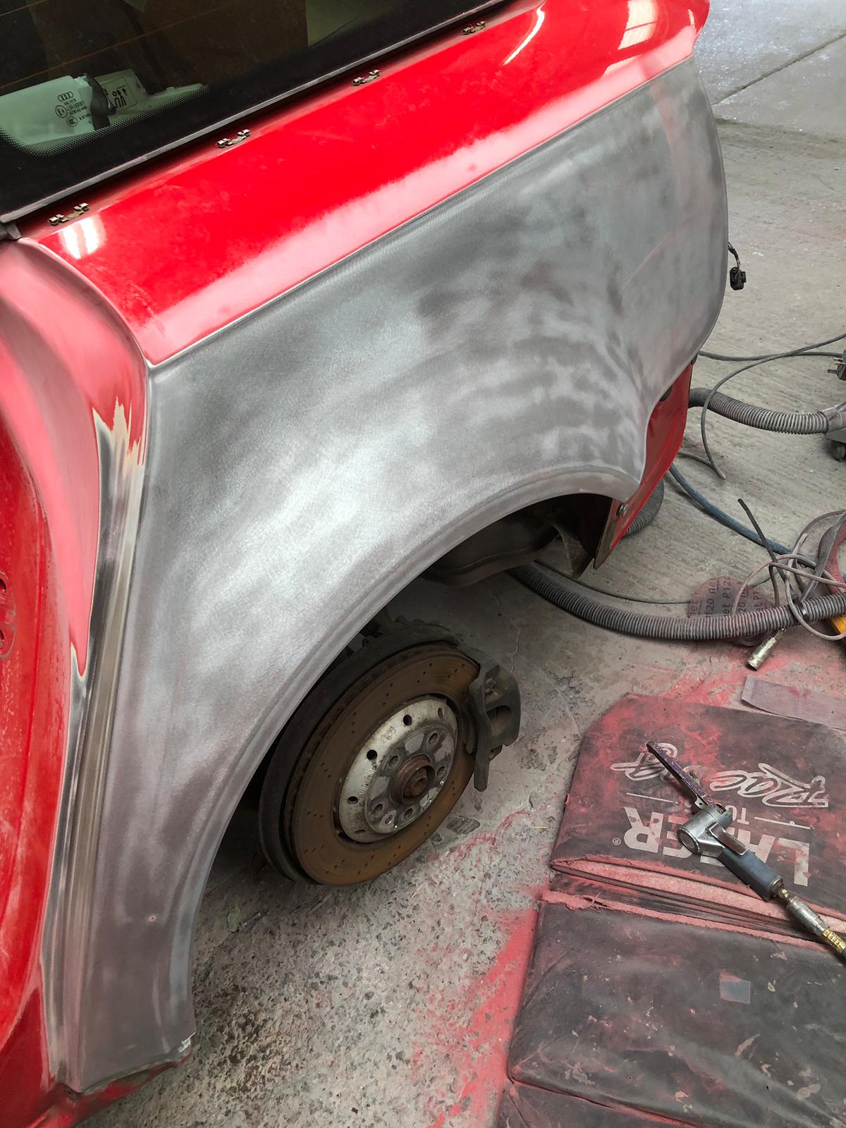

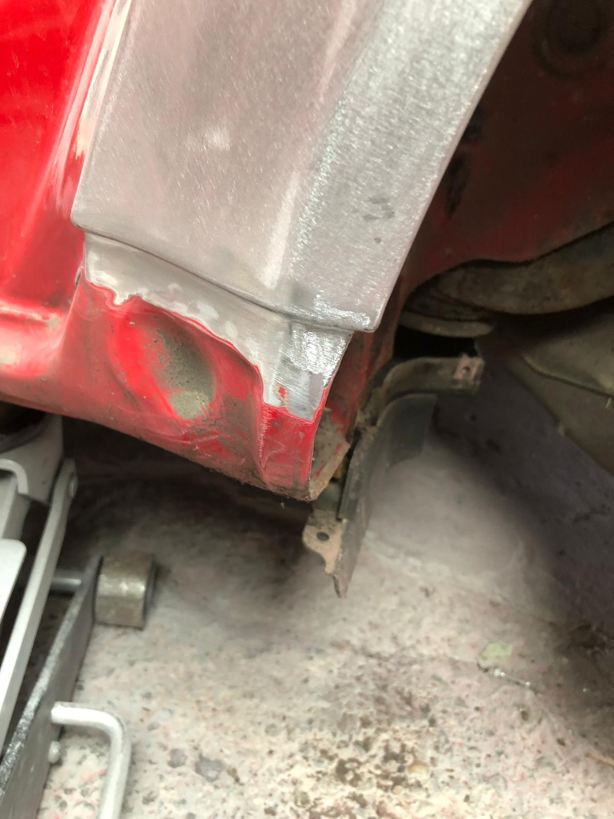

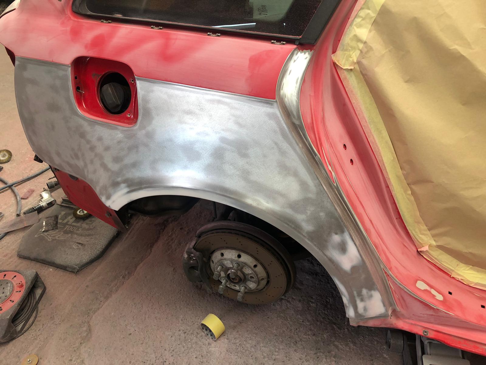

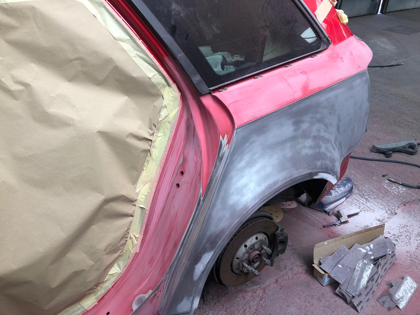

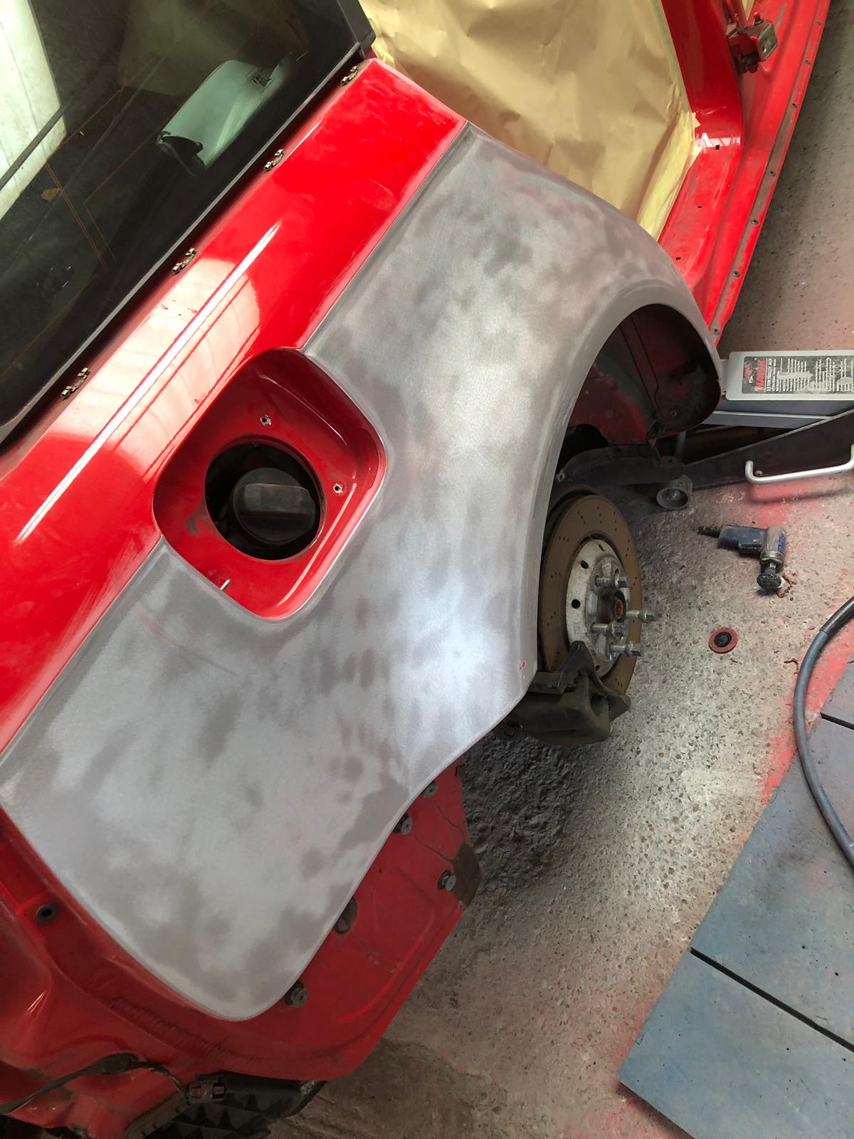

Once the car was dropped off at the body Shop it was a couple of weeks before they got back in touch. This was fine with me because we had agreed to let them work at a steady pace, fitting my car in around other jobs that they had on. Plus I was saving a fortune in petrol driving the wife's Fiat 500....
The good news was once the rear arches were taken back to the metal, they were nowhere near as bad as we thought. The original rear quarters on both sides could be kept which saved on the need for any cutting and welding.
The bad news was that they pointed out that all four tyres were, to quote Hustler 'barely legal'. They were fine at the last MOT so I must have been driving the car harder then I thought over the previous few months.
So, the money saved on the rear quarter panels was redirected into a new set of Pilot Sport 4S's and a wheel refurbishment. Nothing exciting here, sticking with OEM silver as I think it works well with the silver roof rails and mirrors. I did consider swapping to Goodyear Eagle's but as I really liked the previous Michelin Supersport's, I decided to stick with the French rubber.
We then discussed what parts I would like to renew whilst the car was being stripped down for painting. Long story short, all the mouldings, kickplates, window surrounds and bits of trim I never knew existed were added to the list.
New wing mirror covers and the main front grille prices were ridiculous so these were to be refurbished instead of being replaced. The original windscreen had seen better days as well, so along with the rear window (which was heavily scratched by a previous owner) these were heading for the skip.
At least I will be able to see where I am going on a sunny day now!

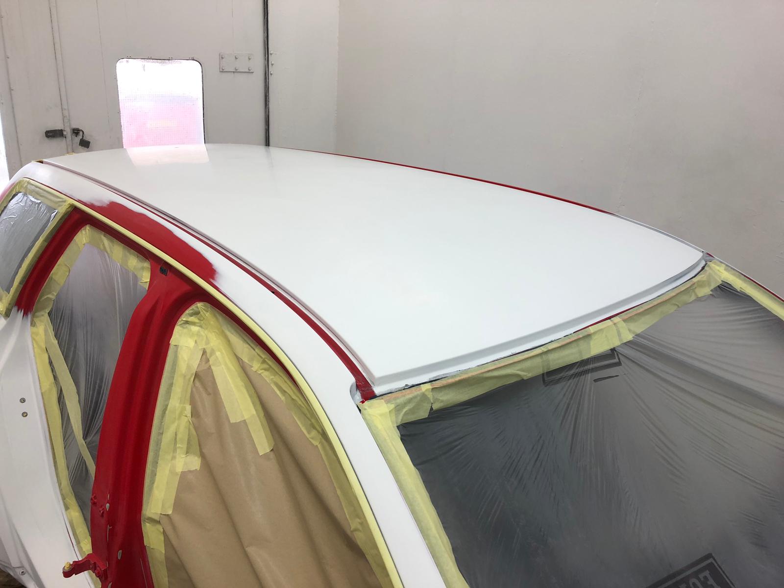

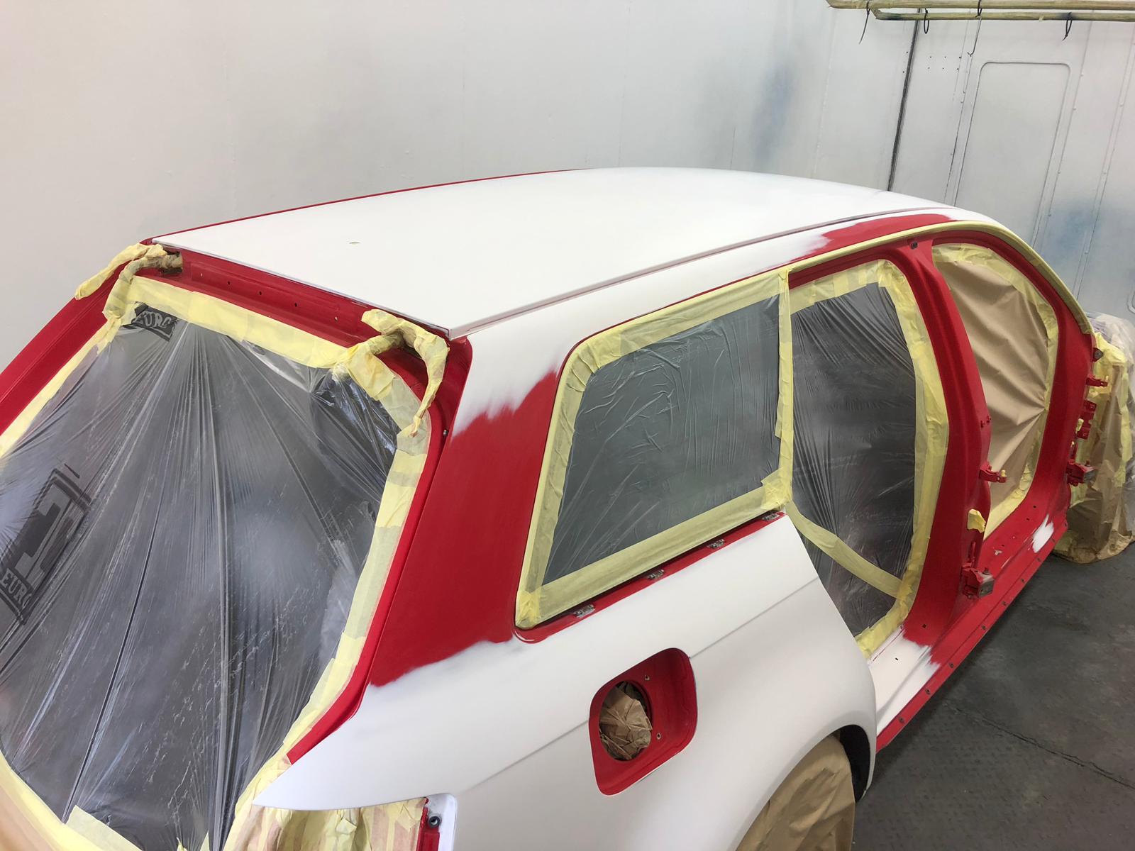

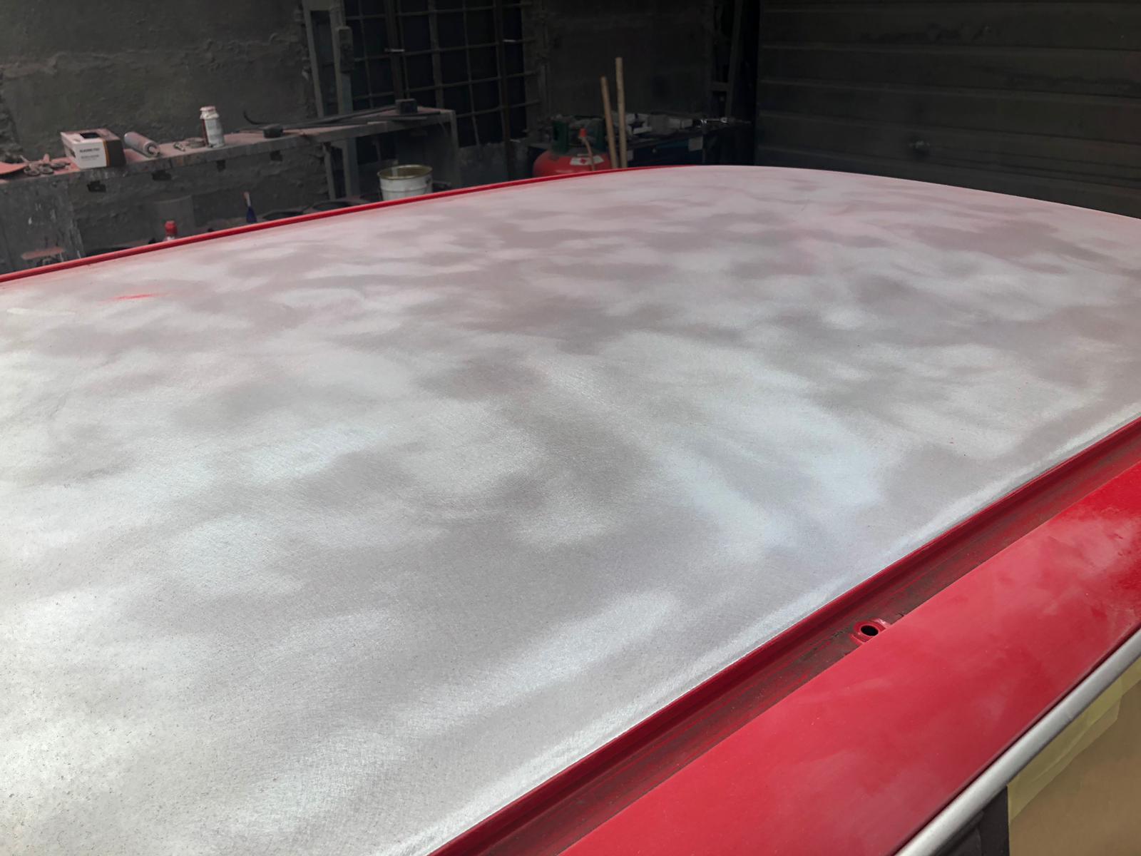

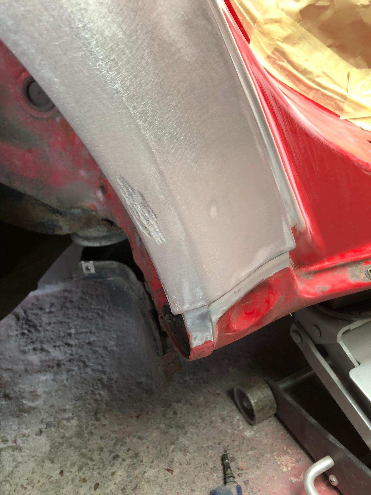

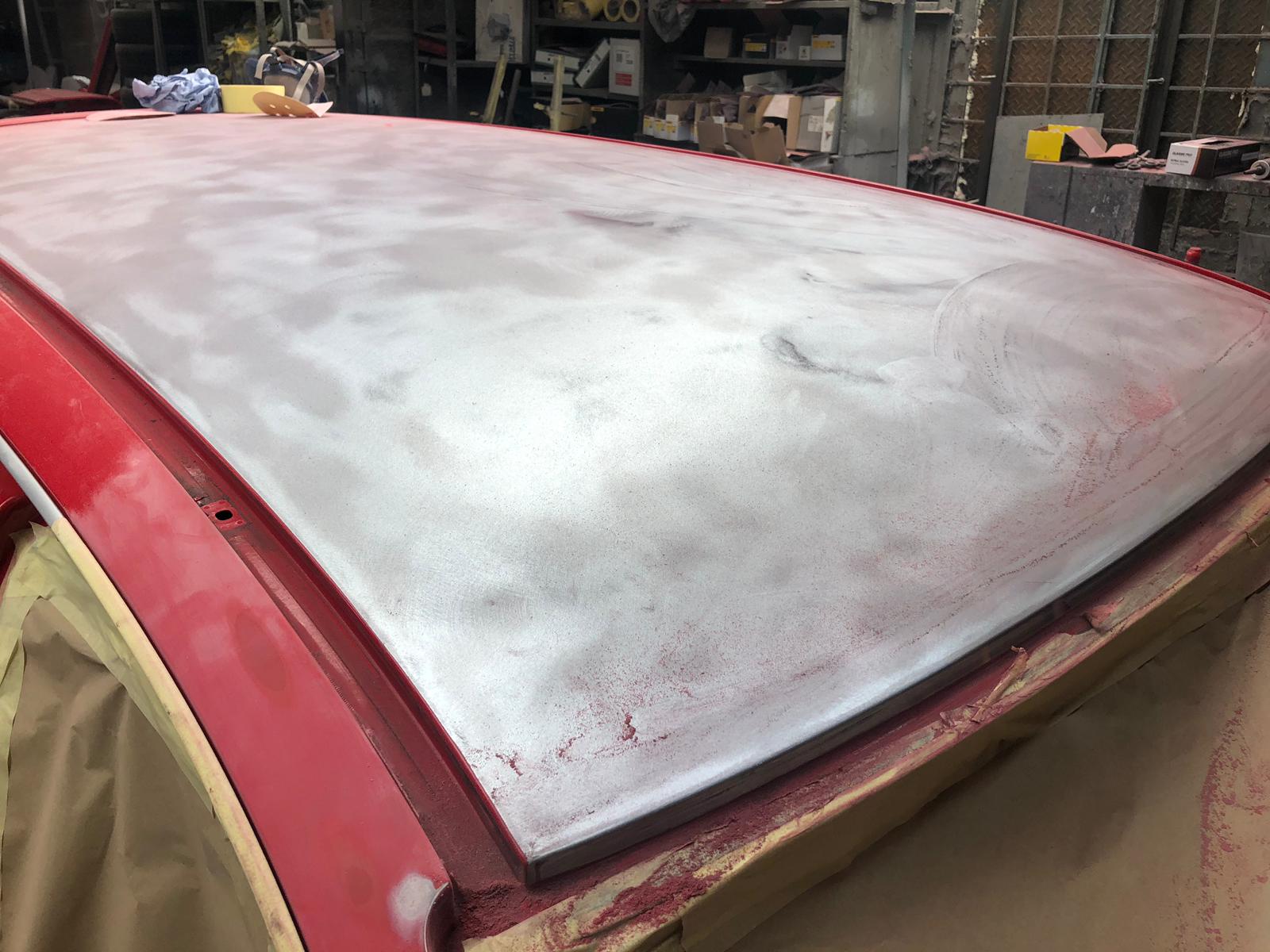

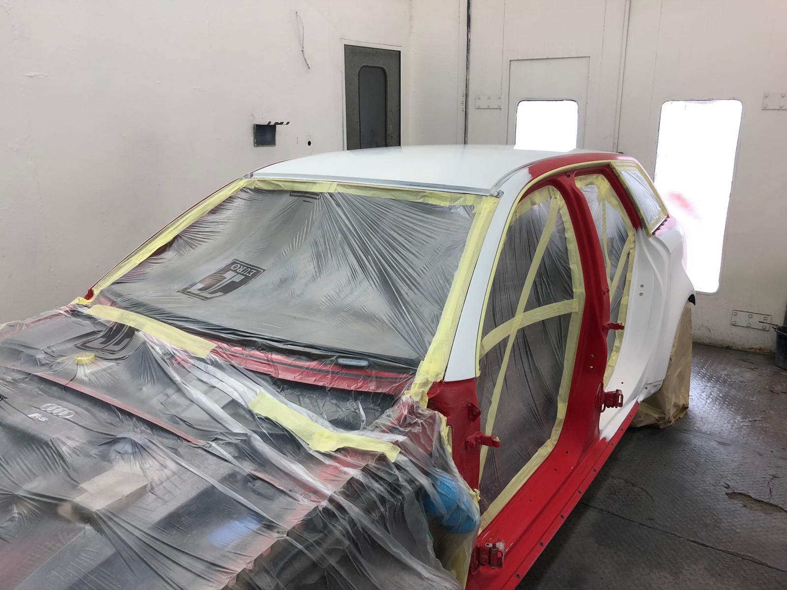

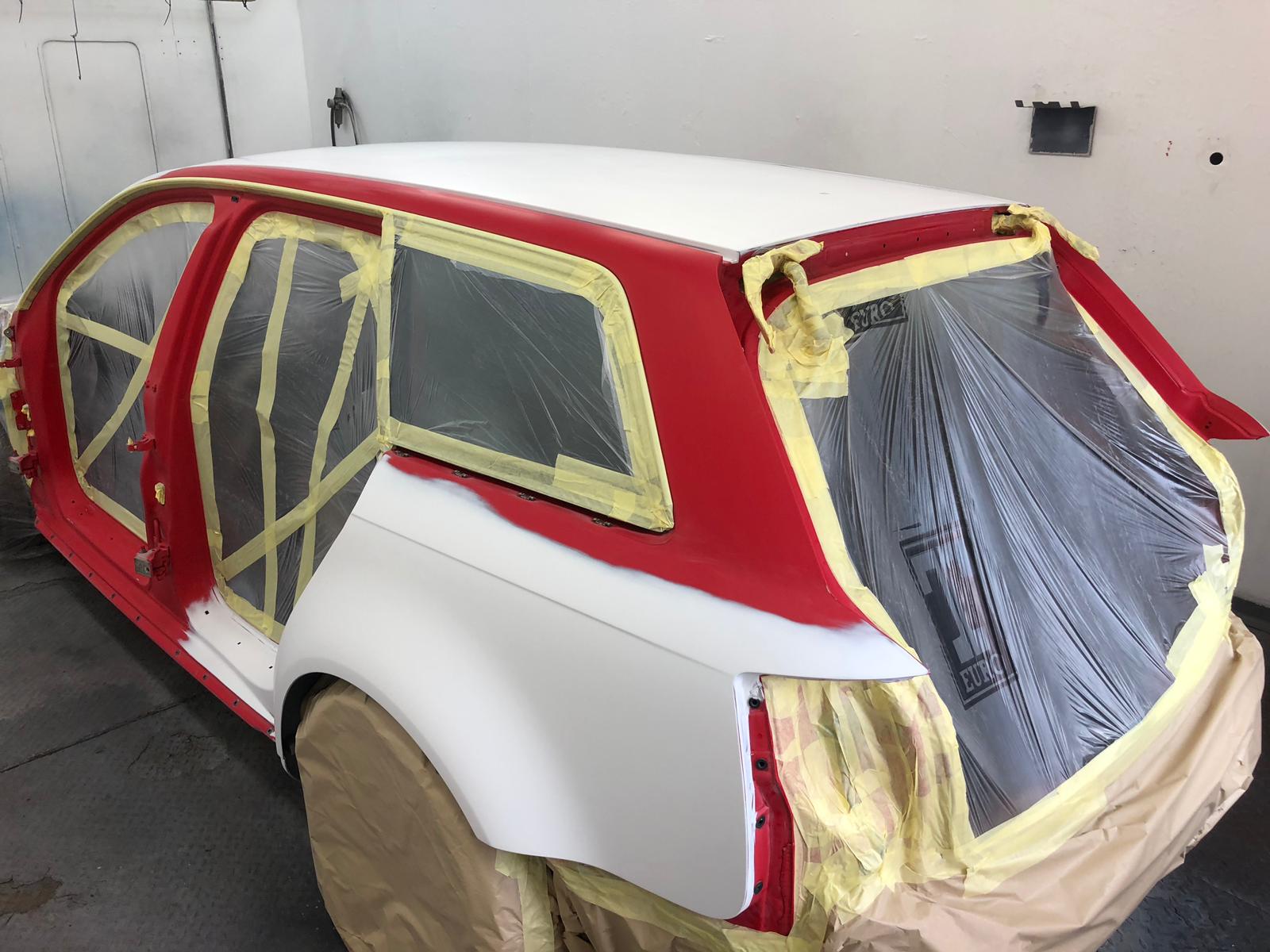

In order to paint the roof, the headlining and all the upper trims had to be taken out to allow the roof rails to be removed. Again, these are quite expensive new and as my pair were still in good condition, these were going to be cleaned up as required.
Some of the C and D pillar trims were torn (previous owner again), as was the centre rear trim right at the back. Probably would not be so noticable on a car with black headlining but as my one has silver, they stood out like a sore thumb. So decided to change them at the same time as it was all coming out anyway. I did think about changing all the headlining and trims to black but that would have added more cost to the project.
These cars are 13 years old now, it is already becoming more difficult to source some specific RS4 parts new from Audi. I had a broken piece of plastic trim that covers the tailgate mounting bolts, now discontinued so these had to be sourced on ebay. These were not a unique part to the RS4 so luckily a pair were found brand new still in the box on ebay.
Anyway, paintwork preparation was really starting to take shape.

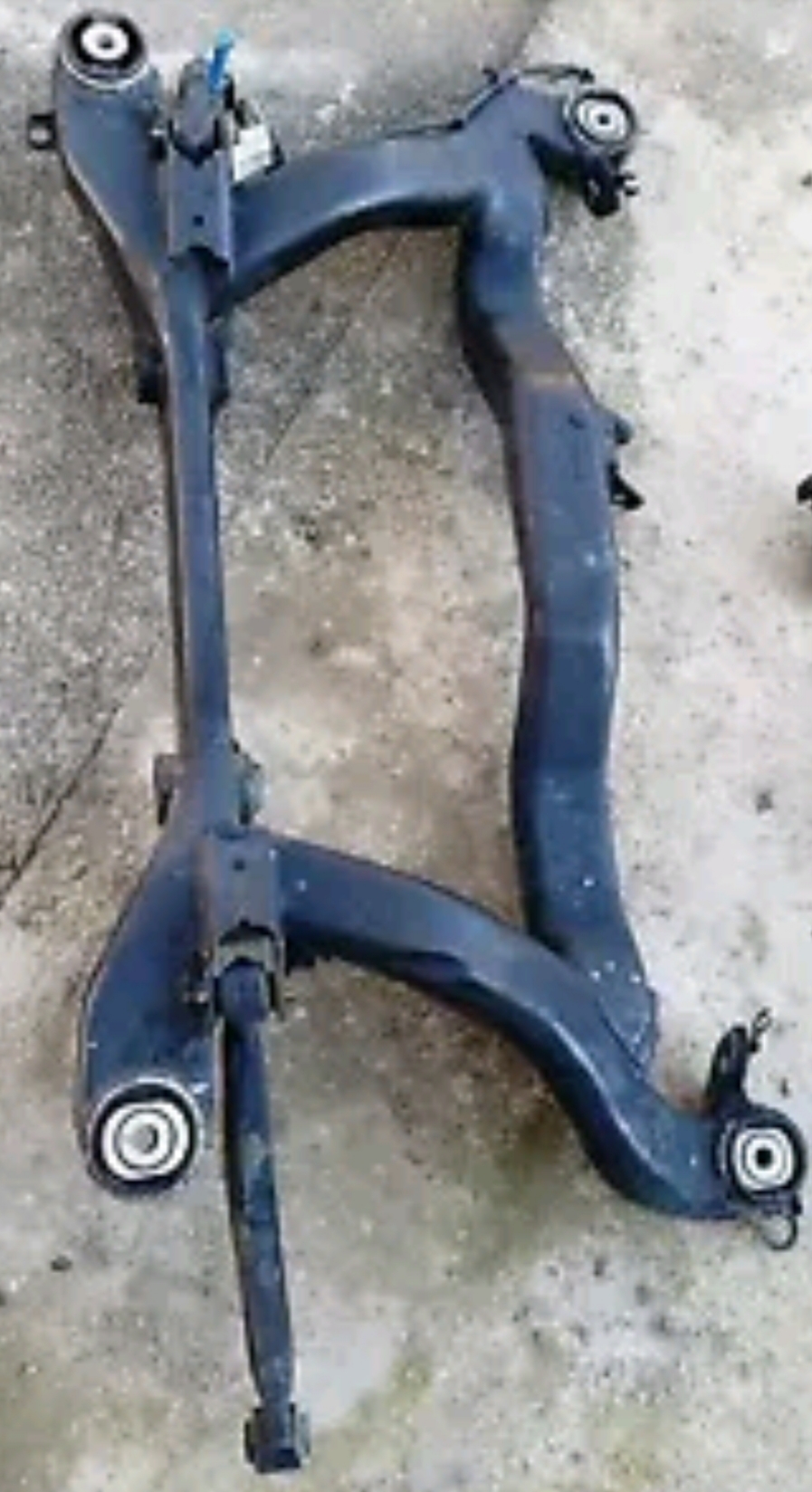

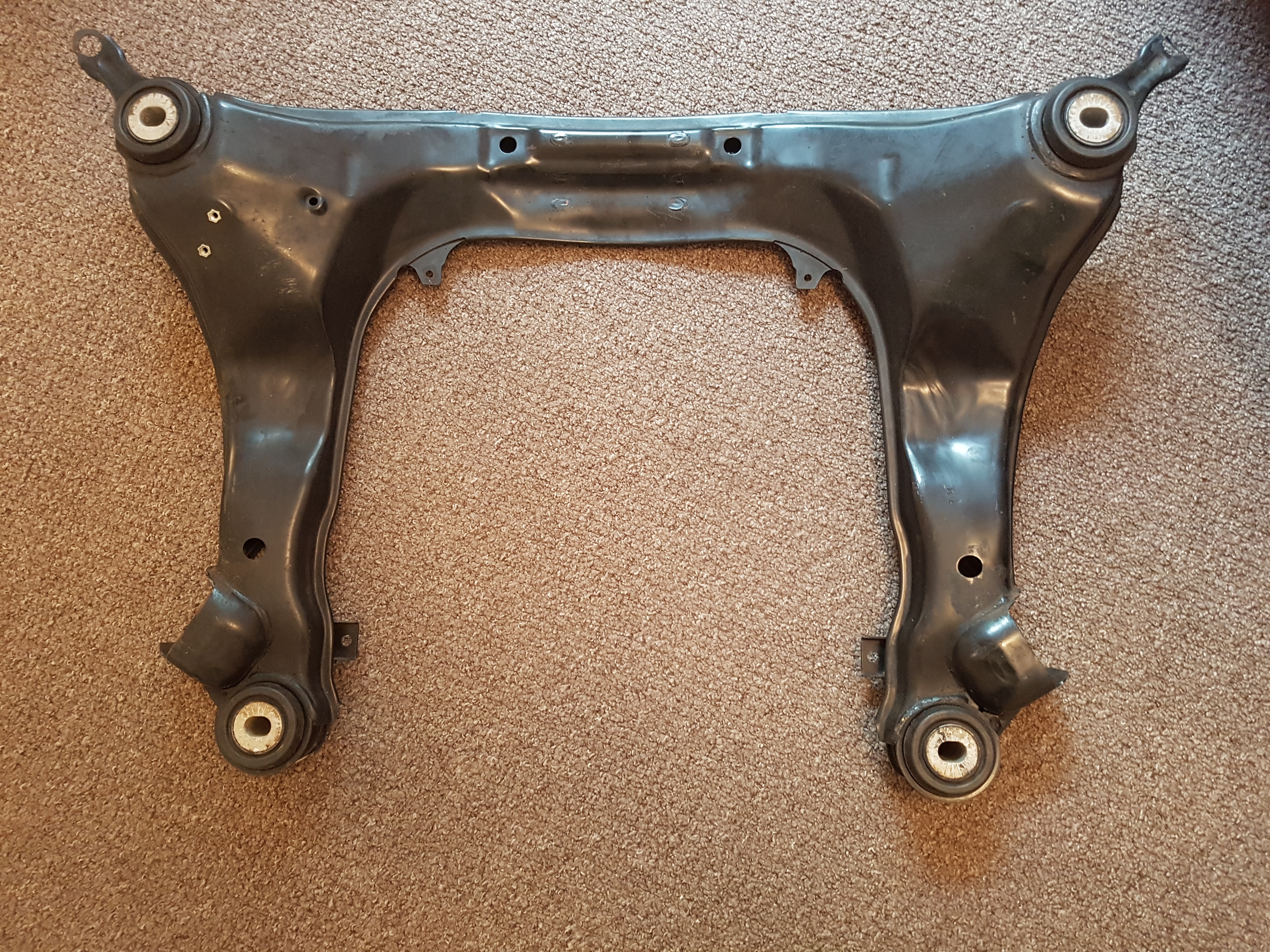

Seeing as my rear subframe was flagged up as needing work in a year or so I decided to look into sourcing a new one or getting the existing one powdercoated.
Well, has anybody looked at the cost of a new subframe?!!! £1105+vat!!! I can see why people get their current one powdercoated!
The only problem with that is, it can take a week for the freshly finished item to return from being refinished. Fine if you have a spare lift to keep the car on but most specialists are busy....
There were a couple on ebay but to be honest, they looked in the same condition as the one on the car. In the end I ended up buying a used one from the South of France as due to them not gritting the roads down there, it looked almost new. Granted, the postage was almost the same again for what I paid for it but it does have the control arms still on it. Much cheaper than the price of a new one even taking into account powdercoating and price of the new subframe bushings.
I did consider installing the solid 034 subframe mounts but given the car is for road use, I will be sticking with the stock OEM parts to maintain ride quality.
Without actually checking the state of the front subframe (the car was at the body Shop) I would assume that it would be in a similar condition to the rear one, perhaps a little better as hidden by the undertray but it would likely need attention as well.
This time I got lucky, one listed on ebay for £150 and removed from a car that had only done 1500 miles. The price of these brand new is even more expensive than the rear ones!
