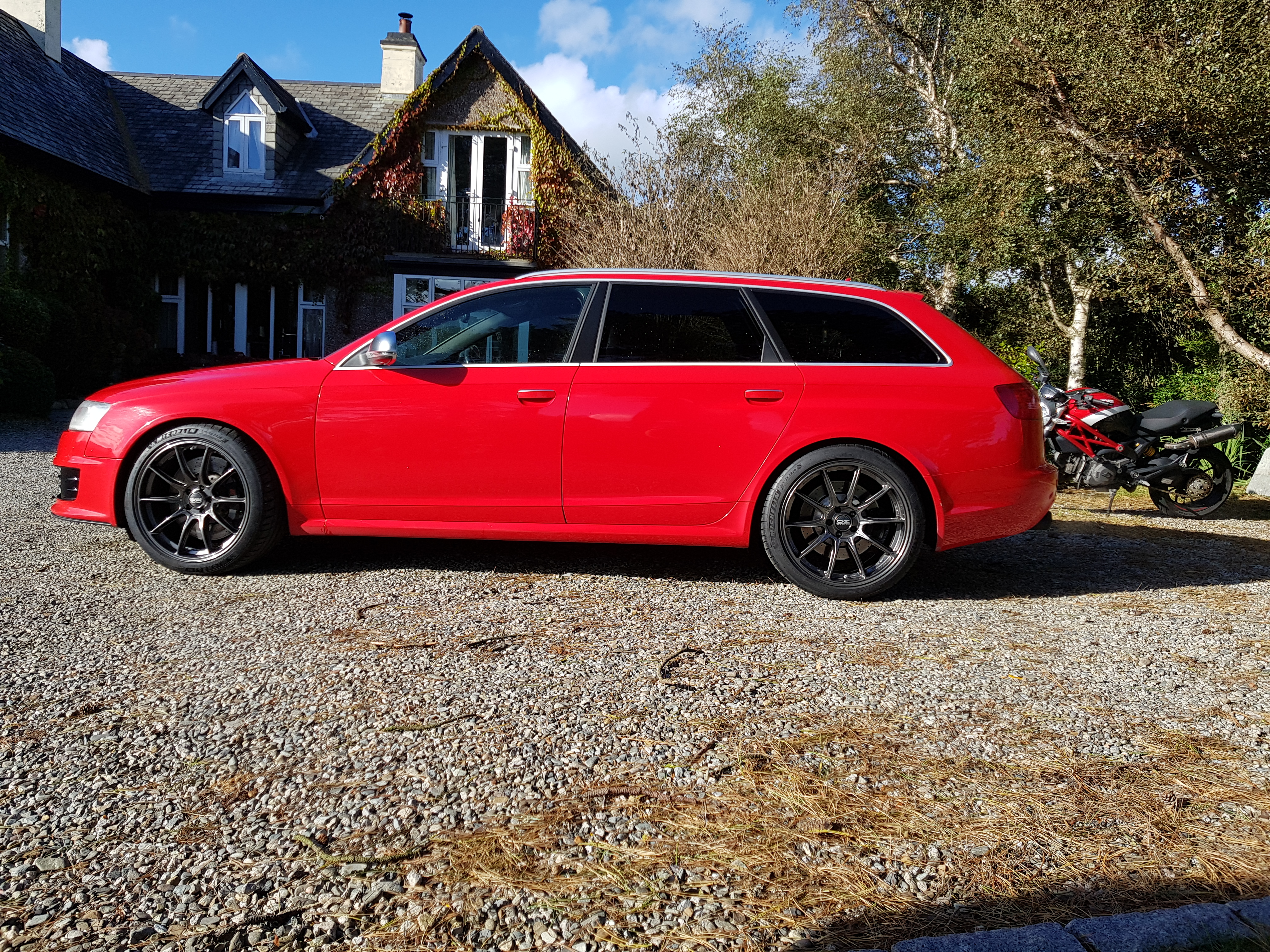

For 20 X 10 your ideal ET will be around 30-33, I think 42 will sit too far in the arch and possibly clip the strut
That's a set of 20x10 et32 with 275/35/20 Michelin, for whatever reason the tyres look bigger than the OEM tyres, but the wheels do look a little small, I'm happy with them though
Re: Aftermarket wheels size?
I'd need to run a spacer or order a different et. I've seen et28 available which should sit nicely
Yes 28 would sit well, there's still a bit of room for mine to come out. I'd personally rather order the correct fitment than run spacers on any car nevermind one this heavy/performance oriented. Hopefully you find what you're after!

im using Japan Racing wheels as my summer set. They seem to look larger than some other 20" wheels.
Audi RS6 V10 Avant
They look very similar to some of the wheels I'm looking at. How much is your car lowered?

Silver makes them pop, and that design the spokes meet the tyre were if you look at mine the lip which meets the tyre and the end of the spoke are a few mm apart giving the illusion they're smallerBadassgermanlook wrote: ↑Wed Feb 06, 2019 3:38 pmim using Japan Racing wheels as my summer set. They seem to look larger than some other 20" wheels.

I find them a great tyre, people have said there not the best in the wet but to be honest I don't drive the car at the limit in the wet. In the dry they are great and a very nice looking tyre. What also makes the wheels look larger is I'm using a 30 profile tyre.
