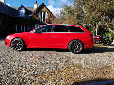

Post by Stiggles » Wed Feb 06, 2019 4:53 am
For 20 X 10 your ideal ET will be around 30-33, I think 42 will sit too far in the arch and possibly clip the strut
That's a set of 20x10 et32 with 275/35/20 Michelin, for whatever reason the tyres look bigger than the OEM tyres, but the wheels do look a little small, I'm happy with them though

Post by Doug_RS6 » Wed Feb 06, 2019 10:10 am
I'd need to run a spacer or order a different et. I've seen et28 available which should sit nicely

Re: Aftermarket wheels size?
Post by Stiggles » Wed Feb 06, 2019 1:38 pm
Yes 28 would sit well, there's still a bit of room for mine to come out. I'd personally rather order the correct fitment than run spacers on any car nevermind one this heavy/performance oriented. Hopefully you find what you're after!

Post by Stiggles » Wed Feb 06, 2019 6:50 pm
Badassgermanlook wrote:
Wed Feb 06, 2019 3:38 pm
im using Japan Racing wheels as my summer set. They seem to look larger than some other 20" wheels.
Silver makes them pop, and that design the spokes meet the tyre were if you look at mine the lip which meets the tyre and the end of the spoke are a few mm apart giving the illusion they're smaller
