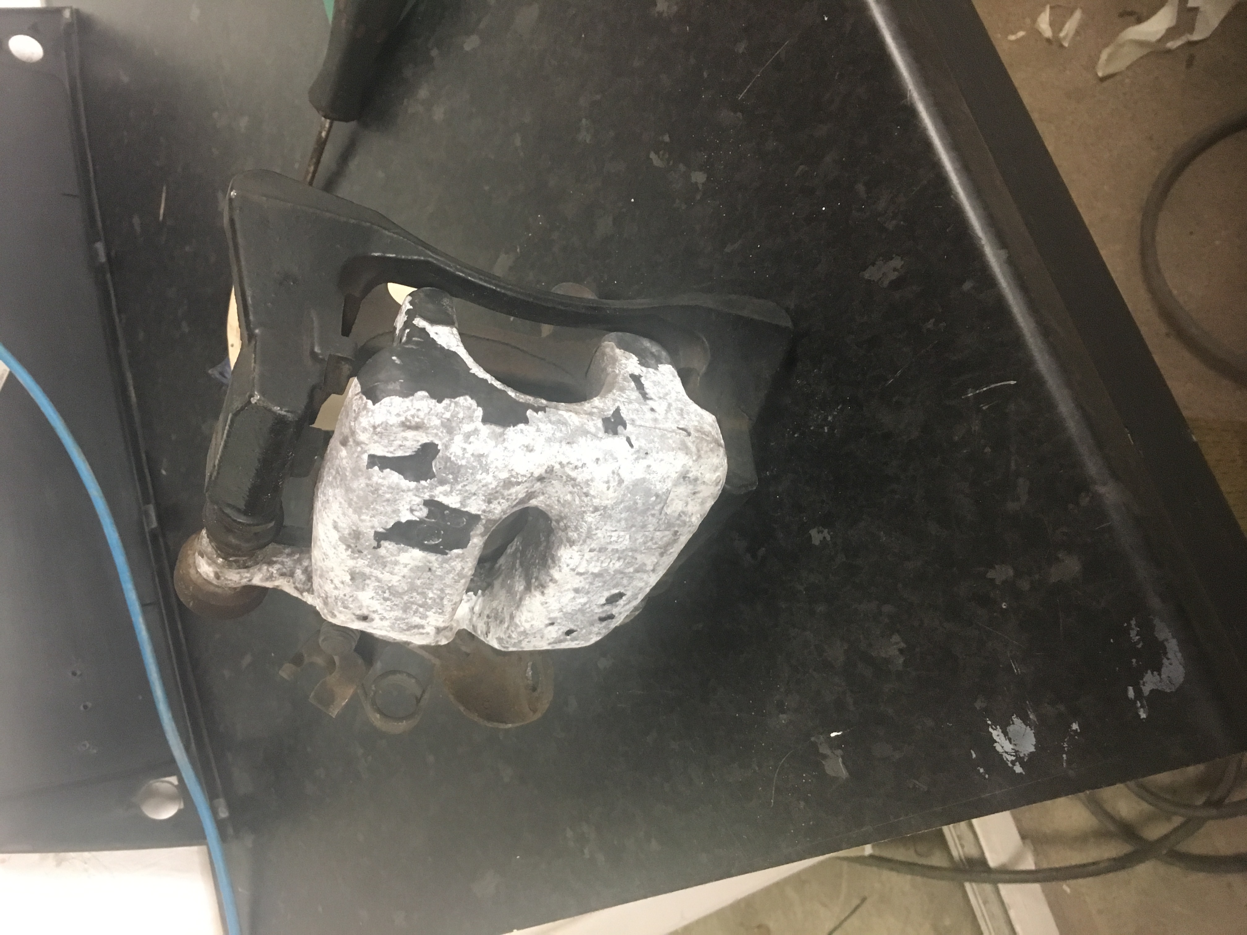

As I knew I was going to refurb the calipers I started to remove them which took no time at all, until I came to remove the rear caliper carriers, f**k me they are tight! Not something I want to do again as they were so tight I broke a ratchet.

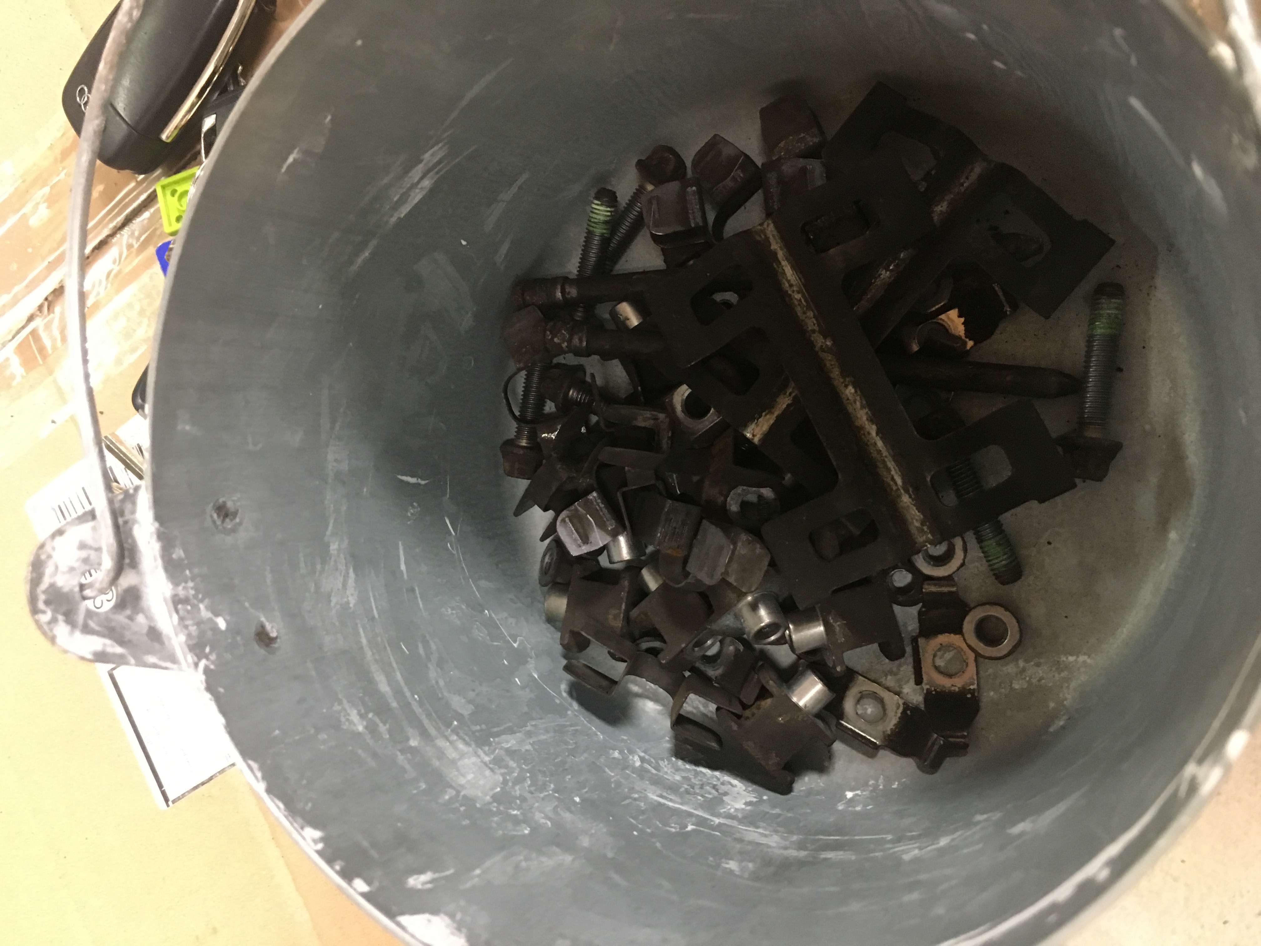

I stripped the front discs down to clean all of the bobbins, nuts and bolts and threw them into a bucket of bilt hamber detox c overnight to shift any of the rust and I must say it's quite impressive stuff, has saved me quite a bit of time so far and I also did the brackets and pad pins/springs.

They didny look too bad until i had a poke at them and the powdercoat fell off in big chunks.
Same as mine when I was fitting the'RS4' plates .Big clumps started peeling off .

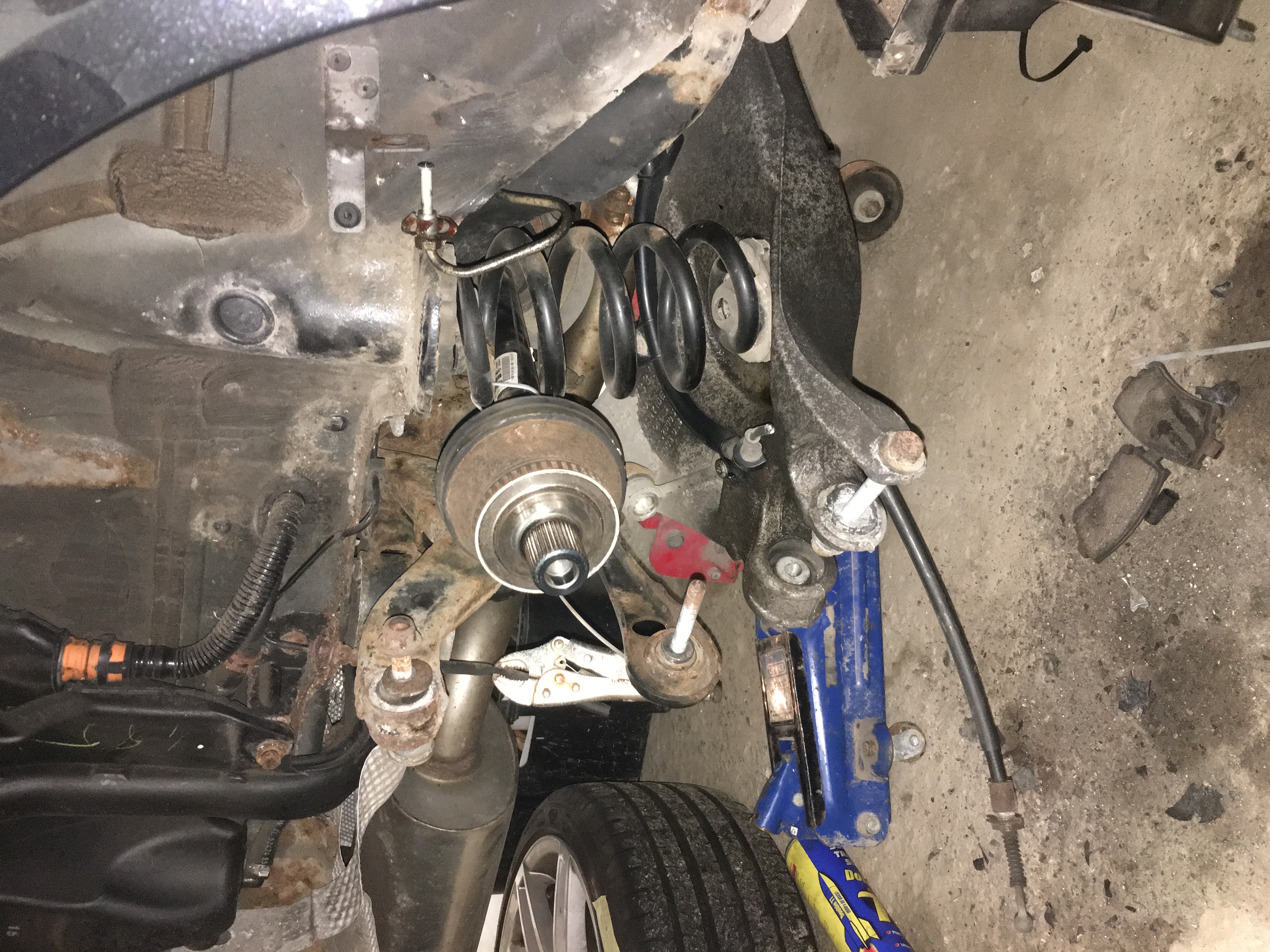

While removing the rear carriers I noticed a few bushes had begun to crack, so with the car being eleven years old I decided that in the long run it was going to be easier to drop the back subframe and have all the steel parts powder coated and new bushes all round, although more costly and time consuming it should be cheaper than replacing bits here and there especially when it comes to single use bolts and alignment, the subframe will be mounted with 034 Motorsport solid bushings.
Also for the price of 1.5 hours labour (£70) I bought a bush removal kit, if it gets some of the bushes out then I'm laughing, I think inserting the bushes is where it may triumph though as they could be rusted in.
Unfortunately while I was removing parts on the rear end I found a broken rear spring and after much deliberation I decided it would be best to replace the DRC entirely, I decided on bilstein b14 coilovers due to having them on a previous but after placing my order I was told that they were out of stock until January and I initially predicted to have it back on the road by now (this was early October) so a deal was struck and I am now the owner of a set of H&R coilovers.
And that's all I have to say about that, well the rear anyway :bash:

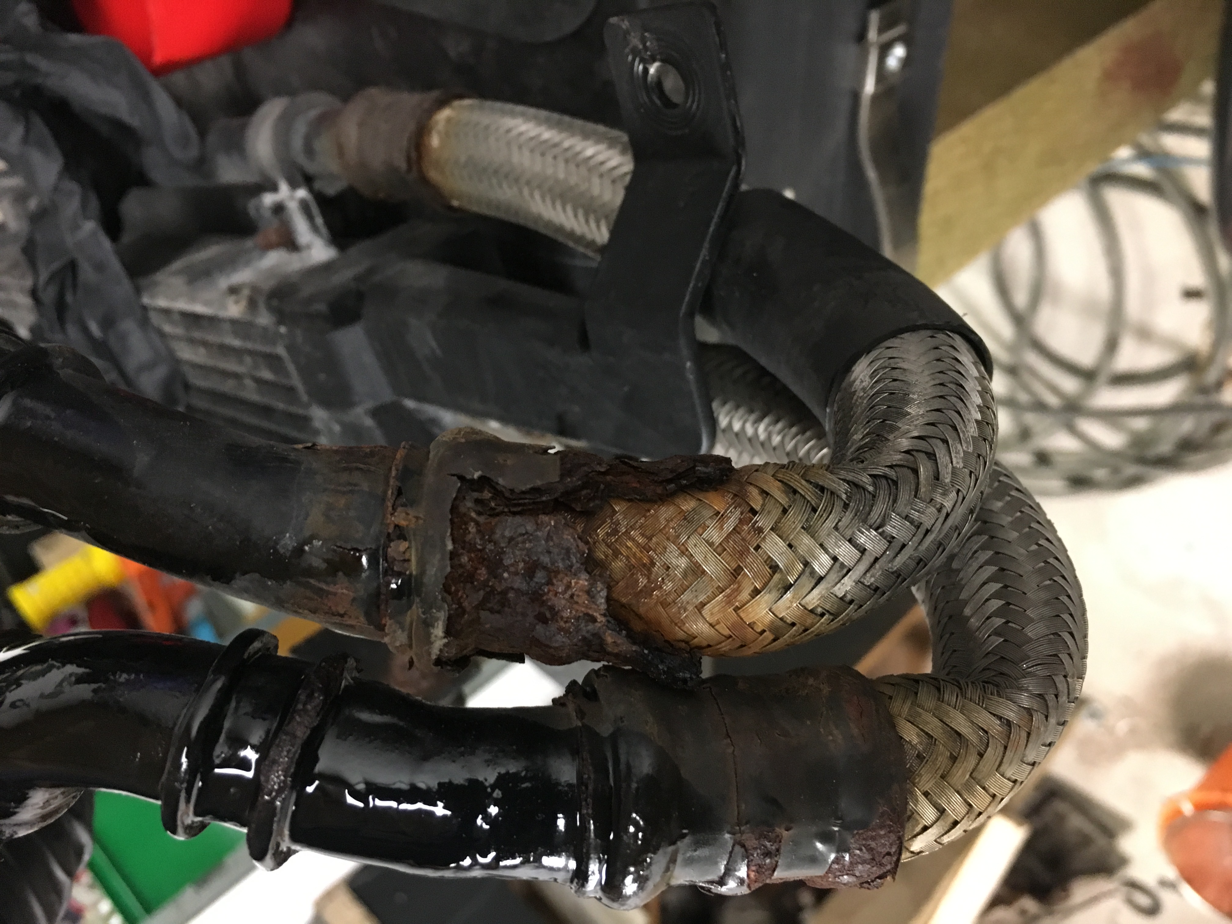

Moving on, I removed the front bumper to get to the headlights and sort a CAF out, the first thing I noticed was that the oil cooler was goosed, I tried to have it repaired and make my own lines but gave up and ordered a forge kit, it wasn't quite straight forward as the brackets didn't match the spacings of my original cooler by about 10mm or so but got there in the end.
The power steering cooler mounts had corroded out also, they are only a press fit aluminium bush so as soon as I tried to unscrew the bobbins they snapped out, these were repaired by carefully removing some fins and inserting a M6 c-clip and using a rubber bobbin 5mm longer, a nice cheap fix for once.
