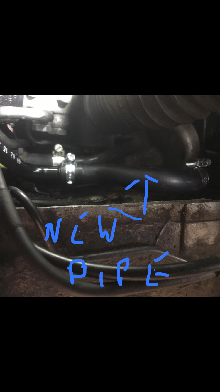

Noticed that my coolant pipes aren't looking too clever. Only under the bracket. Rest looks remarkably good. Is there anything really against cutting out the sections and putting rubber lines in? Don't suppose anyone has the diameters to hand?

Hi I have just done mine I can send you photos they are on here but I will repost them and if you need to speak to me pm me and I can send you my number if that helps you out thanks Steve

Post by Woodygo » Fri Oct 12, 2018 4:50 pm
Photos jobs a good one lol

Post by Doug_RS6 » Fri Oct 12, 2018 5:15 pm
That is excellent mate. Why did you remove such big sections though? On mine anyway it's litterally about 3 inches of each pipe needing replaced. So wasn't even going to bother giving Audi the parts money. Was just going to cut and replace the rotten part with rubber hose.
What diameter did you need to join the pipes? It's about £200 for the pipes isn't it?

Post by Doug_RS6 » Fri Oct 12, 2018 5:18 pm
Oh and what did you need to remove for access? One pipe is fairly easy to replace I gather?

Post by Woodygo » Fri Oct 12, 2018 5:57 pm
Trade is £171 and £41 plus vat

Post by Doug_RS6 » Fri Oct 12, 2018 5:59 pm
Thanks. What diameter of rubber hose did you use for them? I take it the £171 is the longer one that you cut?

Post by Woodygo » Fri Oct 12, 2018 6:32 pm
Yeah and cut it by where it go’ Under steering rack I have the rubber pipe I used in my other shed I will go and the size pipe I used to connect the two pipes together

Post by Doug_RS6 » Fri Oct 12, 2018 6:37 pm
Excellent mate. Appreciate that. Just so I can order the house now before I poke a hole in it.

Post by Woodygo » Fri Oct 12, 2018 6:39 pm
Inner 16mm

Post by Doug_RS6 » Fri Oct 12, 2018 6:49 pm
