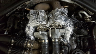

Maybe some more infra red temp data (keep in mind the ambient temps where 7°C lower then my previous log and i didn't pushed it that hard!).
Unshielded Shielded
Ambient air: 11°C 4°C
Oil temp: 102°C 94°C
Cats: 390°C 290°C (that one kinda gives away i didn't floored it tooooo much)
Manifolds: 300°C 80-90°C :) (the passengiers side is still half shielded and the unshielded side read 210°C)
Turbo: hotside 260°C / cold 90°C 146°C (fully shielded) 120°C (half shielded) cold side 60°C - 65°C
Intake tubes (heat wrapped): 75°C 70°C (again that side is atm still only half shielded)
Airfilter: 50°C 34°C (this time the filter and box had same temps)
Coolant reservoir: 80°C 68°C (again maybe indication i didn't floored it that much and lower ambient temps cooled things better)
Metal air-water charger: 55°C 60°C
Kinda shows it is hard to data log on different days etc, but kinda happy to see the fully shielded manifold kept a lot of heat inside as surface temps dropped by 1/3 (give and take as i didn't floored it that much). Just hope the hot side of turbo's can handle the insulation under load (as those turn boiling 'red') but the insulation can handle up to 982°C continuous/1204°C intermittent.

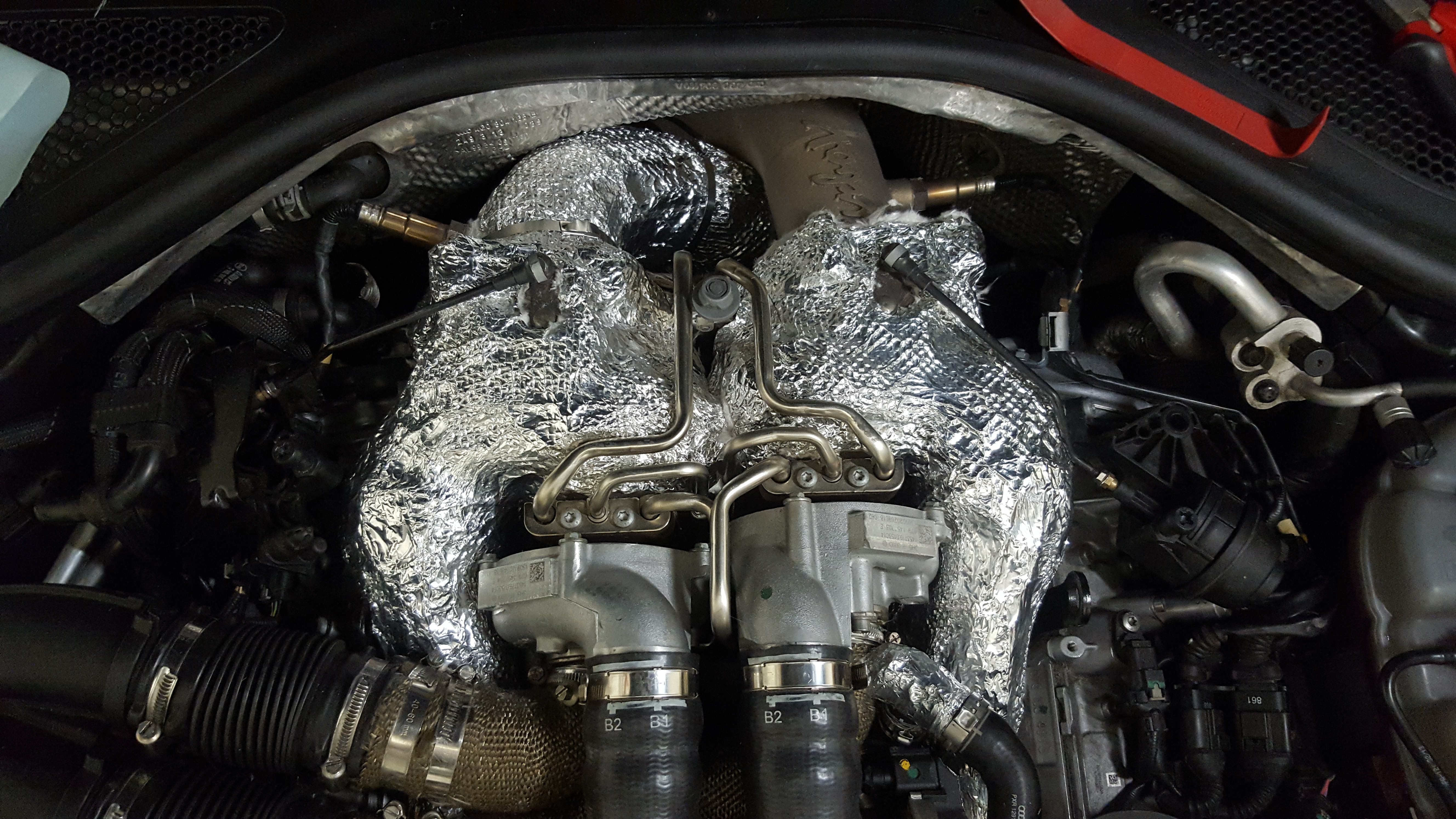

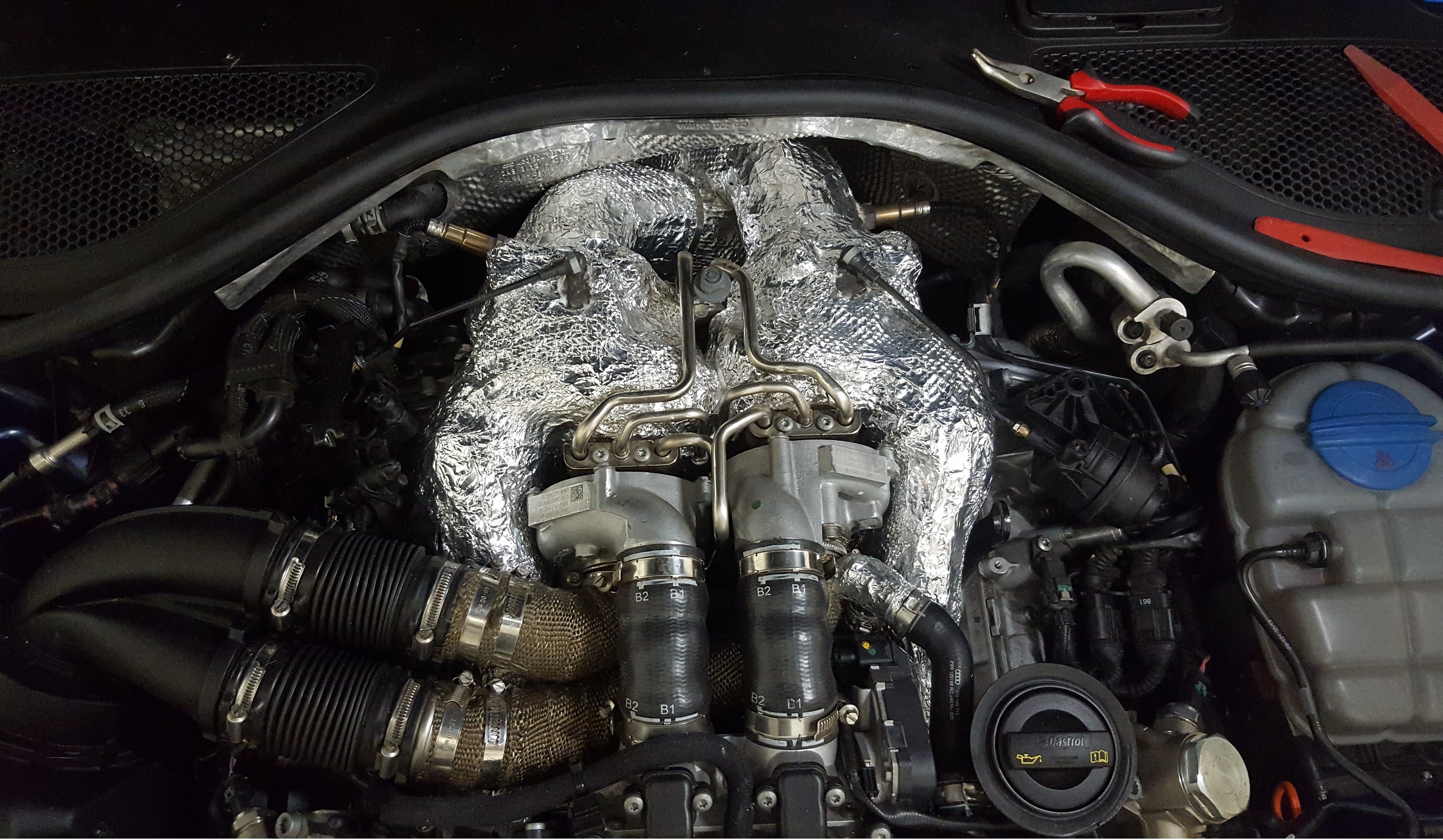

Meanwhile wrapped the passengier manifold and top side of the turbos. Not sure about the underside of the turbos...almost impossible to get by and bit worried if it aint a decent fitting and pressed against the surface it will create heat pockets and do more harm then it is worth.
All bit risky buisness (but in wirst case i'm in for turbo upgrade).
Next might be the downpipes....

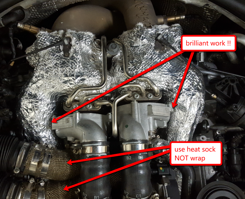

FANTASTIC JOB my friend, this will really work well once perfect, here are my points of view:
1) I don't think the heat sheild touching the turbo will matter, and is much better to be shielded and touching, than not shielded and not touching
2) you have used the wong stuff to wrap your turbo intakes, thats heat wrap to keep heat in NOT keep heat out, you need these for the intakes: http://www.ebay.co.uk/itm/172887065041

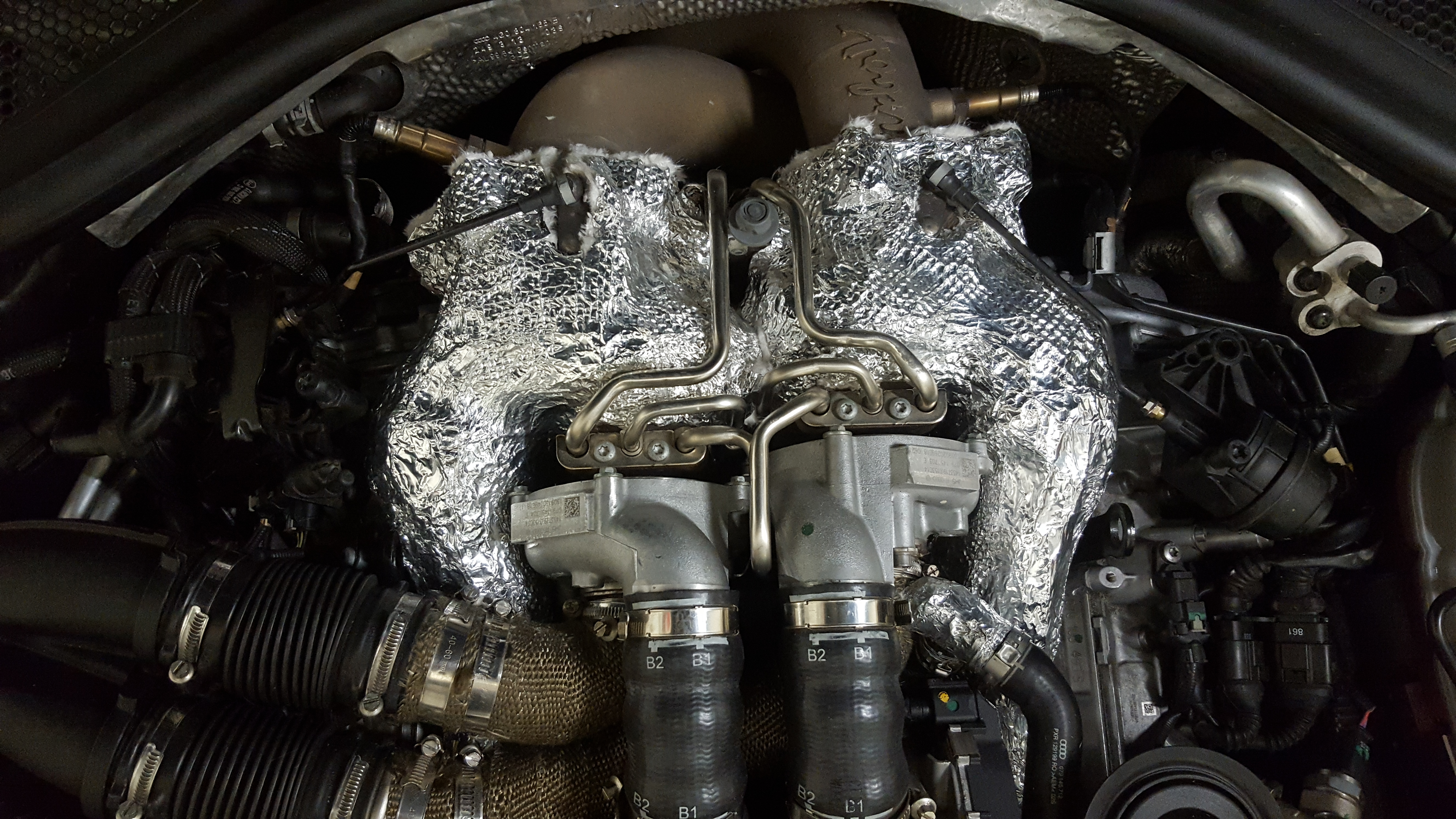

Cheers :)...hm that you mention, totally wrong material (lets heat through instead of blocking)!
Will remove it, leave stock or check for better material.
Meanwhile did one downpipe. Only +-30cm from trubo downwards, witch is the place were the tunnel starts to open up again and hopefully most heat finds its way outside...
Still gonna do the other downpipe and call it a night :).
Hopefully it was worth something...

Considering the manifolds/turbos/downpipes shielding a wrap :).
Sadely run out of material to cover the underside of the turbo's, not sure if that is a bad thing or not (will be difficult to do it anyway) but should be better then nothing i think?
