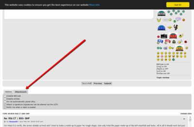

For what it is worth, the armor shields arrived and i tried to make a moke up in paper for rough shape. Atm only tried the paper moke up of the left manifold and turbo. All in all it should work but just bit affraid that especially on the inner side (V) i will not be able to press it down deep or close enough to the manifold and have gaps that might have a negative effect (heat trapped). Working in 2 halves for the manifolds should work, turbo is bit of a different ballpark, especially the underside, there i'm aswell worried i won't be able to get my hand deep enough to press everything around it without voids and pockets.
(hmm somehow i couldn't attach picture 'image invalid').
Not giving up yet, just giving it a second tought and ideally the sheets i have ordered are bit too narrow but could still use them for the inner manifolds, underside turbo and downpipes so no loss.

Yup i know and tried it, but when uploading i got a warning 'invalid'. Not sure if file size or name or type but it was .jpeg.
Anyway, not much to see beside the manifold and top turbo side wrapped in paper to get more or less my templates.
