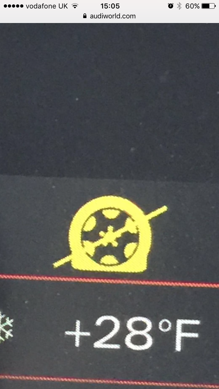

Just a quick one chaps has anyone ever had this light come on I assume it's a faulty sensor inside the tyre
I've tried resetting it all on the dash i.e. Wheel change
And store new pressures
But it keeps on coming back on ?
If it is one of the sensors how would I know which one to replace
Thanks in advance marc :thumbs:

Marc, it’s a real faff trying to find out which one is at fault.
The system is quite basic, so doesn't report where they're located on the car using VCDS, so you have to set the tyre pressures and log a base line. Then drop one tyre pressure down, go for a short drive and log the serial reporting the lower pressure. This will show you what sensor serial number you've dropped the pressure on in relation to wheel located on the car. Repeat this up to 3 more times to find out which sensor serial number is on which corner.
I couldn't be bothered with it all, as the sensors have a finite life of around 7 years and if yours are still the originals, then they've done extremely well to last until now. I just got 4 new sensors fitted and sorted it that way. Alternatively you can just code them out with VCDS and do away with the system entirely.

If there is a cross through the tyre symbol then it is a TPMS issue rather than a flat tyre. As others said VCDS can help here - mine did the same and all 4 tyres weren't reporting so I changed the antenna (which lives behind the back bumper) and this fixed it (very easy swap out) but you need VCDS to determine if is a TPMS sensor that has failed or the whole system.

I would hope for the antenna personally and I it seems these are reaching an age on our cars. The antenna is a really easy swap and I think was about 70 from Audi.
When I took mine apart it was wet and corroded inside so the seal must have given up.
