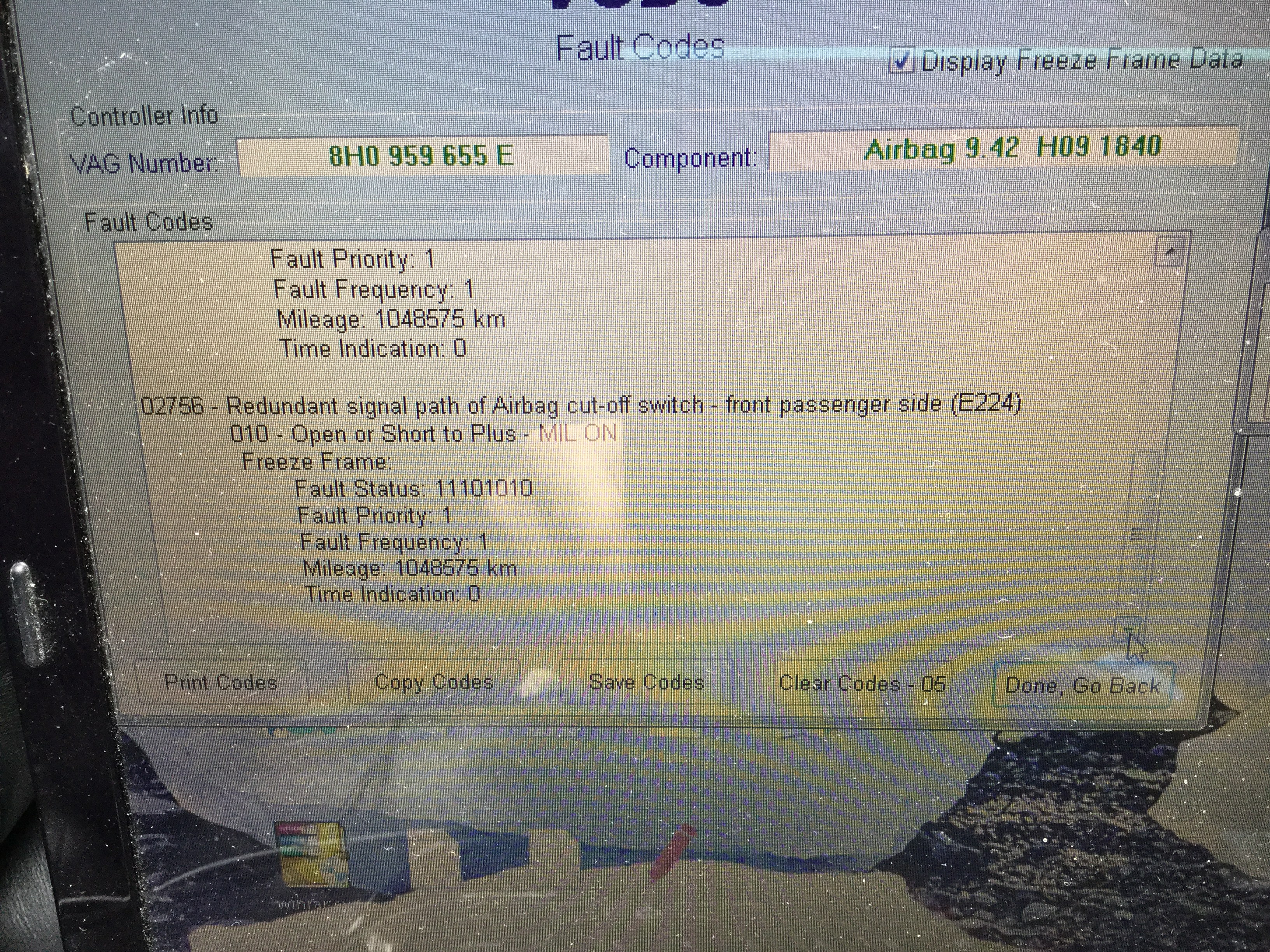

So I've changed the seats over but Noe I have both an ESP light and an airbag light on. The on board display says passenger airbag deactivated on start up as well.
Changing the coding as previously mentioned does not seem to make any difference. These faults are now shown
Battery was disconnected prior to removing seats . Found this relating to fault code shown All advice gratefully received!
Re: Coding for airbags on comfort seats
Looks like it's expecting to see an occupancy sensor. Did the other car have one?
