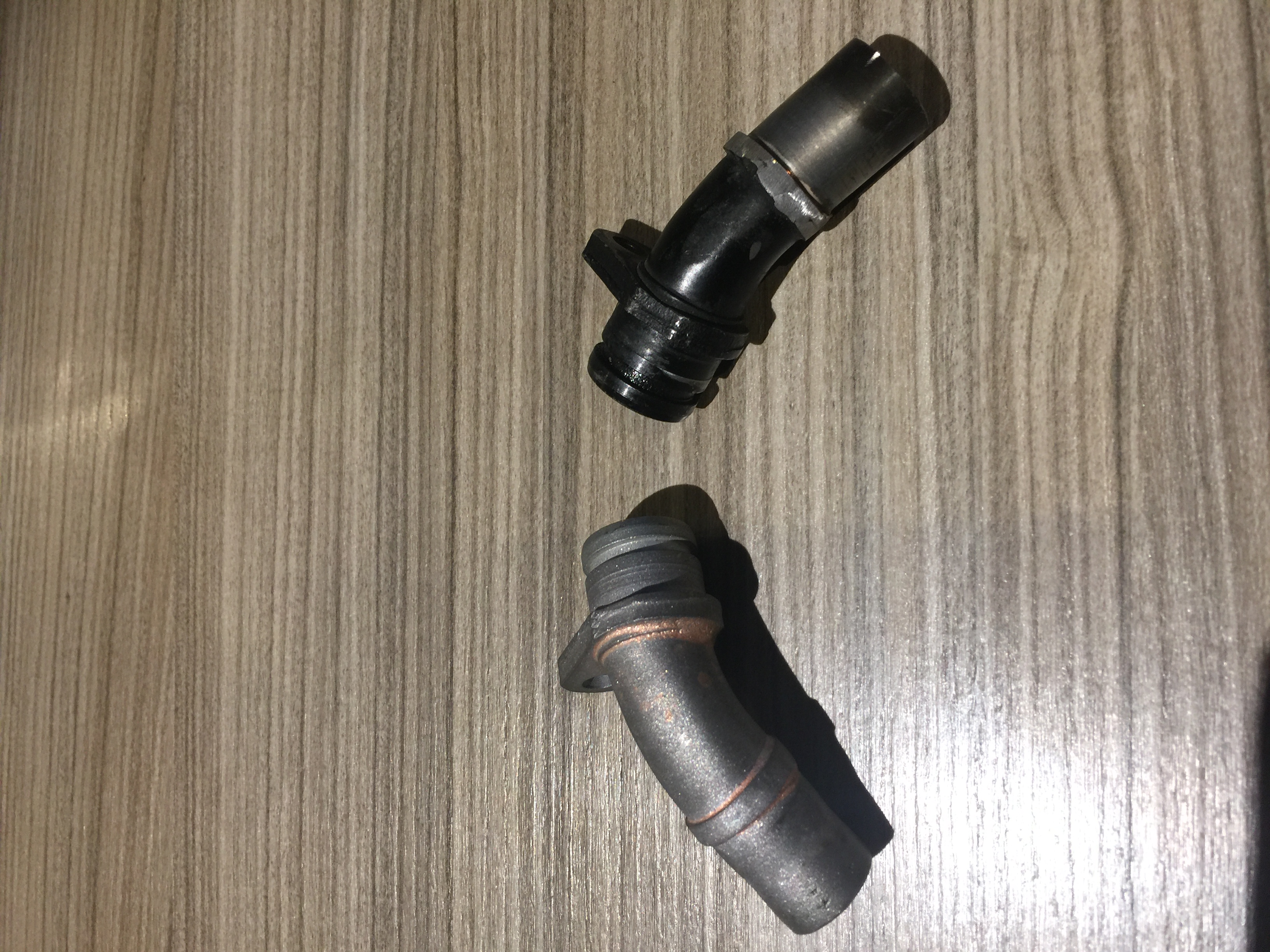

Lukes3
Posts: 657
Re: oil cooler fabrication
Post by Lukes3 » Tue Jan 16, 2018 2:33 pm
I made these out of the old pipes/fittings an now use 1/2” bsp allround.
