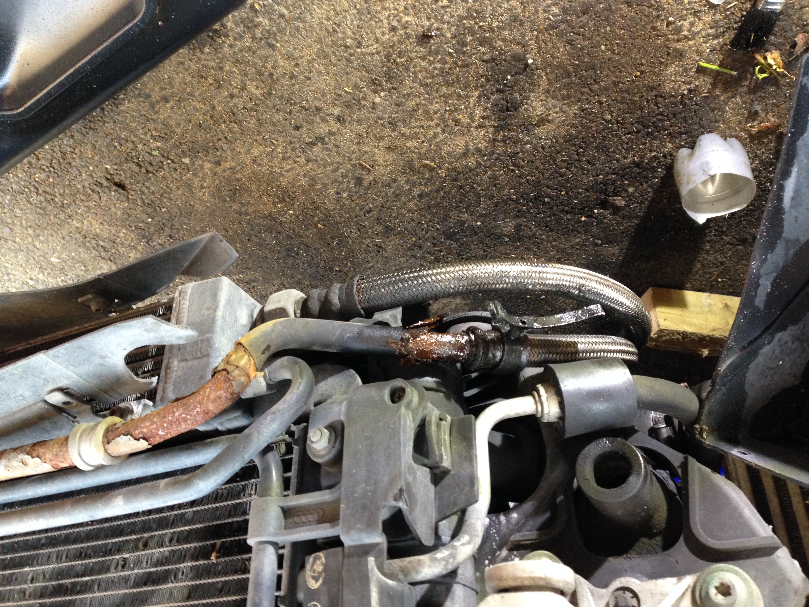

As Matt said, the dremel cutting approach does work - I have saved my oil cooler by cutting and then fitting OEM pipes straight back. Softly softly gets the monkey with this one.
Here was my oil pipe so you know what they are probably fixing!

It'll almost certainly be one of those 2 unions you can see in that pic that's leaking.
