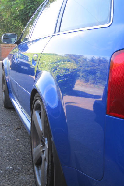

Well it appears that mine is refusing to be recoded,,,this was after my original unit was repaired , and then still refused to be talked to by the vag,
at the moment awaiting some other input from a higher source , will keep you informed , apart from the the car is stunning , forgot how quick it is,
