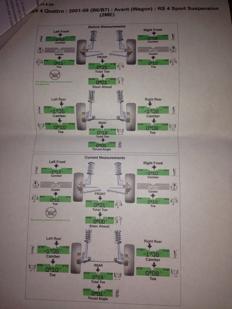

Had mine put on a Hunter machine the other week, everything was all in order so nothing needed changing. Not sure if this photo will help you or not:

Thanks ! I think we have similar specs (your camber is even more sporty ! :D ) so all looking good ! :beerchug: :beerchug: :beerchug:

The_Coat wrote:Had mine put on a Hunter machine the other week, everything was all in order so nothing needed changing. Not sure if this photo will help you or not:
The small numbers in the corner of each section tell you the ideal range.

Thanks for the info Mike, makes sense now.
Not really looked at the paperwork since I got it done, had the alloys re-done and new rubber so thought this would be handy to have. Only £6 as nothing needed doing.

I let the Hunter system pull the base settings for 2ME sports suspension - it seems just fine to me...
