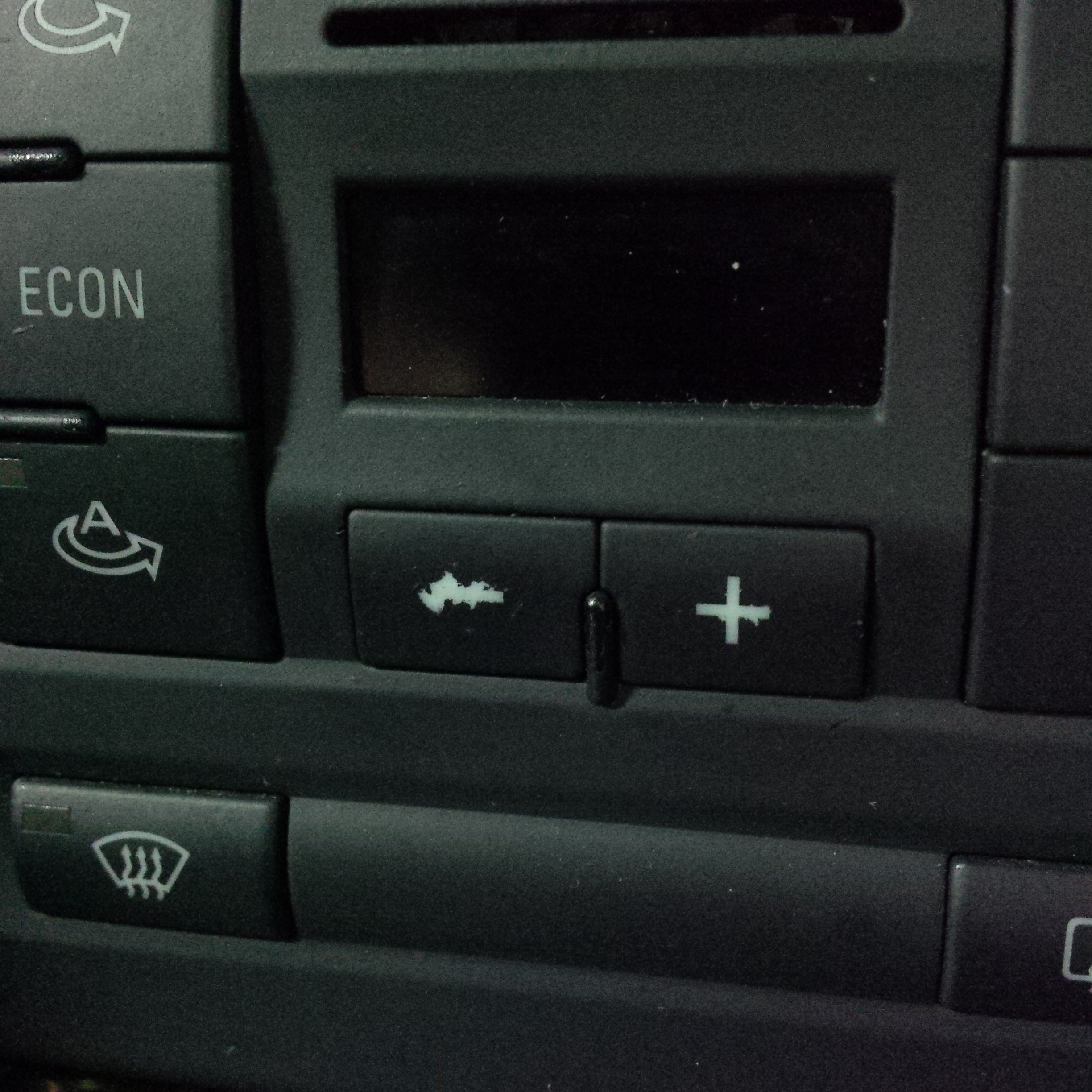

Using the internet resources I've pulled the head unit out and the climate control planel, you can notice the before condition. It's not bad but at the same time, annoying to look at:
before shot

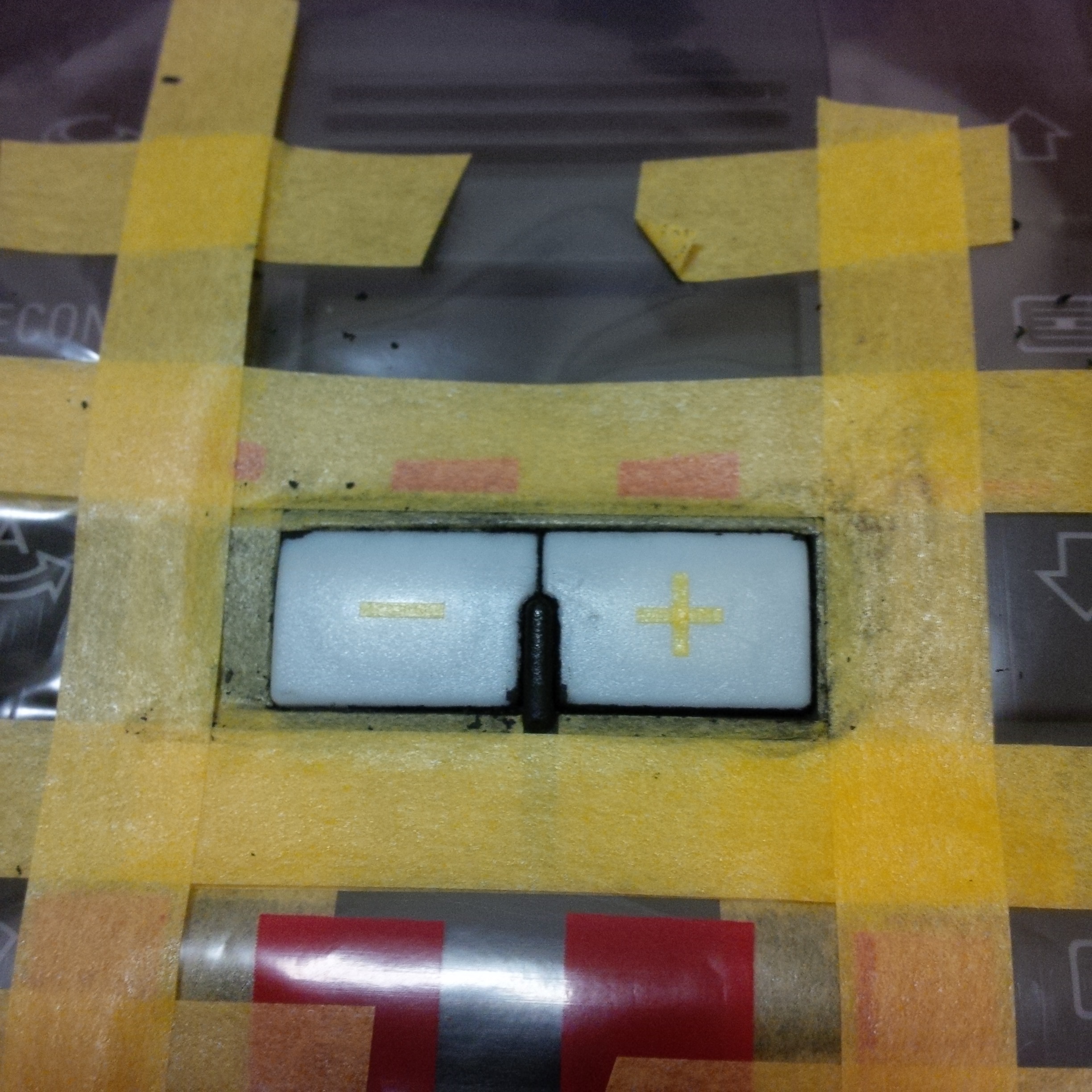

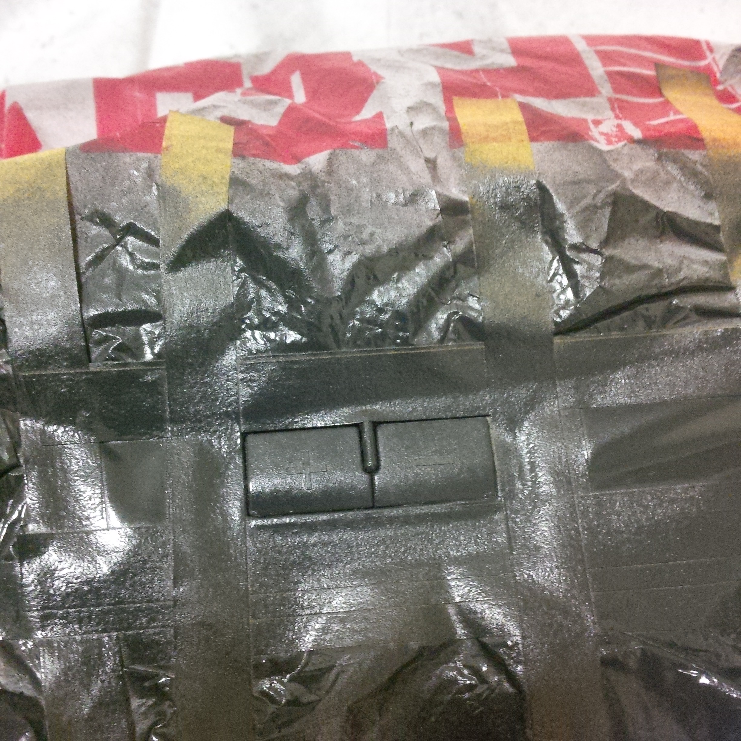

I originally planned to not strip the buttons so I just clean the paint off the buttons and masked off other areas. Another handy tip for the masking of the + and - is to buy, again, from the hobby shop, pre-cut masking tape normally for model cars. I used the 1mm wide version. This should also work for the +/- button on the steering:
masking of the buttons

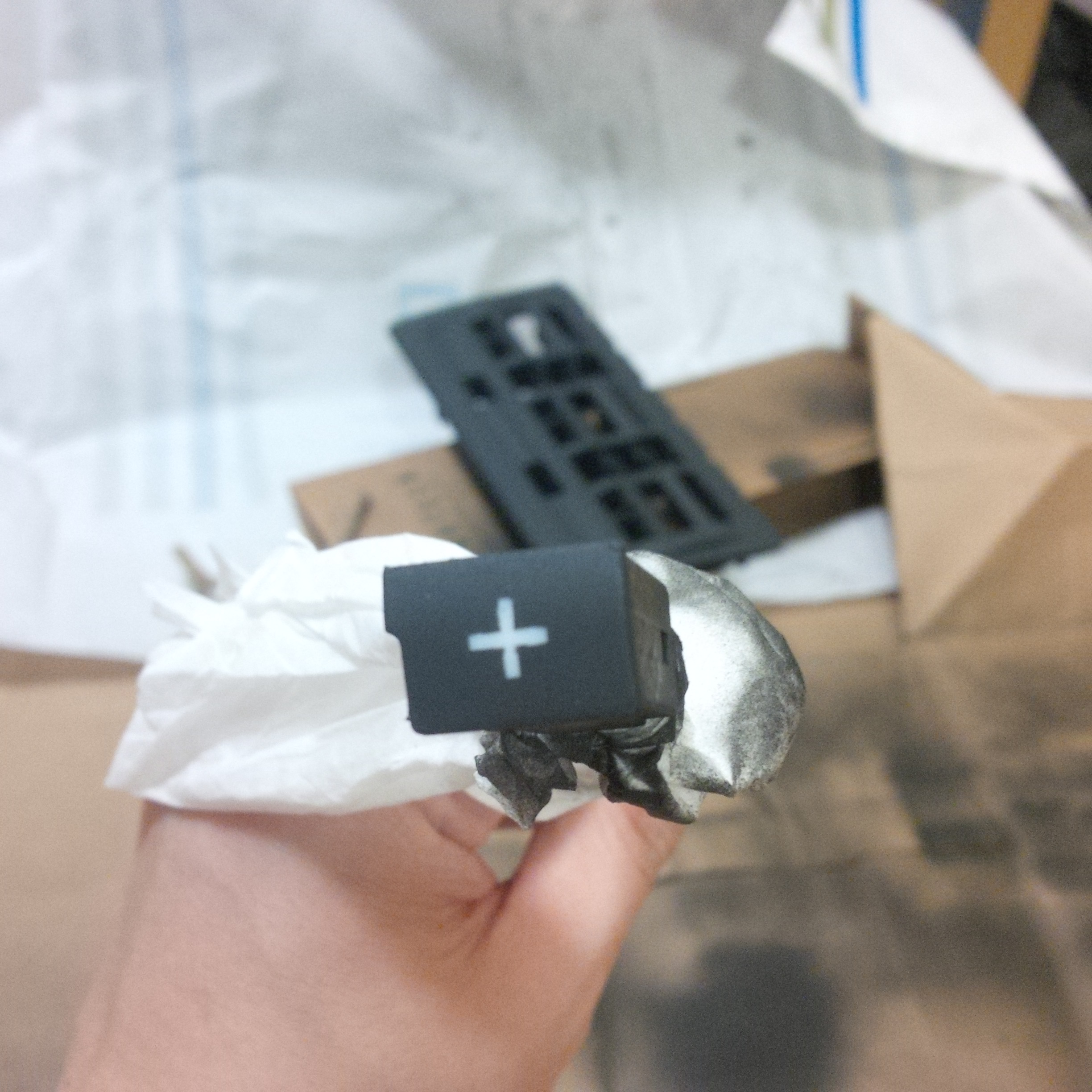

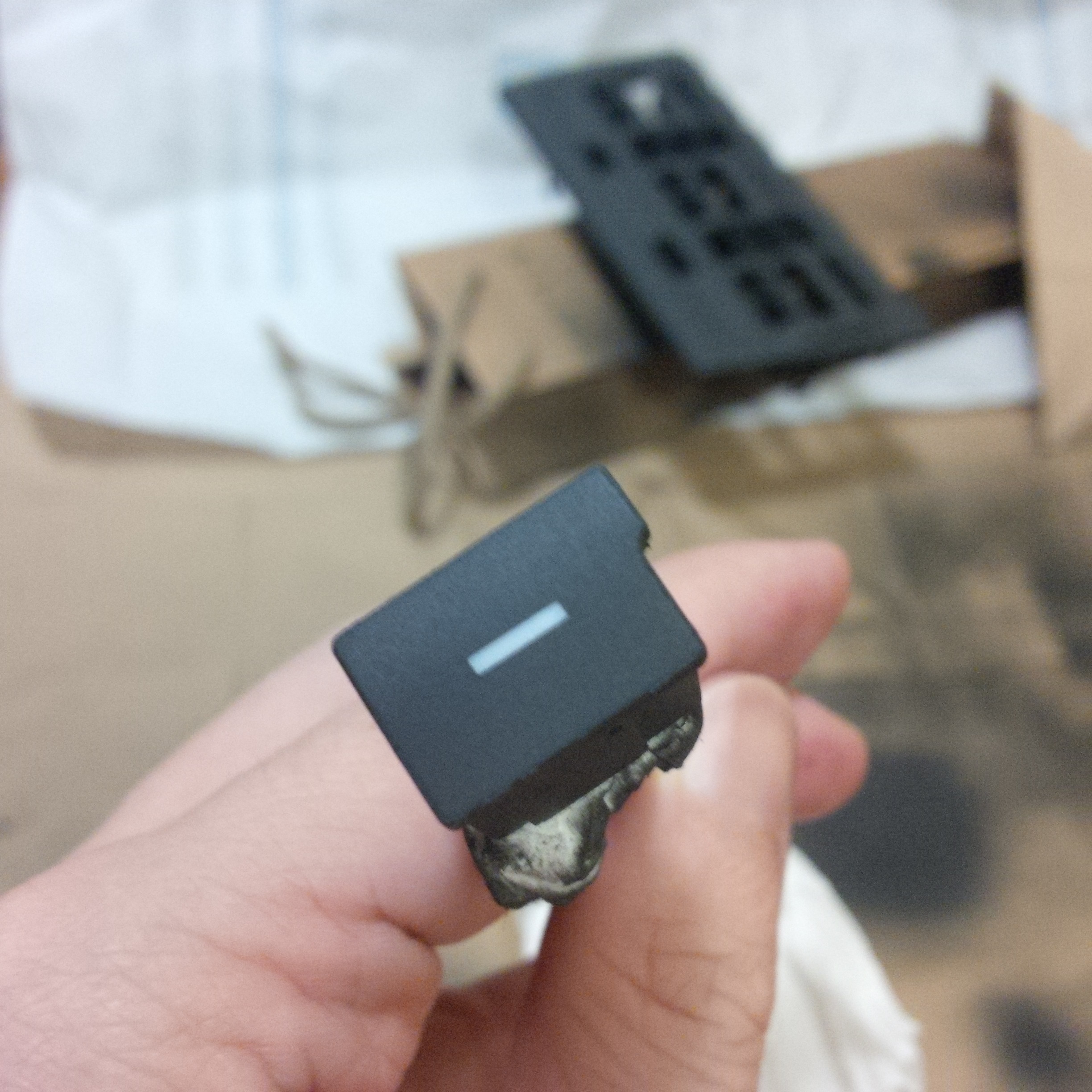

Unfortunately, when I peel the masking tape off, the old paint was too old and peeled out together with the masking tape :bash: :bash: :bash: ...so I have decided to strip the panel out...this is rather simple involved undoing the torx screws and prying off the tabs.
HOWEVER, the buttons turns out great !
+ button
- button

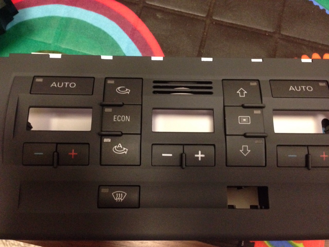

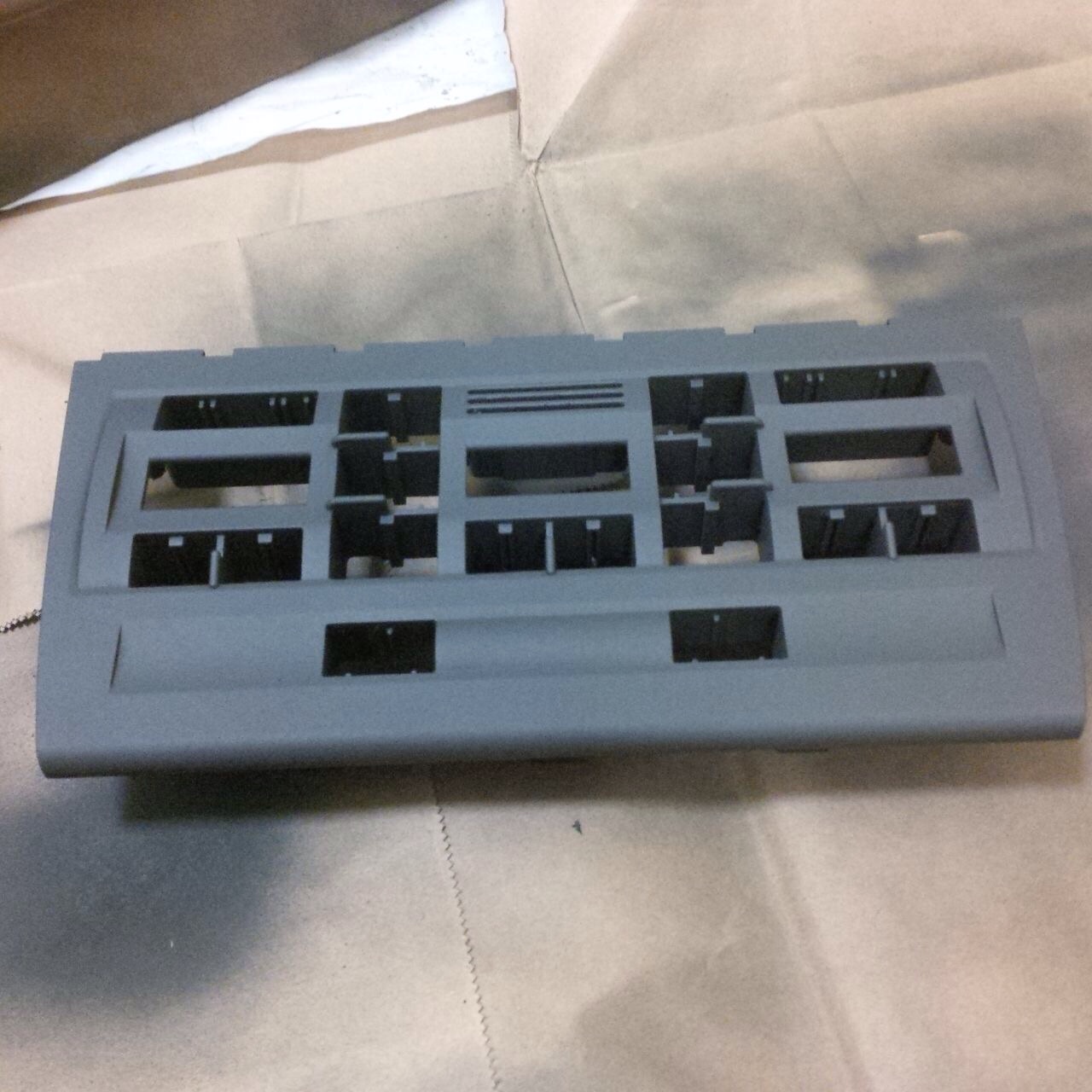

So after cleaning out the panel from the old paint, I repsrayed the entire face plate with 2 coats and left for 2 hours to fully cure.
face plate
Putting the buttons back on and re-assemble:
re-installing buttons
You can tell, from the other original buttons, the colour looks 99.99999% identical and the best part is it also has the same rubberized feel and this paint is harder so it should withstand the daily pressing from driver and passenger.

I find it quite handy having all the model making tools to work on the masking of the + and -, get 2 pairs of forceps to position and apply. A ruler is also very handy to get the measurements right and you have to cut carefully.
The length of each masking strip is around 5mm long. This is the exact one i bought:
