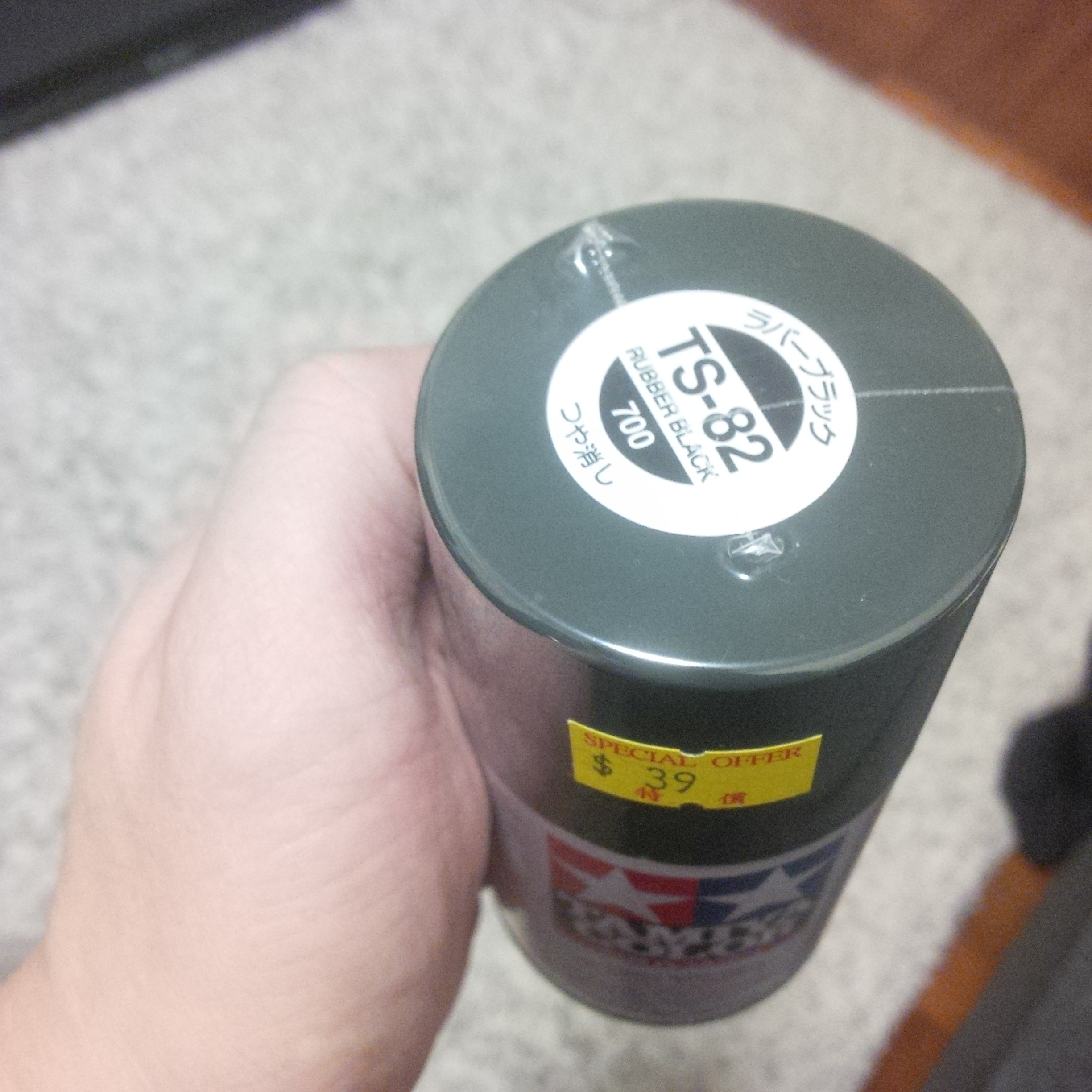

One day I was shopping at the hobby store and found there's a "Rubber Black" matt acrylic paint (Tamiya TS-82), so I figured to give it a try.
Paint

You can tell, from the other original buttons, the colour looks 99.99999% identical and the best part is it also has the same rubberized feel and this paint is harder so it should withstand the daily pressing from driver and passenger.
