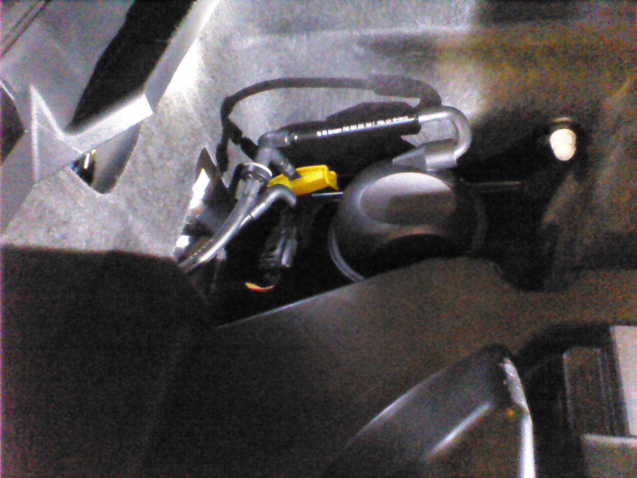

I used a small plastic crimp (used for sealing food in bags) on the hose instead of removing and plugging and this works fine (confirmed by visually checking the flaps in comfort mode - flaps open with crimp on and closed with crimp off after starting the engine). However, is this OK since the hose is still attached to the solenoid? Photo hopefully shows the hose crimped. This is a quicker method of restoring normal functionality if required for long family trips.

mick_thomson74 wrote:I used a small plastic crimp (used for sealing food in bags) on the hose instead of removing and plugging and this works fine (confirmed by visually checking the flaps in comfort mode - flaps open with crimp on and closed with crimp off after starting the engine). However, is this OK since the hose is still attached to the solenoid? Photo hopefully shows the hose crimped. This is a quicker method of restoring normal functionality if required for long family trips.
I did this on my TTRS for 20k miles and no issues apart from annoyed neighbours.

just clamped mine, flaps open all the time. however they also stay open by having individual engine set to dynamic, exhaust to dynamic,on start up flick gear lever into s for a second flick it again back into d and the flaps stay open. Ive been for a mixed run and on my car it sounds exactly the same regardless of whever flaps have been clamped open or kept open by the settings on drive select, am i missing something why clamp them open when you can control it from the dash ?
