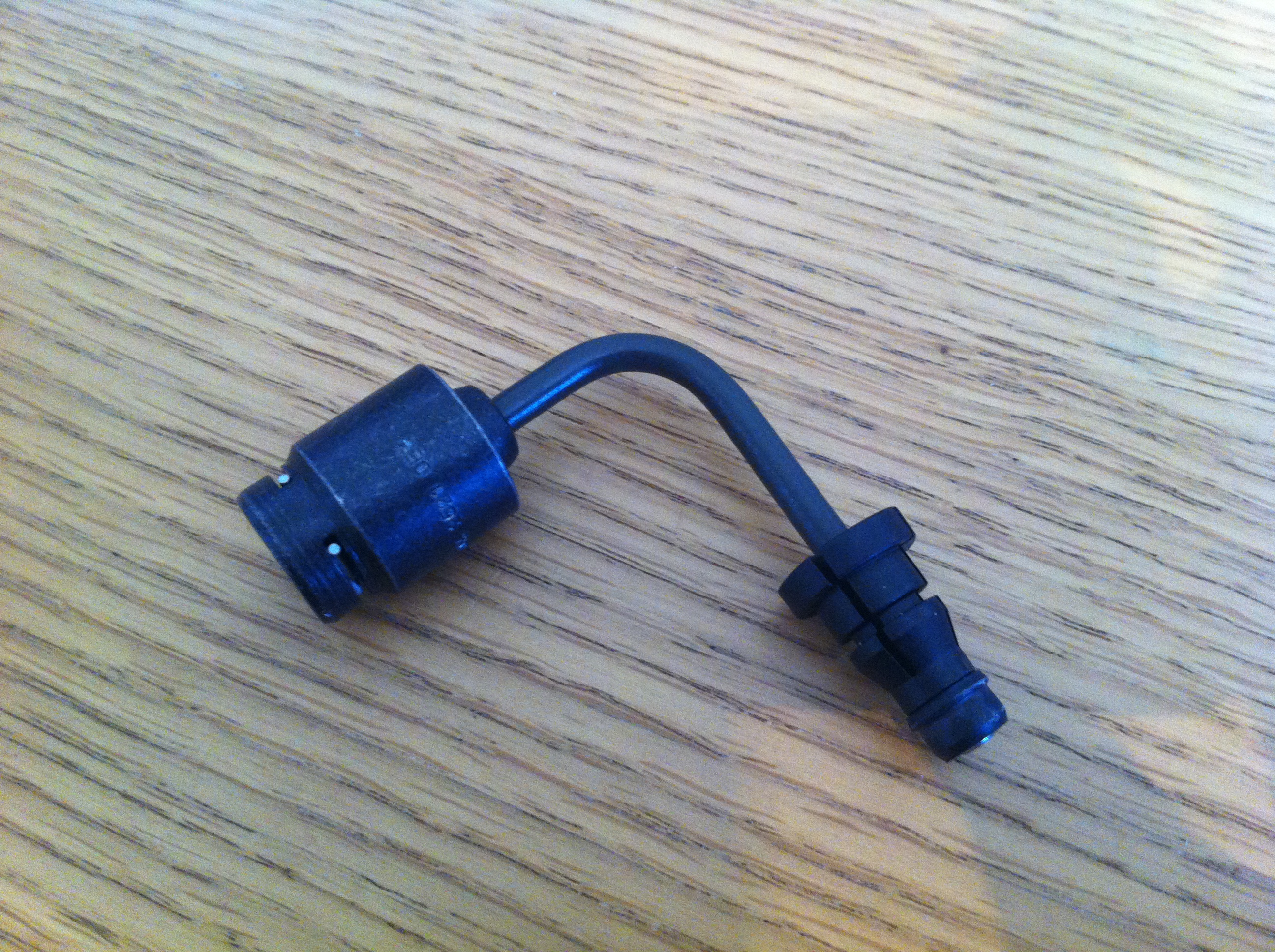

So I have picked up the replacement clutch return pipe (8E0721465) pictured, which I am going to get fitted next week. Am I right in saying that the new part has a metal pipe, and the old part has a plastic pipe? Is this visible to the naked eye, or is the old pipe still metal, but internals have changed? Trying to find out, as if I get the car on the ramp and it already has the metal clutch return pipe then there is no point in doing the job?! Advice much appreciated.......

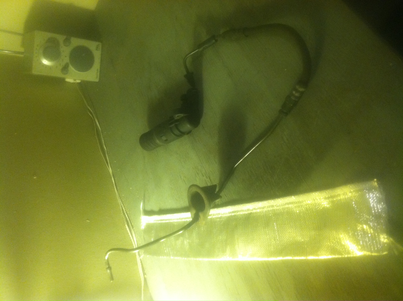

I had mine replaced
small steel line plugs into slave (similar to yours) connected ~10" of rubber hose (some think this is the problem, collapses and inhibits return) connected to another 12" of stteel to the master
that piece on mine is steel, slightly different shape
I am going to run a test
car warmed up
depress clutch and rev engine a few times, see if I get the isse, sticky, pedal stays down
then let it cool for a minute
do with the pedal out, rev it a few times, then see if I get the issue
if I only get it when depressed (release bearing out on busshing) seems to indicate it is the bushing
added a pic, hose oriented to connect to the slave, the silver tubing is the heat sleeving I had the dealer put on

ArthurPE
Posts: 3755
Location: USA
Re: Clutch problem...
Post by ArthurPE » Sat Jul 28, 2012 10:53 pm
is the tube screwed into or pressed into the fitting/bushing?
is that a spring-clip on the busshing? is there a ball and spring in it? or just open?
looked at my receipt
they put on
8E1721465BK (the whole hose)
8E0721465 (the nipple section you got)
did not fix it
http://www.jimellisaudiparts.com/showAs ... bly=752969
items 26 and 26A (at the bottom)
ArthurPE
Posts: 3755
Location: USA
Post by ArthurPE » Sat Jul 28, 2012 11:20 pm
looked in the box they returned the old parts in (I had H&R springs installed during the DRC recall and had the hose done)
I have that part you have
the hose pops into it, and it into the slave
the spring clip is missing, but the hose and the piece you got both have pop in fittings
so it appears the old and replacement part are the same, and both are steel
