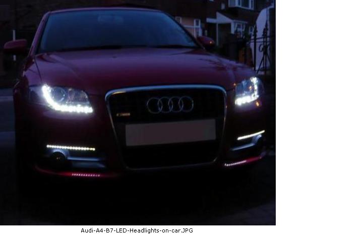

anyone took the plunge with LED DRL units for the fronts from BM Town?
Ive seen several DIY LED mods etc but just wondered if anyone has any further info/pics/opinions on them
see below pic (from BMT website)
may be a bit OTT especially with LED rears - cant make my mind up, especially not from one lowish res pic.
to clarify - Im referring to the main lamp unit not the lower LED strips!
discuss :wink:

RS4-Chew wrote:It was only a matter of time before it was mentioned...
discuss :wink:

the problem with aftermarket from lights is they are crap. The are not bi xenon and not adaptive...
Aftermarket rears are good because OEM are so basic

I took out one of the DRLs and it is a regular 12v 21w bulb. Have asked BM if we can get LED version and also LED rear indicator bulb. These I will change but I will def not go with the front LED strip.

17-APG wrote:I took out one of the DRLs and it is a regular 12v 21w bulb. Have asked BM if we can get LED version and also LED rear indicator bulb.
You need a LED bulb that takes as much current as a normal bulb (often done with an additional resistor in parallel), otherwise the bulb failure warning will go off.

Not the most intrcate either, those with LED DRL's have to locate the resistor in the headlight housing and often in the access cap or outside of it attached to bodywork with wires running into the headlight unit.
Not a particularly easy job but can be done. Also you have the get the right resistor; some reported the resistor getting so hot it melted the headlight access cap!

P_G wrote:Also you have the get the right resistor; some reported the resistor getting so hot it melted the headlight access cap!
the resistor needs to make an approx 1W LED take enough current to "fool" the bulb failure system that it's a 21W bulb - so the resistor has to dissipate 10-20W, so it's gonna get hot.

I think that front end looks awful
