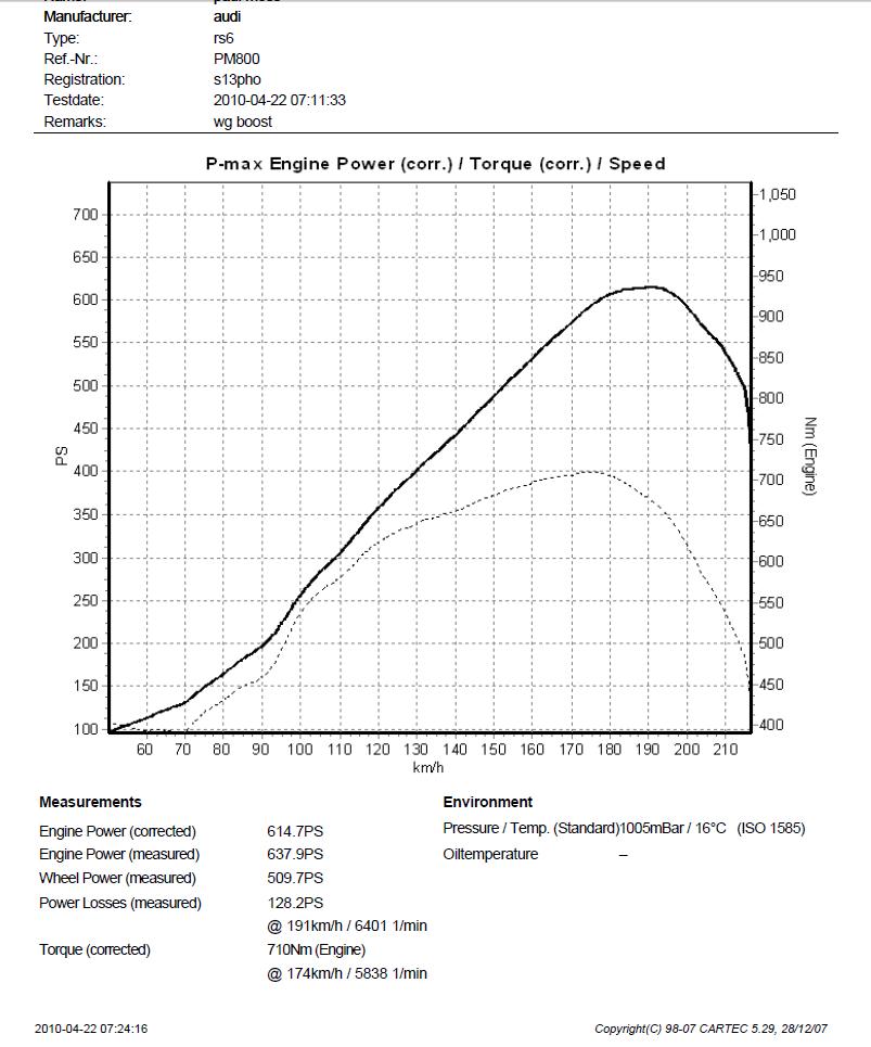

Post by Doug_S2 » Sat May 08, 2010 6:11 pm
The manual car on wastegate boost feels a LOT faster

Post by spurtle » Fri May 14, 2010 9:56 pm
What's wastegate boost?

Post by S2tuner » Fri May 14, 2010 10:04 pm
spurtle wrote:What's wastegate boost?
Mechanical boost as provided by the wastegate springs only, i.e. ECU boost control circuitry "disconnected".

Post by paul_23 » Mon May 17, 2010 10:50 am
So what is the boost measured then? I reckon it would need to be 1.2-1.3 bar at peak to get these figures (?) but can these hybrids hold that boost for the full rev range as I notice the torque curve drops off after 4700?? Have you changed the head gaskets as I think the MTM stage 4 580hp conversion changes these.

Post by 650RS » Fri May 21, 2010 8:08 am
I would also like to know the boost pressure across the rev range. I am fairly confident if the OEM actuators are retained and unmodified the boost will be at most 0.9bar at redline.
Turbo dyanamics in the UK is who will be performing the upgrade on my turbos with the addition of custom made actuators with a base pressure of 0.8-1.0bar compared to the 0.4bar the OEM units.

Post by Doug_S2 » Sat May 22, 2010 8:18 am
the torque drop off is not as severe as the graphs shows - the lower scale of torque on the right side does not start at 0.
boost isn't everything and we try to make the engine as efficient as we can instead of forcing it. We use tubular manifold, good exhaust, thick headgaskets, better ICs and the next stage is a better intake system to test to get it higher.
