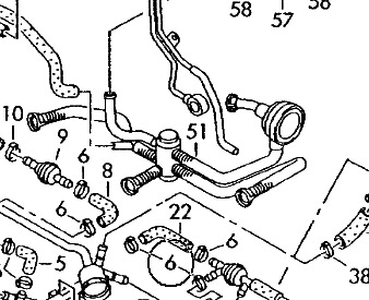

neckarsulm just found out that it is the pcv but only the pipe that connects to the alloy y pipe everything else is fine. I managed to lean on the small pipe and snap it, is it possible to replace this pipe with something similar or do i need the whole thing?
According to ETKA it's all one piece (see pic)

According to ETKA (which is what main dealers pick their parts from) the part number you quoted doesn't exist, which is because you have to buy the whole lot as shown in pic item 51 078 103 235 G

Trust me Hektor, maybe once upon a time that part was available separatelt but now it's not, have checked across VW Audi Seat and Skoda parts indices.
Best to fabricate something.
The same issue applies to the breather on Golf VR6 but luckily you can get the separate bit if you order it for a Sharan.
