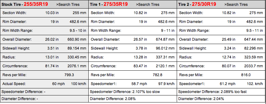

has everone ever tried 275/35/19 size? On our roads is important the sideheight. It looks not too bad:

I think the increase in overall diameter of 14mm could cause rubbing issues. The 275/30x19s come much closer to the wheelarches than the 255/35x19, and I think you might find the 275/35x19 might actually touch the wheelarches.

peterpan is talking about 275/35's and NOT the 275/30s that we are all running...
I'm running the 275/30's myself with no problems at all even when fully loaded with wine after a trip to the Loire - but if you look at the attachment in peterpan's post you will see that the diameter of the 275/35's is 14mm BIGGER than the OE fit 255/35's but the 275/30's that we have is 23mm LESS.
So the 275/35s will have a 37mm greater diameter than we have - I'm almost certain that increase will mean they rub on the wheelarch - rmember the outer edge of the wheelarch dips down closer to the wheel.

It seems i will remain at my oem size.
