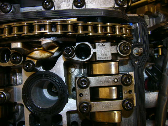

Have just had the problem... The left head has 16 links, and the right has 15 links.. No matter what, the marks on the cams must fit..
If you have 16 link on both side, the one will looks like the picture..

Thanks for that. I do have all the marks lining up correctly when brought up to TDC so maybe I counted the 16 rollers wrong.

I DID turn the engine, but it was always the same.. 16 links on both heads.. At the beginning I had 16 links on both heads and the car was driving like S...
Then I put 15 links on the head where the cams marks didnt fit, and after that it was running like a dream... I know that ELSA said 16 links. Yesterday I had som RS4 heads, and there was also 16 and 15 links on the heads.. SO NO MATTER WHAT, THE CAM MARKS MUST FIT
