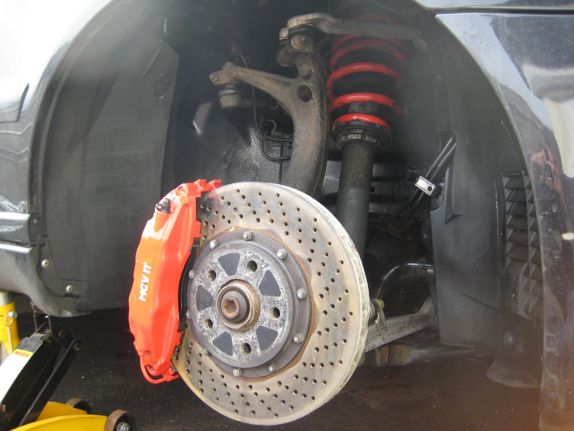

Brakes are an important upgrade. Although I got Porsche brakes to fit under the standard 17" Avus wheels and I am happy with them, I later changed to 18" wheels and in hindsight I wish I'd done wheels and brakes at the same time and could have got a better solution. If you're not ready to upgrade wheels then I actually recommend that you live with the std brakes until you are and then go for brakes to fit 18" wheels.

Nothing wrong with Porcshe brakes, not tried them against B7 and may be a little more expensive but will go in 17's
