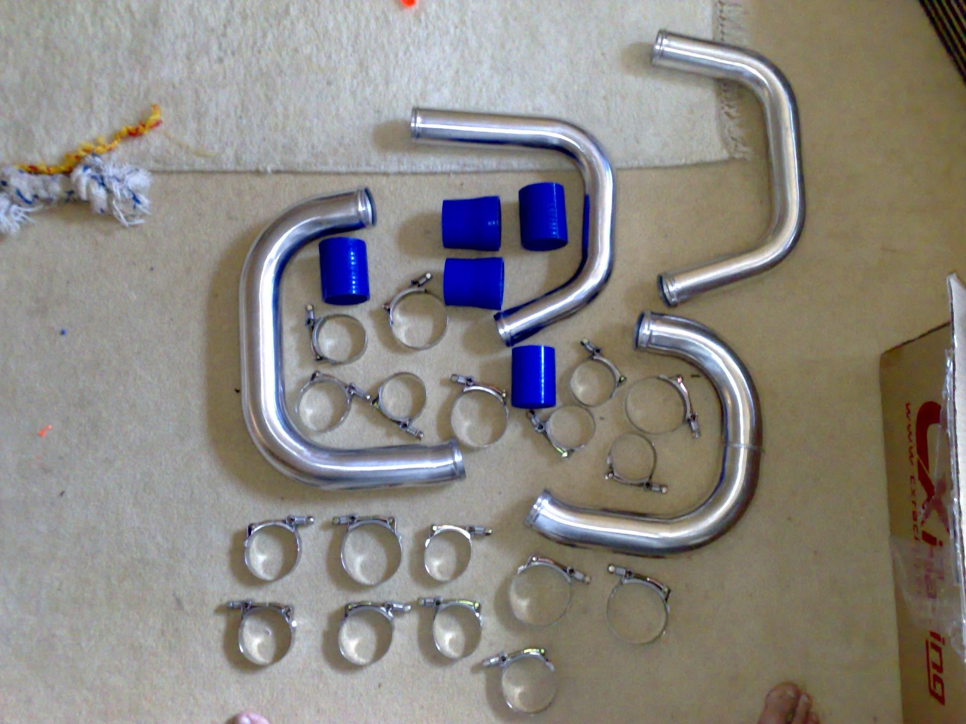

Pics of kit from CX Racing.

Post by musty1 » Sun Jul 20, 2008 9:34 pm
you will need to alter the pipes they not a direct fit well thats what happend to me

Post by h8cak » Sun Jul 20, 2008 9:45 pm
Is that all the pipes? Grizz did say that it might need jigging about?
Wide Body S4

Post by musty1 » Sun Jul 20, 2008 9:51 pm
should of been one more metal and a 45 degree silicone hose. I had to cut some of the metal pipes and use silicone pipes to make up the pipes to fit, they are not like mrc ones. also had to get metal beeds welded on when I cut the pipes or it just pop off when boosting

Post by andream88 » Mon Jul 21, 2008 9:10 am
Musty, those are the new-style pipes.
CXRacing copied them from JHMotorsport ones.
This kit should fit like a charm.
