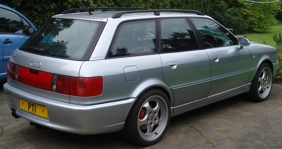

Post by UUUdiRS2Newcastle » Mon May 19, 2008 10:01 pm
Hey people, I think I have decided that I will opt for Standard BOGE shocks all round, and H&R Springs......................wait for it................. is this a good idea? Lloyd mentioned Bilstiens are really stiff shocks, so if I have H&R springs too, its gonna be a bit of a bone shaker, so im thinking that I will go for Boge Shocks, as they are easy to fit, and then Lower H&R Springs, making it a firm but not too firm ride.
Im running 18"x 8.5" Cup 1 Porsche Wheels with Pirelli PZERO NERO 225/40/18"s so its a harder ride already!
Any comments?

Post by alastairg » Tue May 20, 2008 8:43 am
If I was starting again I would go OEM shocks & springs. IMHO they got it right.

Post by Lloyd » Tue May 20, 2008 10:03 am
Fraser, fully re-freshed OEM is probably not a bad place to start, although I think your car will visually look the best when on H&R's. Have a look for photos of Sherv RS2 on s2forum. this will show you what I mean. he was the previous owner of your wheels.
I personally am seriously considering opting for bilstein at some point this year and will talking to Rob GT500 for help on the groove machining.
