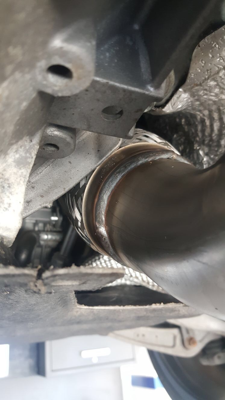

Front section has been replaced by milltek. New section fitted to car and exactly the same issues the section sits about a 1mm away from gear box.
Contacted milltek again who said send it back and they will check it on there jig or travel 150 miles to my nearest authorised milltek fitter for them to have a look at.
I'm not happy with there response so have contacted supplier to return the full system which I'm gutted to do as I love the noise the car now makes.

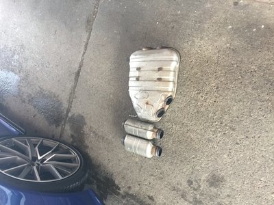

Post by RS6chris! » Wed Jun 28, 2017 7:04 pm
I used
Exhaust A Fix
Based in Darlington
Drove in at 1pm....all done by 3:30!
Top job

Picture of removed boxes

Car lighter now also as added bonus! Lol

I thought the same but the OEM sports exhaust fits perfectly in the centre of the channel about 30mm off the gear box

Post by J66kco » Wed Jun 28, 2017 10:36 pm
[img][/
img]

Strange one as there are obviously hundreds of cars out there running Milltek trouble free. I never had any issues with mine but admittedly I didn't check the clearance either. I doubt very much it's a design issue or Milltek would have been aware of it and redesigned it, something must be different about your particular car.
