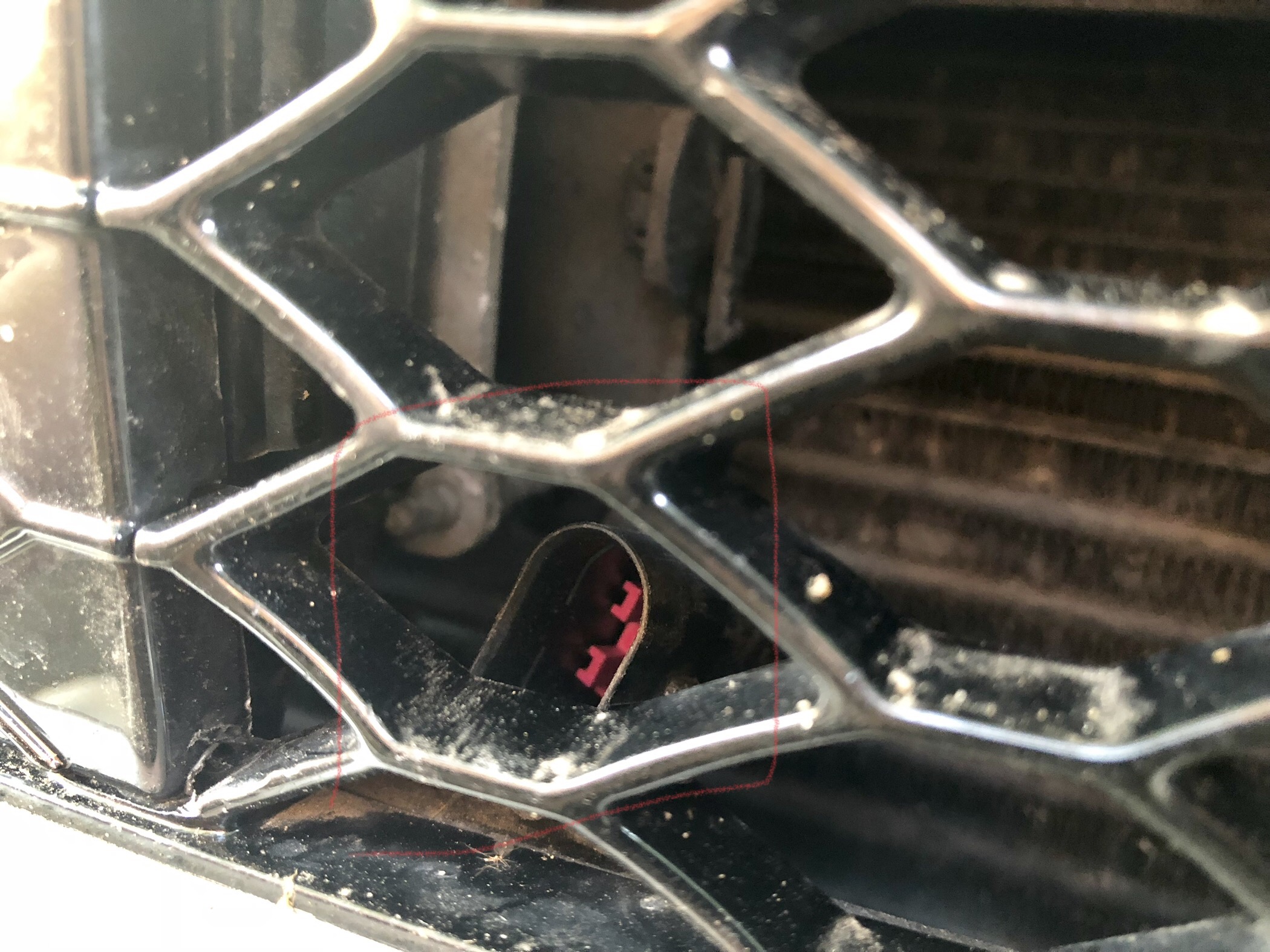

Cannot get the damn acc cover off - grrr... i noticed that i have loose connecter but nowhere to plug
Any hints?
Any hints?

Re: Adaptive cruise
With image

Re: Adaptive cruise
As luck would have it Audi accidentally ordered the radar plate when I asked for just the grill. So I can shed a little light on your cable. It's attached to the plate, what it's for I am unsure but would imagine it's related to the heating of the plate or something?
So get the car on a lift or squeeze under it and try to figure out the location for the plug. Probably quite close as the cable isn't very long.
Tried uploading a picture but can't directly to the site
https://drive.google.com/file/d/1i_1Xqs ... p=drivesdk
https://drive.google.com/file/d/18NifpW ... p=drivesdk
