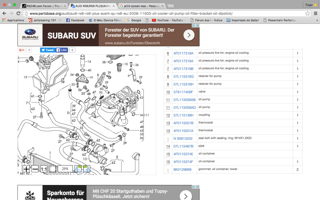

Oil pump seals Part Number
Post by Farravi » Sun Jan 17, 2016 6:01 pm
There you go mate, except for the thermostat I think all the parts were pertaining to the oil leak, can't say if all the seals were used but seeing they are a few squid, I strongly advice to replace them for good measure.
Some part numbers are the revised/updated parts i.e. Most current part no. I used TPS by the by. Good-luck.

Farravi wrote:Image
There you go mate, except for the thermostat I think all the parts were pertaining to the oil leak, can't say if all the seals were used but seeing th y are a few squid you will save yourself future headache knowing you changed the seals/gaskets.
Thanks mate

Hi, sorry to dig up an old thread, but I can't find any info on part 07L103081 Oil Strainer.
Why do we require 8 of these? The parts drawings show 1.......I think.
I have to pull my engine out for transmission overhaul and want to cover all the usual bases while it is out. I am just ordering parts now.
I will drop in and post a hi in the welcome area. When i get a couple of things sorted.
Jim Haseltine
Posts: 908
Re: Oil pump seals Part Number
Post by Jim Haseltine » Wed Feb 26, 2020 9:41 am
The diagram only shows 1 but there are 8 ports and each has a strainer fitted.
