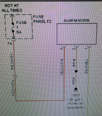

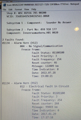

After a little alarm horn fault help
Getting the fault code 01134 Alarm horn H12 no signal on my rs6. I have swapped the alarm unit out under the front scuttle panel and no change.
I have tried looking for a blown fuse but I cant find a labelled alarm horn fuse in the front left and right panels or boot panel. Any ideas where fuse panel f2 is?
Otherwise I’m guessing a wiring fault? Any ideas, experiences or guidance appreciated.

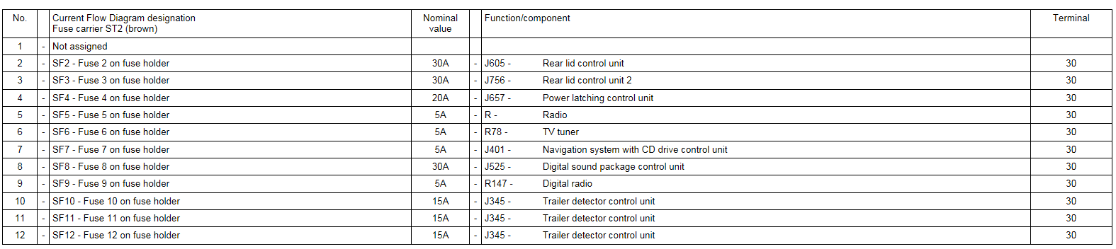

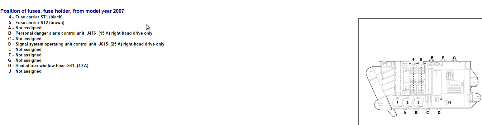

As far as I can decipher the nightmare that is the current flow diagrams in ELSAWin, on the Avant the alarm horn fuse is number 8 in the black fuse holder in the boot. Looking at my car I'm pretty certain the fuses are numbered bottom to top.

from my search today the H12 alarm horn itself is from Fuse 7 on ST2 guys which goes to terminal 3 on the horn, but its also connected to J393 convenience unit in the boot (at terminal 1 on the horn), J393 presumably drives the output or monitors for the diagnostics or both.
ST2 is in the boot offside behind the cubby hole
Noteworthy J393 itself has a couple of Fused feeds supplying itself, its a very busy controller!
If you have power at the horn on Terminal 3 and a good ground on Terminal 2, its pointing to an issue from J393
