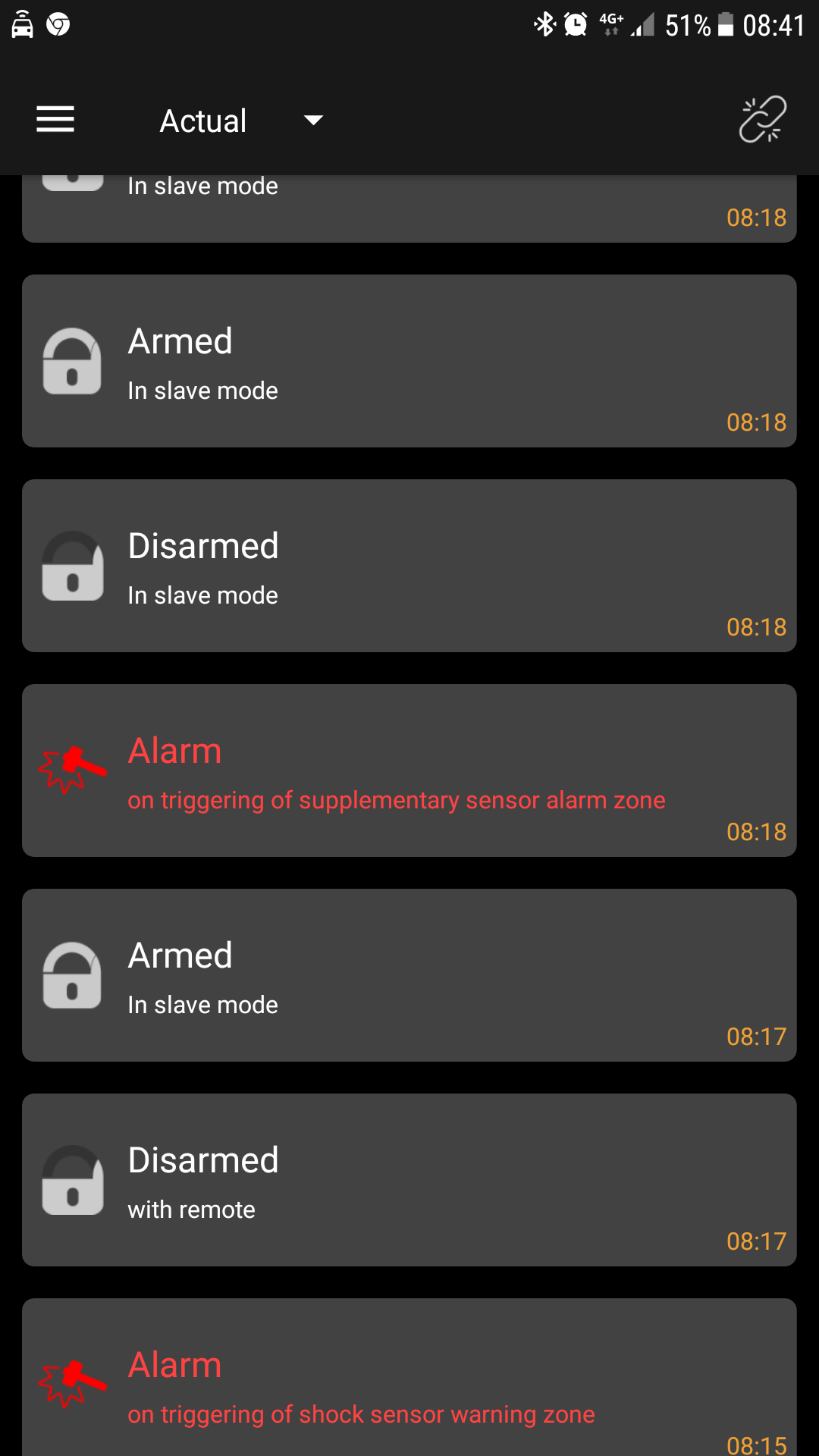

Perfect not a problem. It went of last night due to a sensor so waiting for a call back today. But very happy with yhe install.

Neilb76 wrote:Perfect not a problem. It went of last night due to a sensor so waiting for a call back today. But very happy with yhe install.
May I ask, what sensor?
My tilt is triggered periodically. Even on almost lowest setting. Usually at night.. a little confused.

Post by Neilb76 » Thu Dec 21, 2017 1:02 pm
This one and it was at night as well wired
