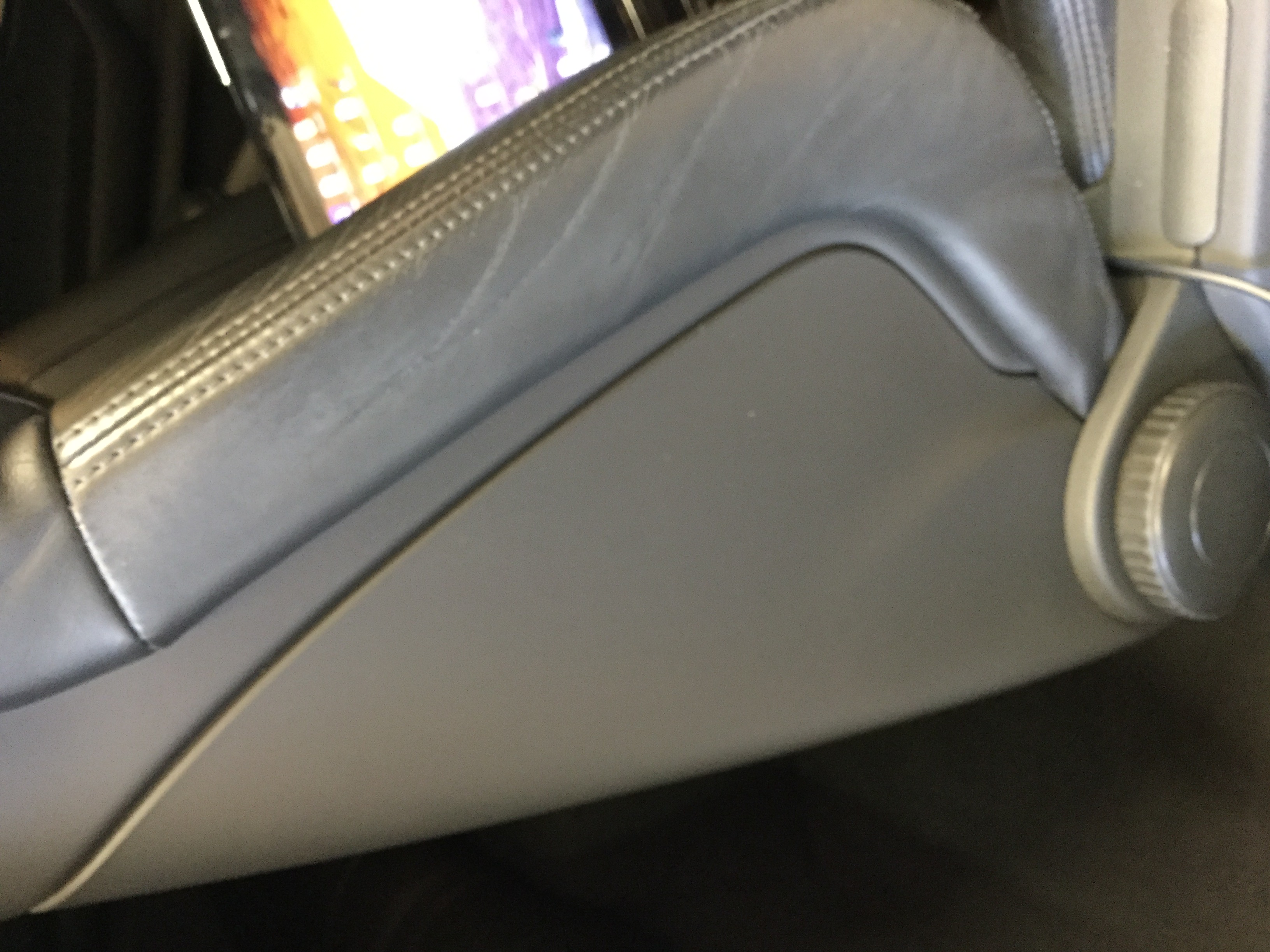

Have a look at your buckets. You should be able to identify the airbag locations.
Re: Coding for airbags on comfort seats
There's this panel but it's not marked airbag and I thought this was the whole point of the excercise that buckets didn't have built in airbags

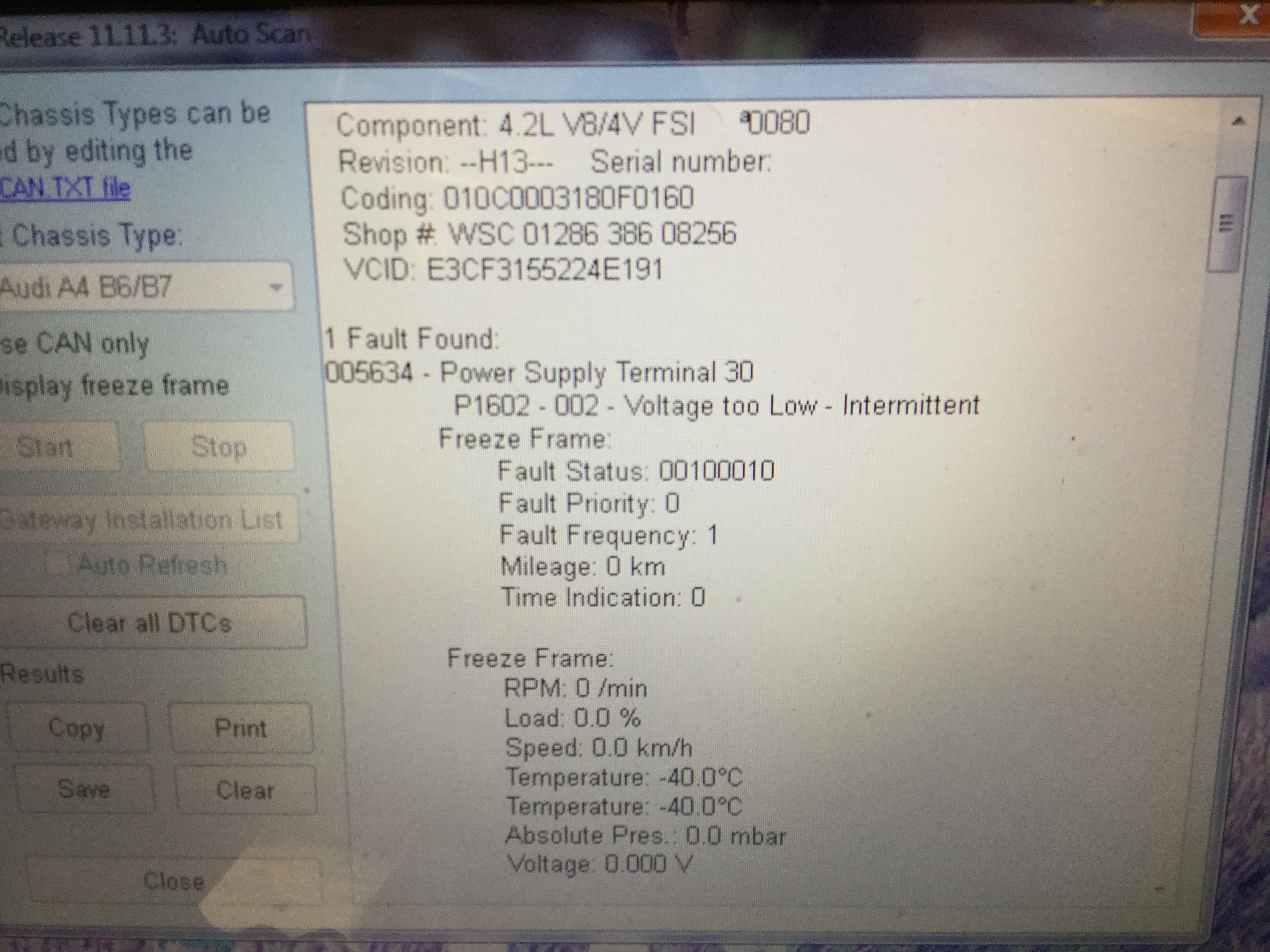

Hi Shop ,
Changed code as discussed and got Changed back and cleared and no codes!

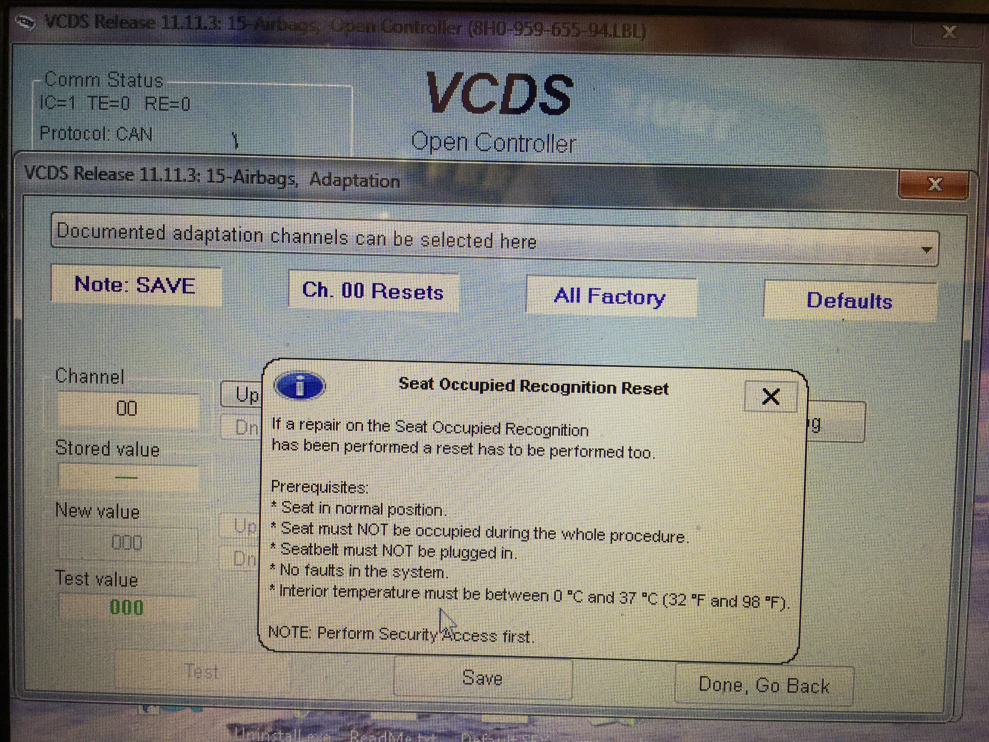

I wonder whether you will have to mess with the seat occupancy stuff. One problem at a time...

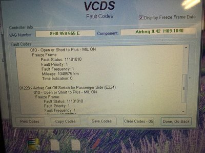

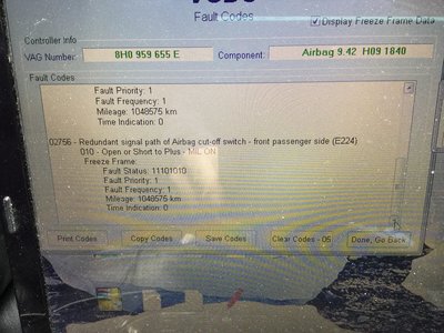

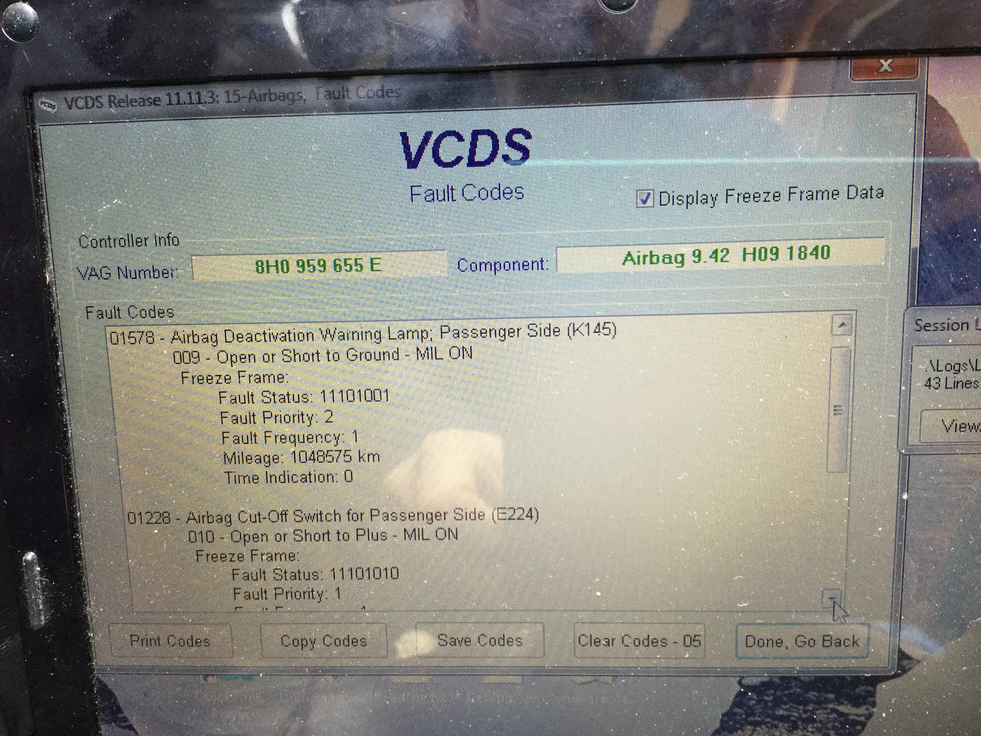

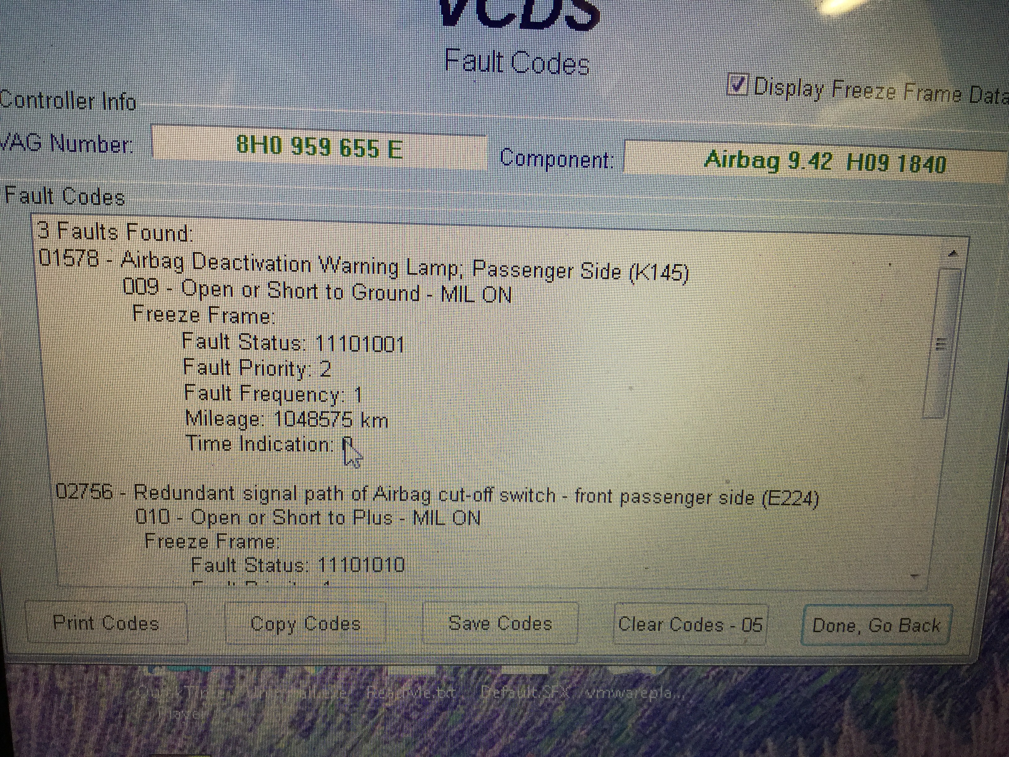

So I've changed the seats over but Noe I have both an ESP light and an airbag light on. The on board display says passenger airbag deactivated on start up as well.
Changing the coding as previously mentioned does not seem to make any difference. These faults are now shown

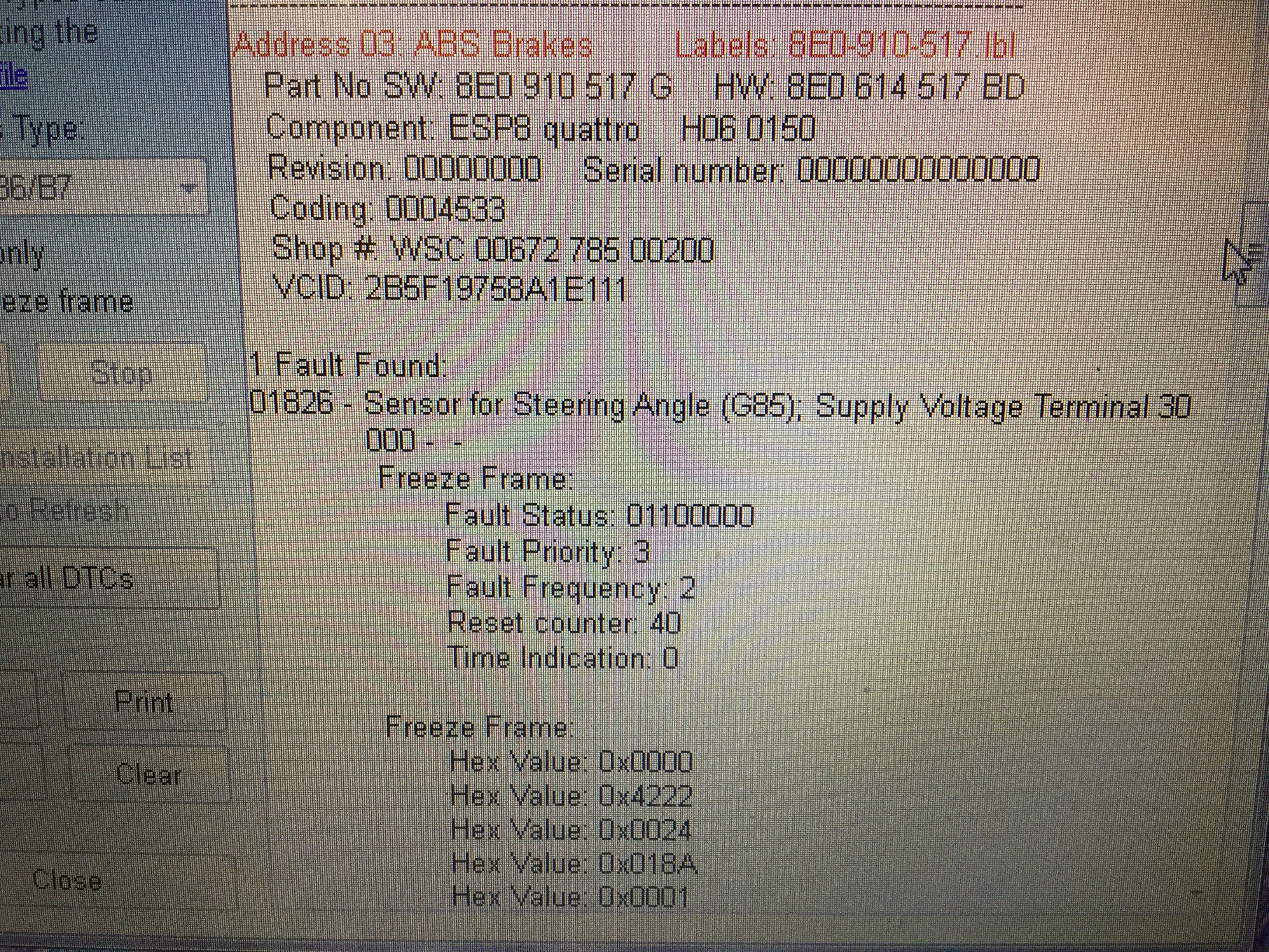

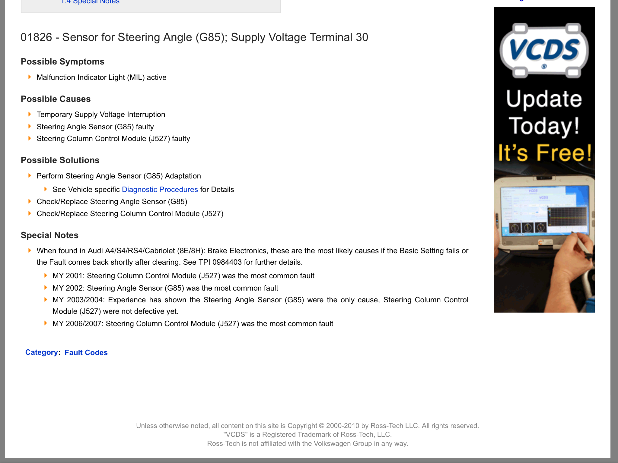

Battery was disconnected prior to removing seats . Found this relating to fault code shown All advice gratefully received!
Looks like it's expecting to see an occupancy sensor. Did the other car have one?

Are there any connectors on the seat belt anchor? Other than pretensioner?
