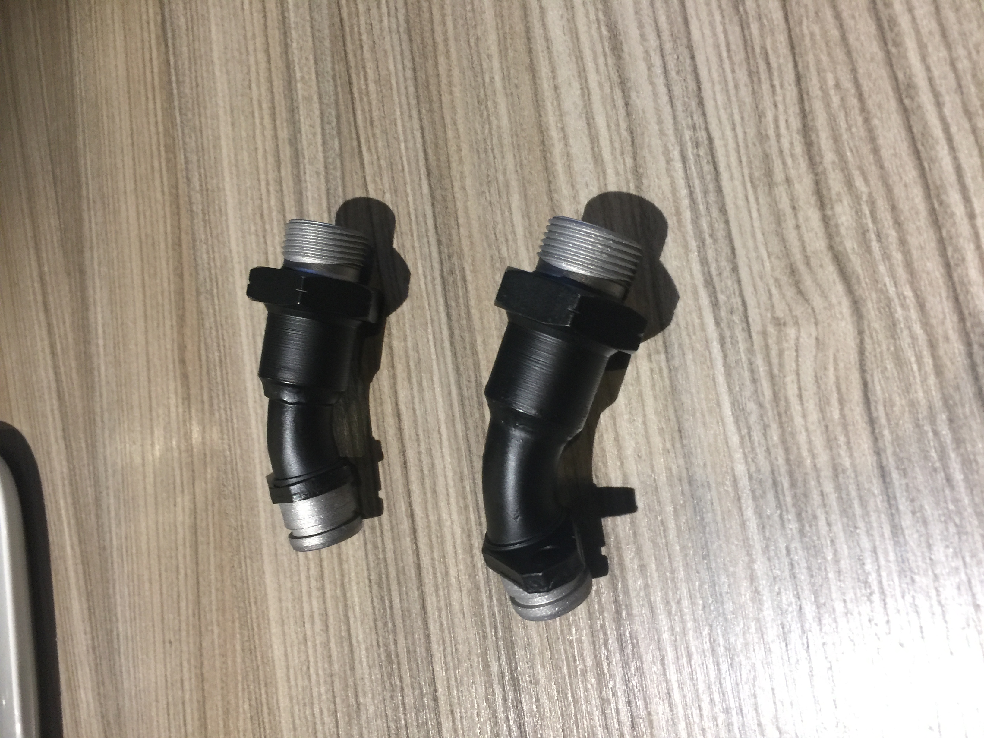

Lukes3
Posts: 657
Re: oil cooler fabrication
Post by Lukes3 » Tue Jan 16, 2018 2:33 pm
I made these out of the old pipes/fittings an now use 1/2” bsp allround.
Tommcole
Posts: 19
Joined: Mon Aug 10, 2015 10:06 pm
Post by Tommcole » Tue Jan 16, 2018 5:43 pm
Cheers mate appreciate it
