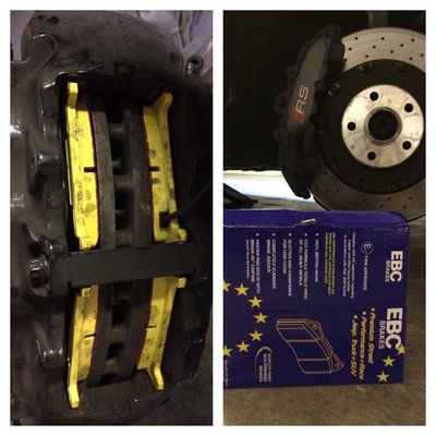

i fitted yellows to mine with a smear on coppaslip on the backs , not a single squeek since fitted so dunno what the problem is with yours
