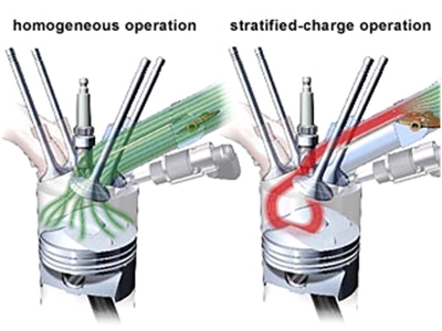

Removing flaps improves airflow, however the circulation of the airflow around the valves will change.
Homogenous and stratified modes are what the flaps are designed to do . With them removed the air flow will be in homogenous mode, air tumbling around both sides of the valve head (stratified mode, one side of valve head).
When removed you may see an increase in MPG when stationary.
This is my understanding

sonny wrote:Removing flaps improves airflow, however the circulation of the airflow around the valves will change.
Do you think removing the flaps may help with the carbon build up as it would change the way the fuel and air moves around the valves + do you know if theres a link or any info any where on how to remove them, Cheers
