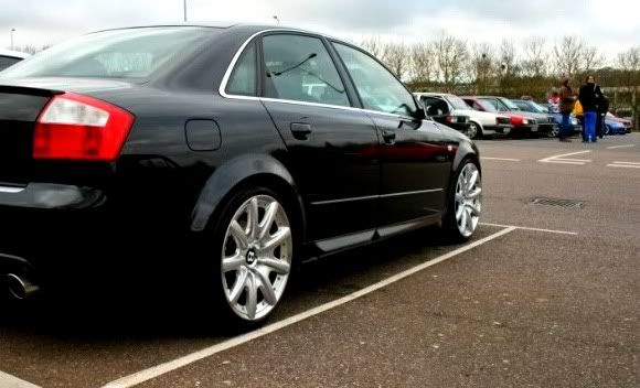

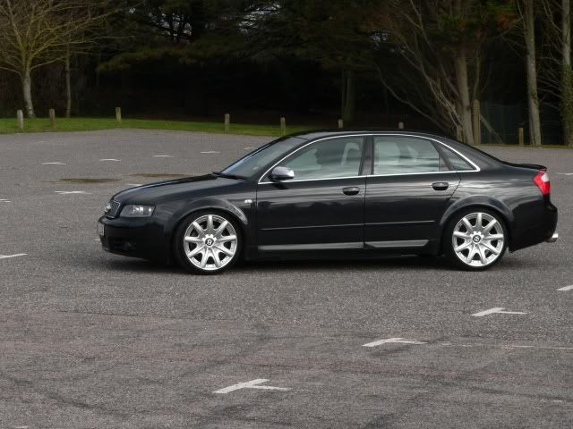

I've got 19x9 ET41. Fits perfectly. No rubbing ever
RS4 wheels don't work because they are a low offset so push the wheels outward to fill the wide RS4 arches

235/35/19 on an ET 35 offset. the PCD is 112...
no rubbing or anything, lovely!

Mine is lowered at fair bit on KW V3s aswell, forgot that bit
it's bedded in now so dropped abit more than those pics
