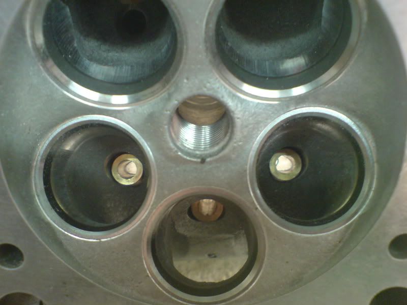

dummi wrote:put some pics up satanschild i want to see what you've gone and done :P
:roll: oh if i must .... lol
before, you can notice the massive lip left when machined for the valve seats...
and after...
and the exhaust port polished ....
its took me about 9 hours to do one head ...
and after...
nice work there,i know how time consuming it is,no quick way if you want it right though
