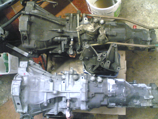

new s/h box
Post by quattronutter » Tue Jan 01, 2008 9:52 pm
spot the differences...pre facelift and facelift :?

May I ask how many hours did that take? I think I'll be doing the same shortly.

wish mine would fall out so i can check the turbos lol or someone pull it out cheap!!

Er, is one mucky, the one with the oil feed?

about 9 hours in all including getting the box off,i expect a lot more removing turbos,heads,sump,crank....came out easier than i expected

spen wrote:Er, is one mucky, the one with the oil feed?
looked like an oil feed its actually a breather of some kind,centre diff is also slightly different and there is an extra hole next to the crank sensor at the bellhousing on the facelift[clean]box

pre facelift has the extra hole i should say...was unused though
