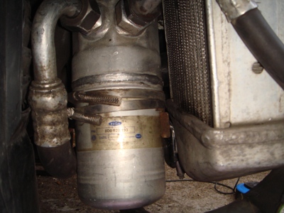

Post by rolskii » Sat Nov 10, 2007 10:07 pm
s4woody wrote:the driver side bracket dont fit cos of the air con canister..
I got the can mounted as it was banging against my i/c, which is obviously causing a air flow restriction on the back side too ...
see if I can take some pics tomorrow as its in bits .... :lol:

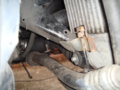

Post by rolskii » Sun Nov 11, 2007 11:30 pm
Heres some snaps, I used the original s4 can bracket to attach to the rs4 ic mounts, the captive stud in the old bracket is holding it to the upright arm(underneath) of the ic mount, its then had a bit of forming, used 2 of the ic jubilee clips, its nice an tight .... gives flow through the ic ... stops more rattles .. :audibash: HTH
