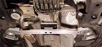

how hard is it 2 fit DTS?
The lowriders gone! But still loved. Long live the 911-C2!!!
S4TAN
Posts: 3966
Joined: Sat Aug 05, 2006 12:05 pm
Location: Planet of the Apes
Post by S4TAN » Wed Nov 01, 2006 7:17 pm
Piece of p!ss

Post by philipwalker » Wed Nov 01, 2006 7:59 pm
Just make sure you clean the threads on the g/box mount

Post by S4TAN » Wed Nov 01, 2006 8:10 pm
...and re-cut them if necessary before mounting the bush to the g/box

any picks? why am i looking, havent got the damn thing yet! is it a ramp job? or a drive jobby? :boots:

Post by S4TAN » Thu Nov 02, 2006 6:17 pm
Did mine on the driveway - jacked the front up and put ramps under the wheels. Main thing to be aware of is supporting the transmission housing when you take off the 2 factory-fitted transmission suspension plates (triangular shaped metal plates on either side of the car) as the trans housing will drop when these come off. I used a jack to hold it in place. You'll see when you get the thing; it's all clearly described in the instructions. But as stated above make sure the threads are good on the 2 holes in the g/box before attaching the rubber bush - try putting the bolt in on it's own first and see how far it will screw in - if not very far then spray WD-40 into the holes and gently re-cut the threads till the bolt goes in fully - when you've done that then take the bolts out and attach the rubber bush....etc.

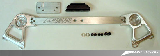

DTS stands for drive train stabilizer.
You must surely notice the kangarooing effect when changing gears. The gearbox moves back and fourth and makes a very uncomfortable soind. The DTS is basically a special metal shaped bar that bolts the drivetrain to the car to minimise the the kangarooing effect of the drivetrain. This provides a more solid gear change without the jerkiness as well as putting less pressure on where the drivetrain is secured.
From the site
The AWE Tuning Drive Train Stabilizer (DTS) eliminates the excessive engine and transmision torsional movement found in these vehicles. The results are phenomenal throttle response, crisper and more precise shifts, and more power to the ground.

MarkB
Posts: 5695
Post by MarkB » Fri Nov 03, 2006 11:19 am
So am I right in thinking there is a bar there as standard, justnot as beefy as the DTS, or the bar that is there doesn't connect to the gearbox?
Mark
S4TAN
Posts: 3966
Post by S4TAN » Fri Nov 03, 2006 11:22 am
The small black bar that's there doesn't clamp up to the gear box - it's like a cross-brace, but doesn't stop any g/box movement....
Deus ex machina
MarkB
Posts: 5695
Post by MarkB » Fri Nov 03, 2006 11:27 am
S4TAN wrote:The small black bar that's there doesn't clamp up to the gear box - it's like a cross-brace, but doesn't stop any g/box movement....
Ah OK. I hate getting under cars so thought I'd ask ;)
