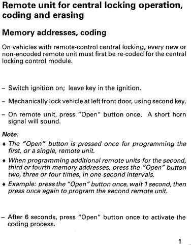

Post by MCB » Thu Sep 14, 2006 10:50 pm
Can't remeber where I found this, won't do any harm to try:

The transponder isnt battery driven and cant be recoded with the ignition trick - this applies only to the infra red/central locking component of the key.
Youll probably need to pay the stealers unless http://www.rs246.com/index.php?name=PNp ... ht=#130671
