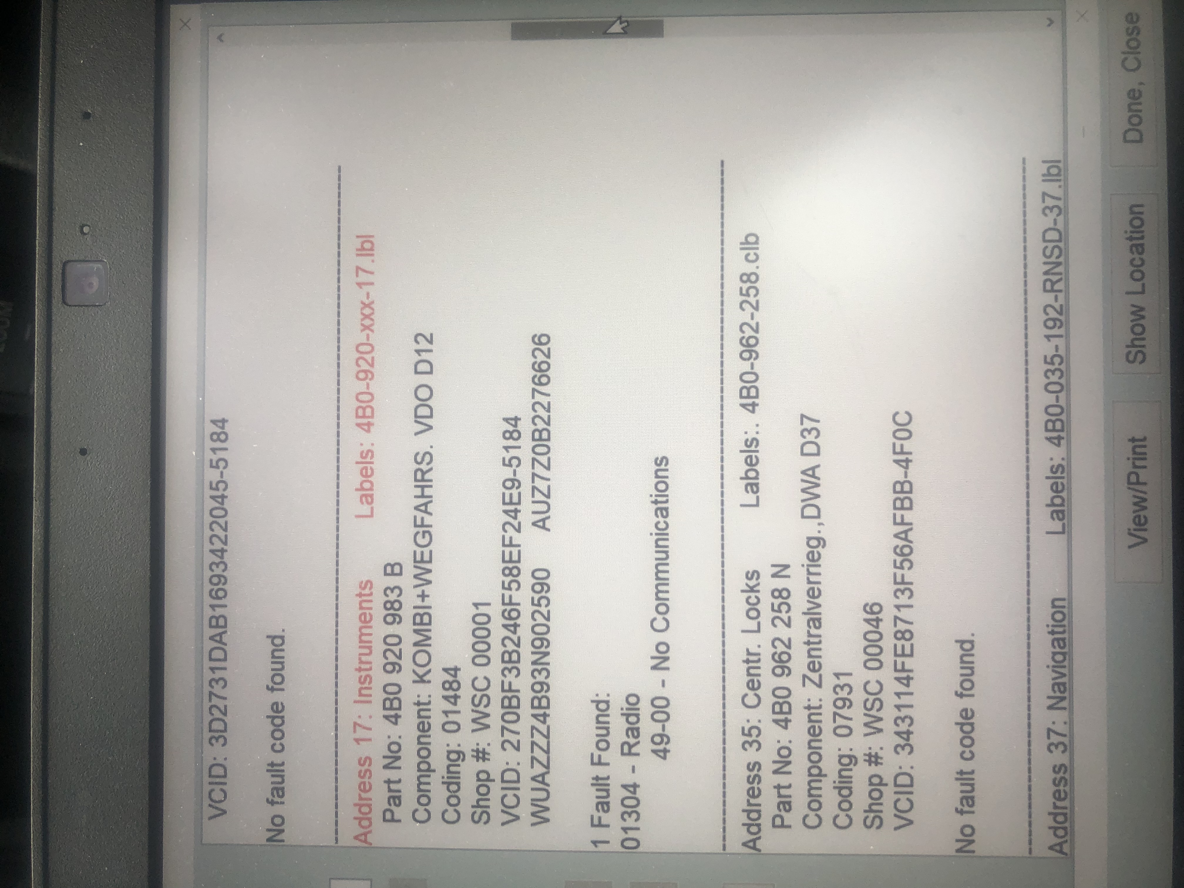

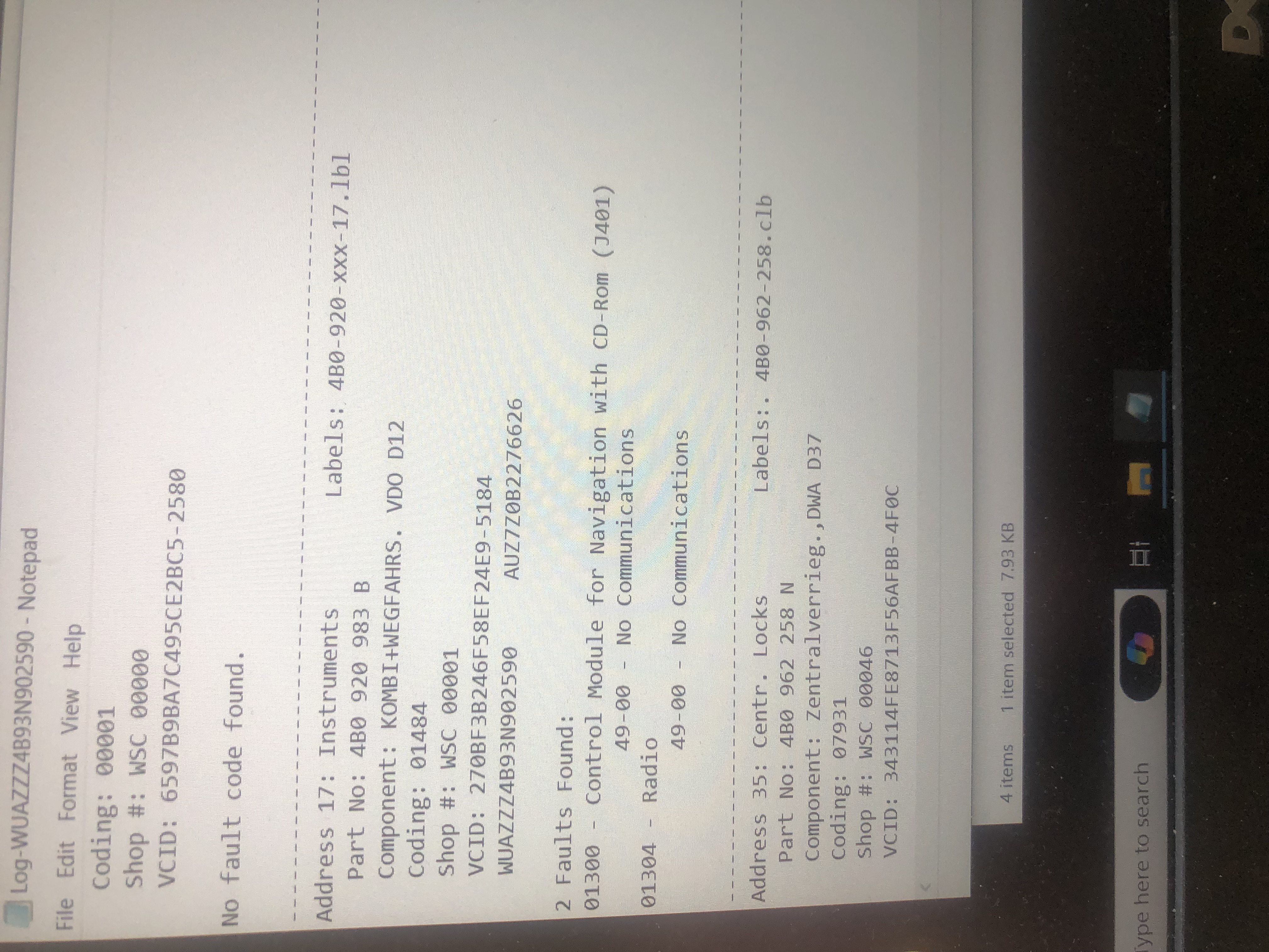

01304 error.
- Posts: 2956
01304 error.
Sort 1 fault then get another one (or two).
Address 17 instruments.
01304 radio error
49:00 communication
Radio works as normal.
Anyone familiar with this error.
01304 radio error
49:00 communication

Re: 01304 error.
No Ben. Original rnsd radio.
Very recent error.
Very recent error.

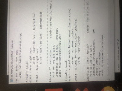

Re: 01304 error.
Could be the TMC module. That handles the translation between the RNSD and the CAN comms of the rest of the car. Presumably you’ve got no radio info on the DIS either?

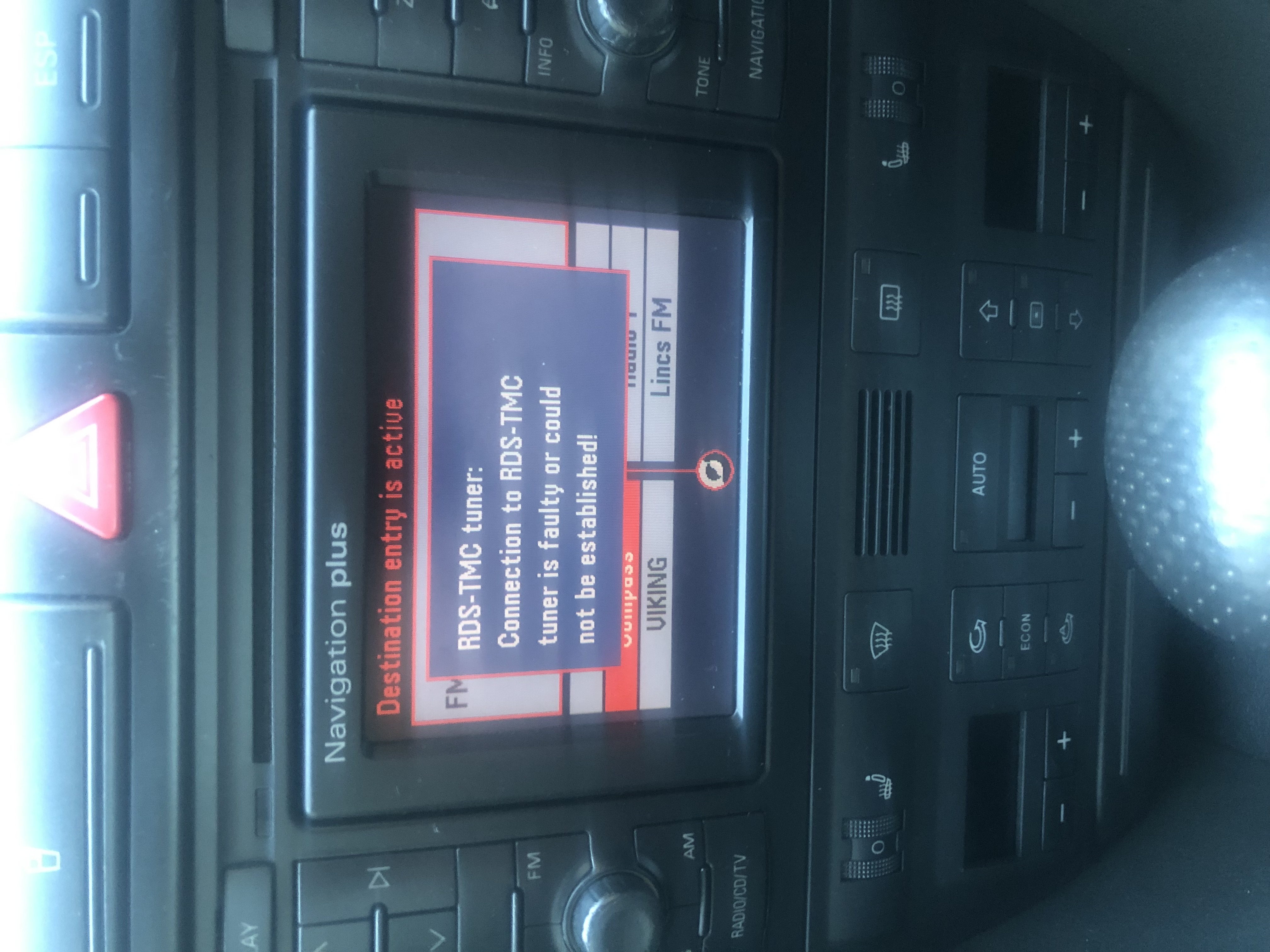

- Posts: 2956
Re: 01304 error.
Get this when I turn the radio on.

- Posts: 2956
Re: 01304 error.
PhilS2. Thank you for your input.
Ben does the above photo confirm your TMC module recommendation.
Re: 01304 error.
Yeah, that’s the fault I had. I remember now. But worth checking what PhilS2 mentioned. Could be wiring, especially if someone’s been messing in the area.
