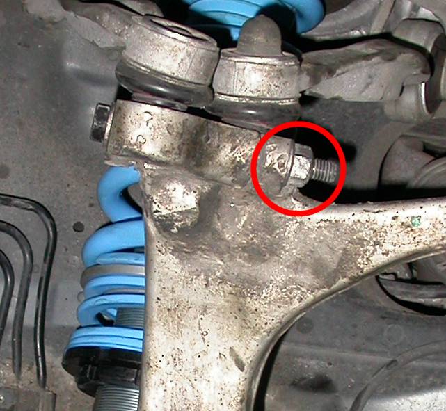

So i made a start today dismantle the front suspension.
This bugger one is in rock solid, tried abusing the housing with a hammer, tried to turn the bold, nothing seems to work.
Sprayed with wd40 couple times.
Are there more options to get it loose without distroying the bold and drill it out?

You have to remove the bolt to get the ball joints out. No way are they coming out if the bolt is still in situ.

Yes i know, but its in rock solid:(
And im a master in distroying things...

So you can't turn the bolt?
Re: On the road again...
No, maybe i have to try harder, but im afraid to sheer it off...
The nut was dead easy...

Were you able to remove the nut?
Yes easy:)

Can't you drift out the bolt then?
Soak the whole lot in release oil for a few hours. WD40 isn't ideal.
Have you got a blow torch?
For the avoidance of doubt, this nut:
Yes, thats off already.
No, i dont have air pressurized tools unfortunately.
I see of i can hammer on end of bold with piece of wood in between...

That f....ing bold i was already worry about before i started.

Blow torch:
Yes, that's what drifting means.
*bolt
