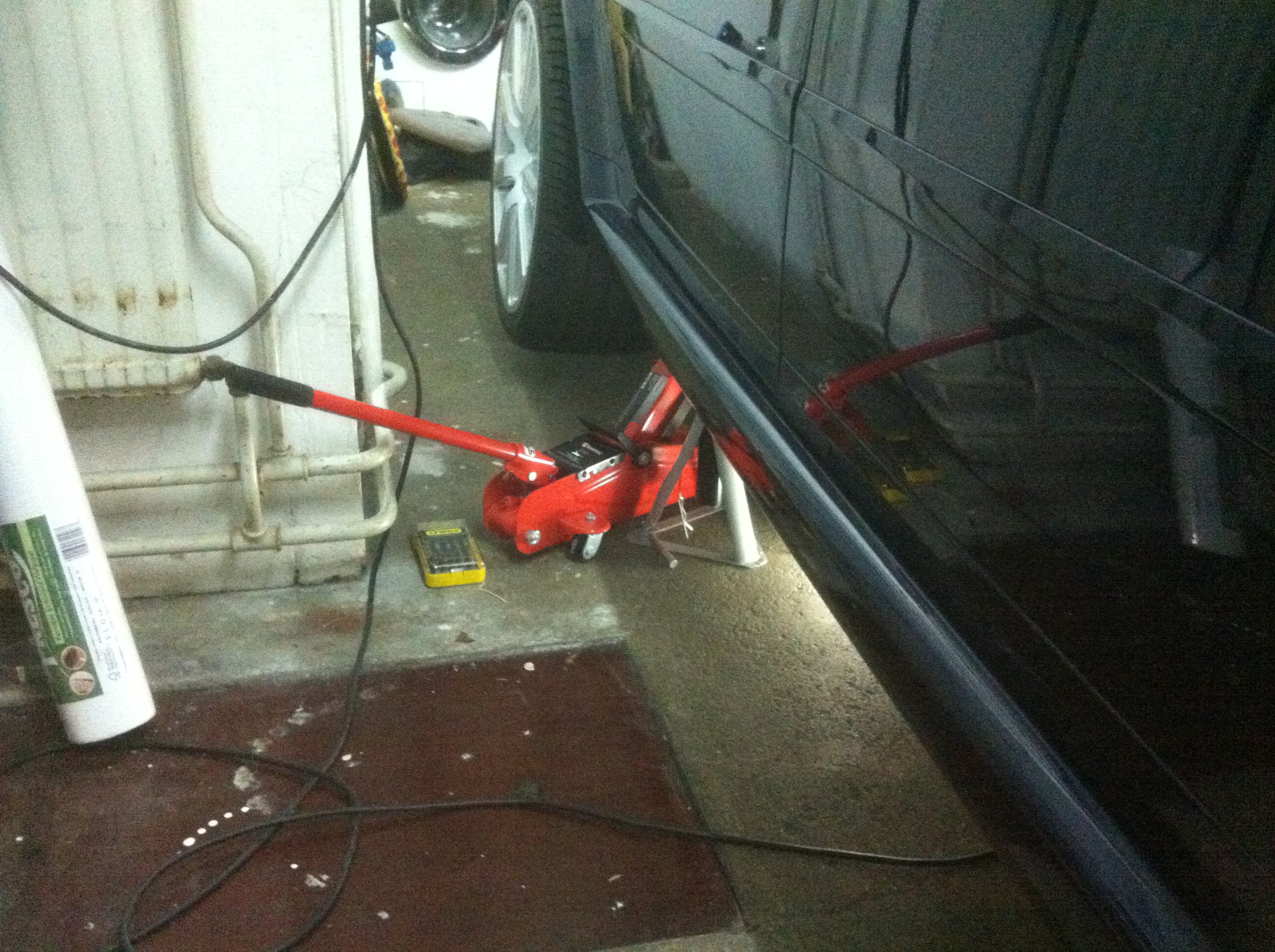

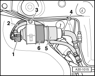

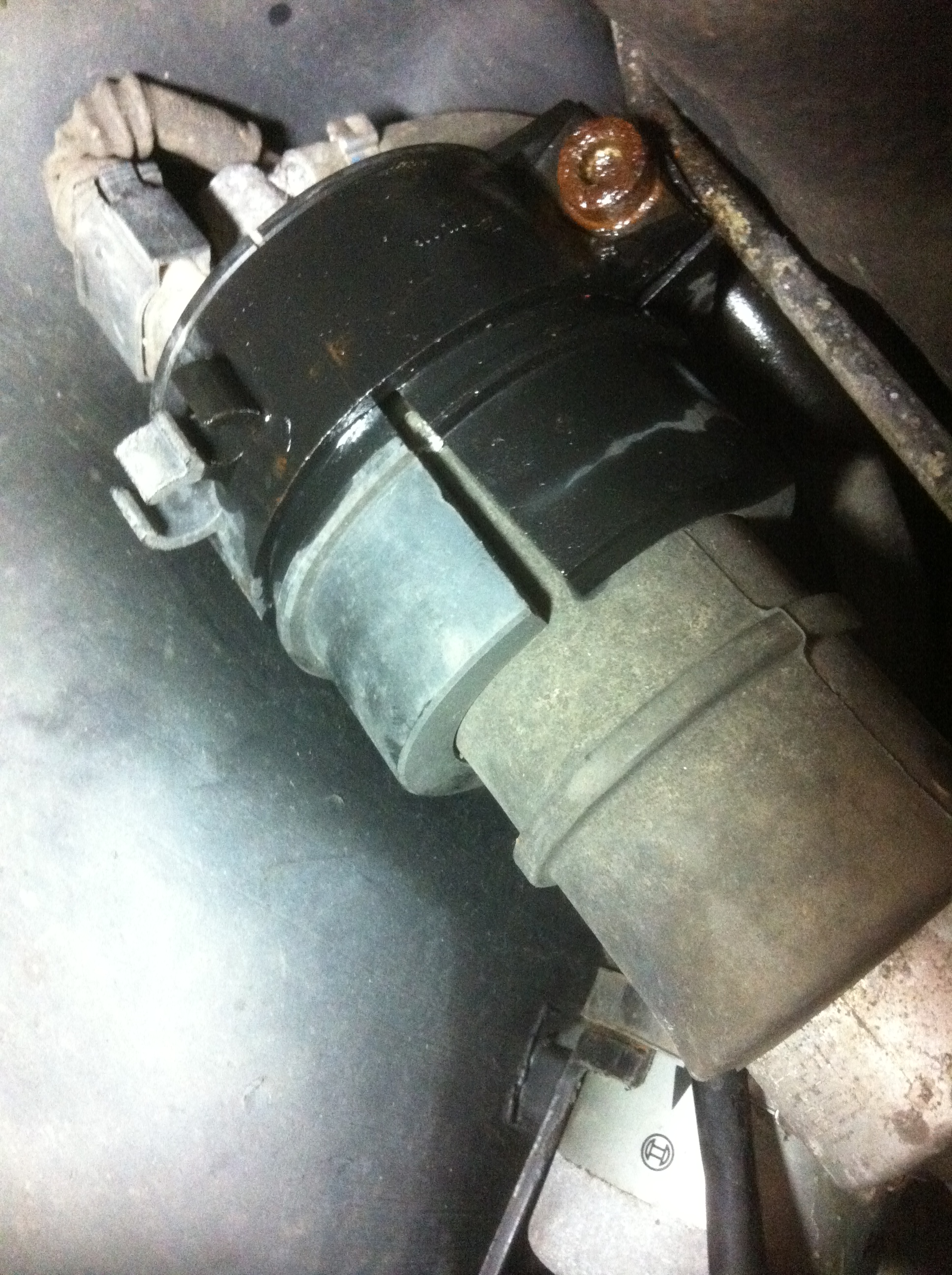

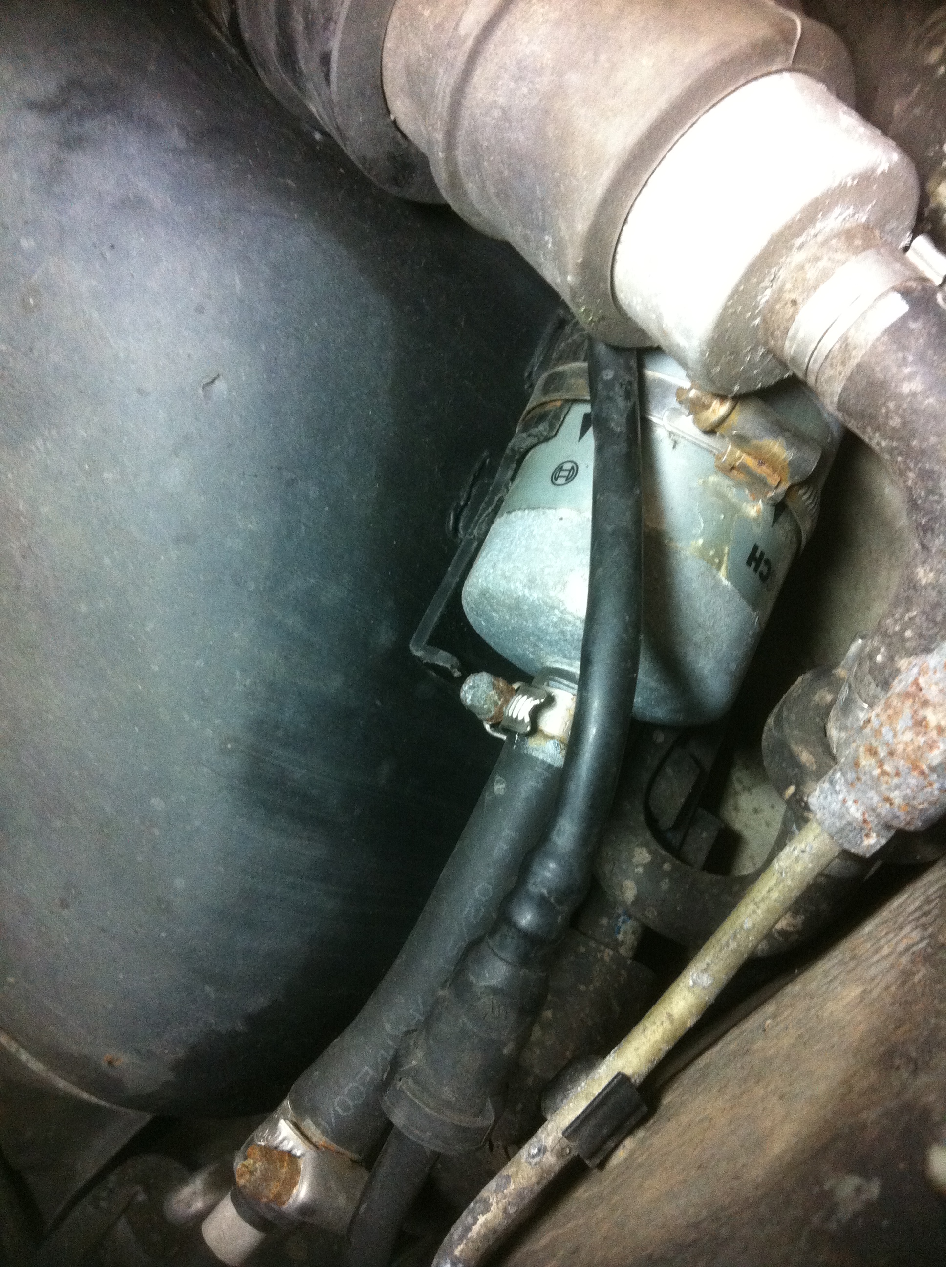

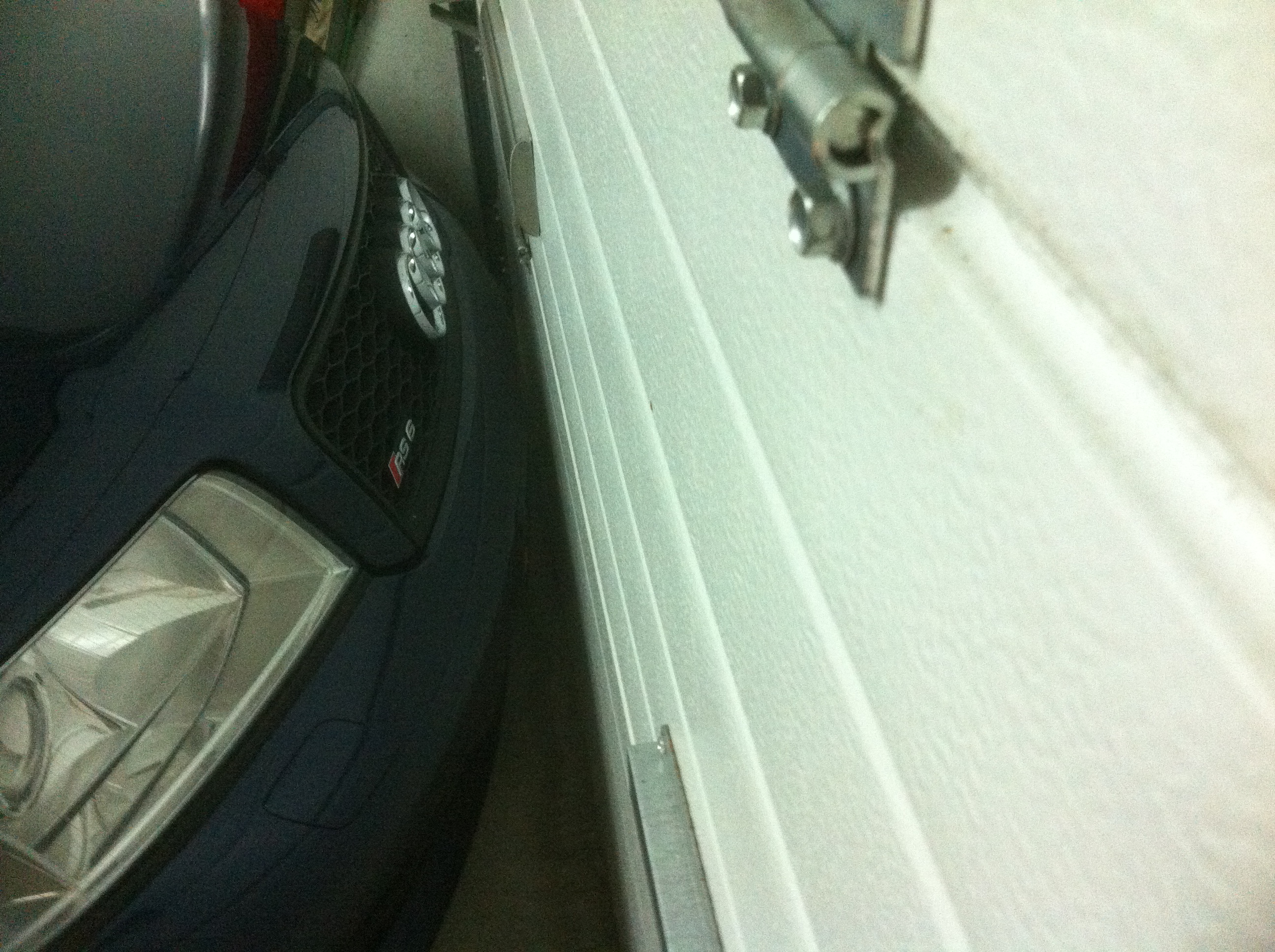

Started to take out the fuel filter, but cant get the number 3 out cos the nut on the other side is turning along with the bold and hits what i think is a drc pipe :audibash: tried some wd40 on it...

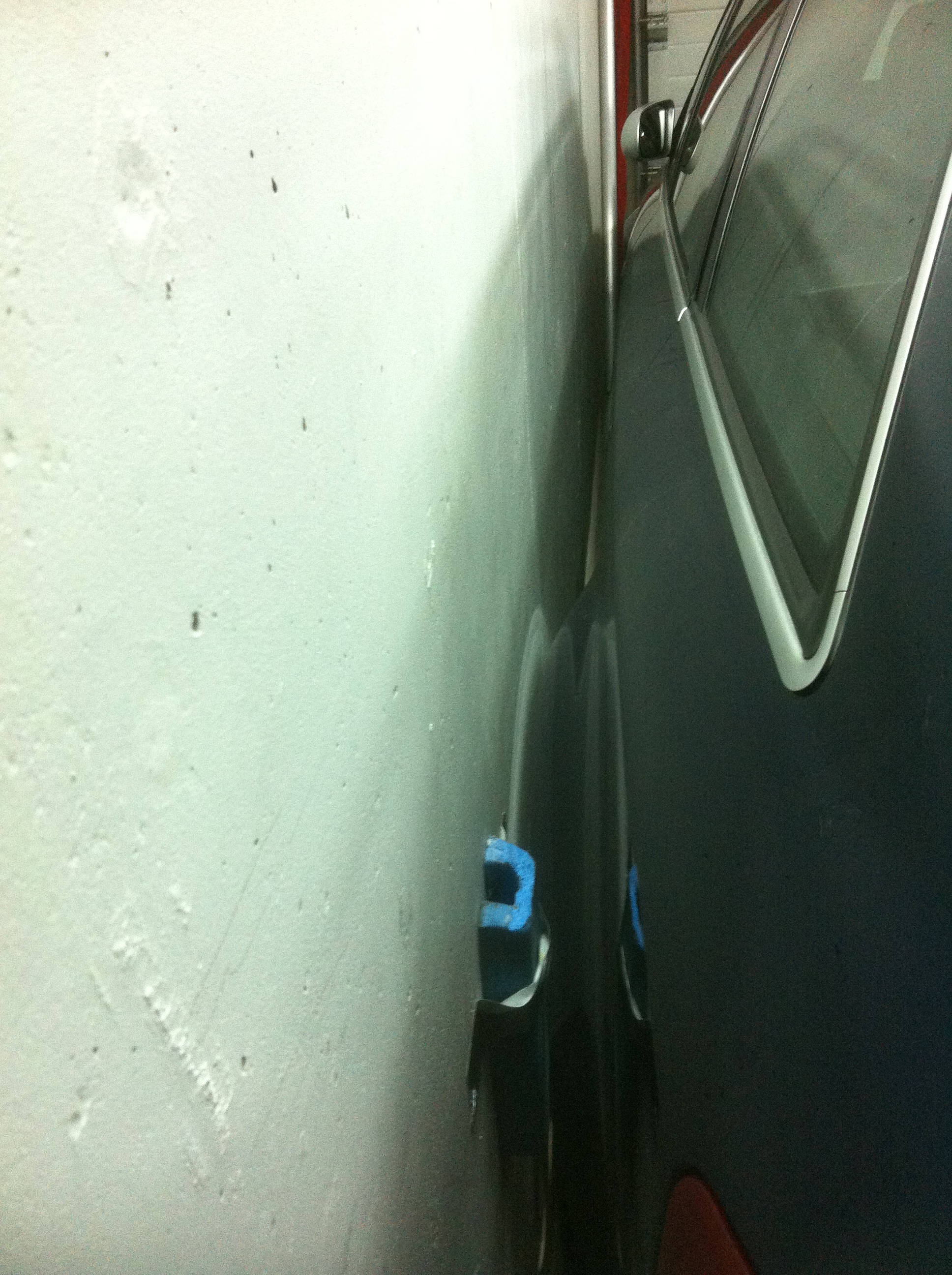

The space im working in wont help either...and dont like to work underneath with just my head.
Looks like the filter(Bosch) has never been replaced.

Wow, you've got more than enough space to work in that garage, not sure what you're complaining about.
ahoooga
Posts: 1105
Joined: Thu Dec 20, 2012 11:14 pm
Location: Well in front of that RS4
Re: Hesitation
Post by ahoooga » Mon Jul 07, 2014 5:19 pm
LOL :jump_clap:
SuprSi
Posts: 1416
Location: Southampton
Re: Hesitation
Post by SuprSi » Mon Jul 07, 2014 7:21 pm
That's impressive!
amanda1
Posts: 2476
Re: Hesitation
Post by amanda1 » Mon Jul 07, 2014 7:27 pm
Ohhh stop wingeing mav .....you have enough room for a jack :bigblink:

I just did mine and like last time I just removed the clips on one side of the filter (out) then removed the pipe from the pump out too. Then just the jubilee clip on the filter itself (put some clamps in the pipes either side too so you don't lose tooth fuel)

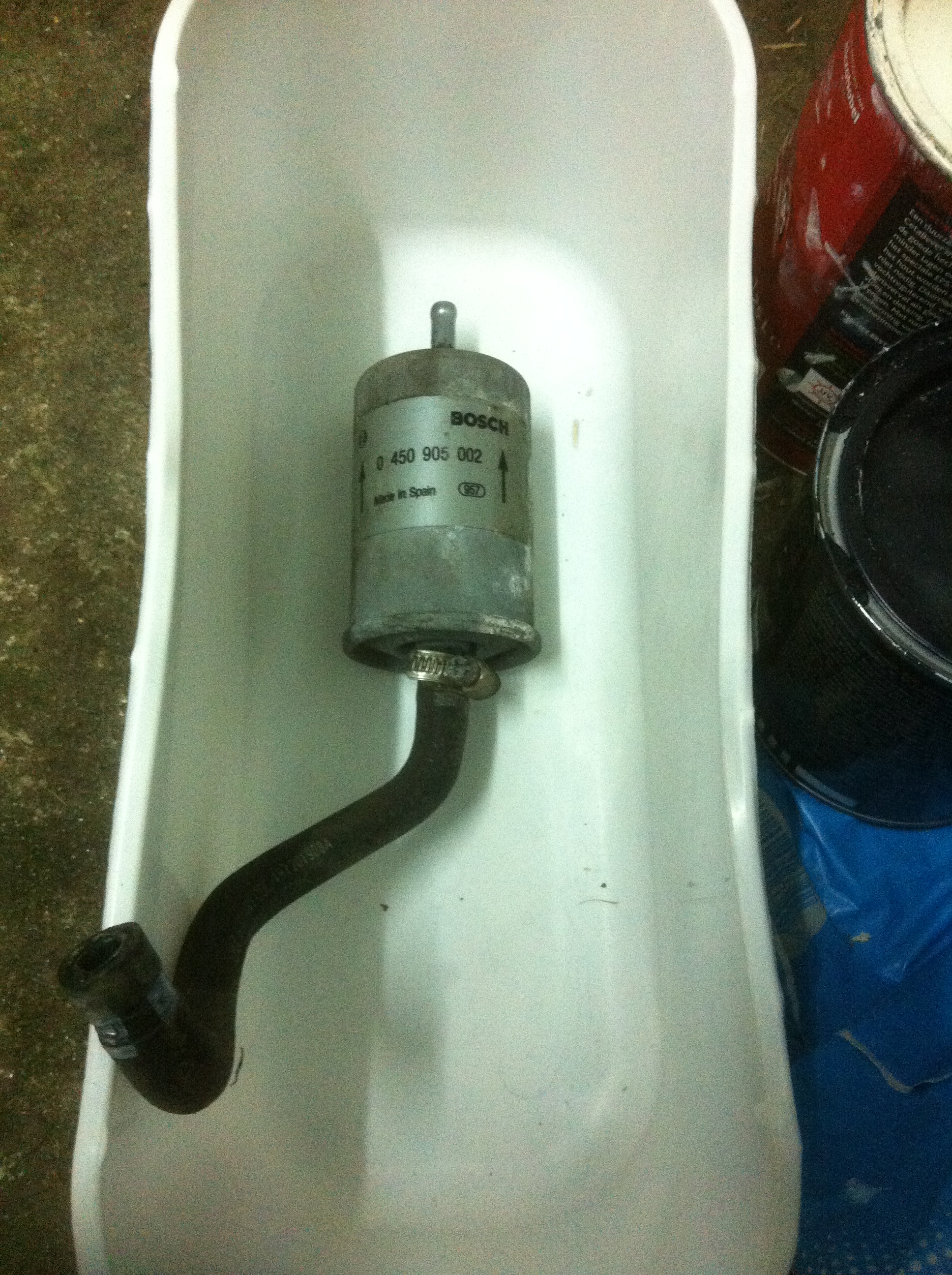

...old bastard is out.
Mugello Blue C5 RS6 Avant
Viper Tuning ECU/TCU
Yellow Koni's
Re: Hesitation
Post by bam_bam » Wed Jul 09, 2014 9:20 pm
Wow, frame it.

Cut it open, mine was black inside after only 1 year!
