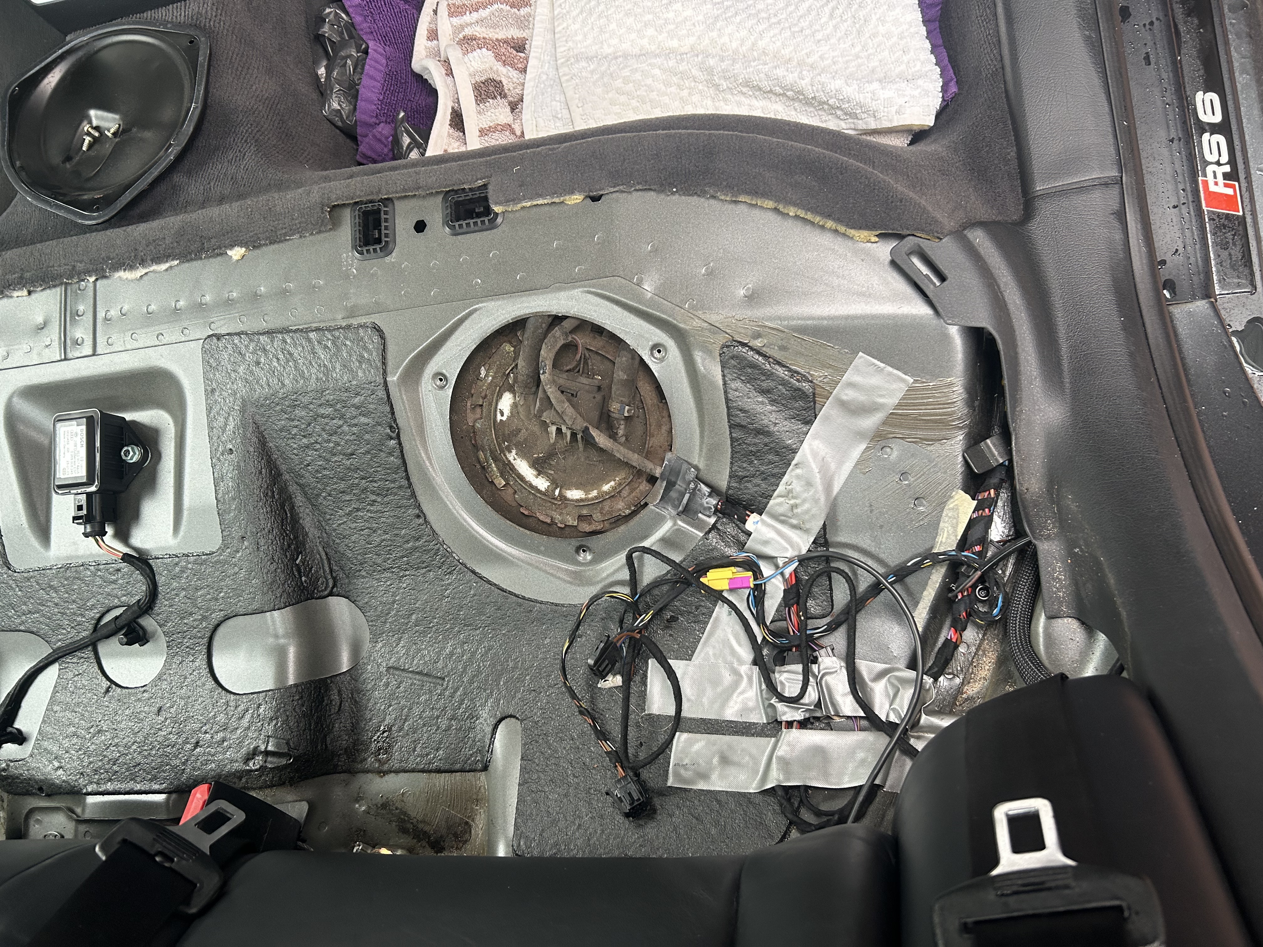

Re: Breakdown
I replaced the in-tank pump in my Volvo. It was an utter ball ache of a job. All the interior had to come out from behind the front seats.
I think the RS6 will be easier.
- Posts: 2956
Re: Breakdown
Yes mate. Access is under the rear seat.

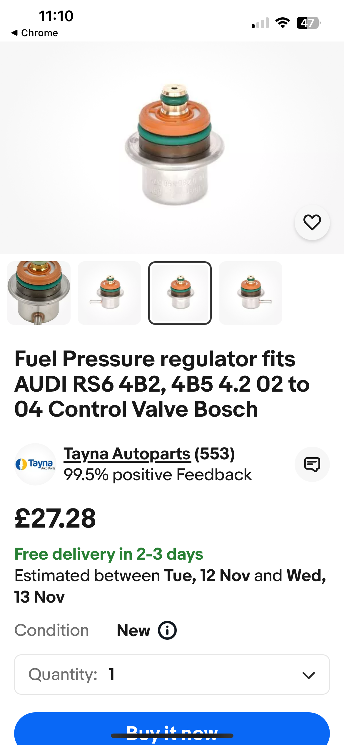

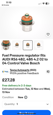

Came across this.
Anyone know its location.
IMO it’s too cheap. Will look for a OEM One.

Re: Breakdown
Engine bay just before the fuel rail for the injectors.
Re: Breakdown
In my experience they rarely go bad. The plastic filter can break but it still functions if broken. I recently change the O rings as a precaution, which is a kit for a couple of quid. Mine is from 2004 and the O rings were in good shape.steve2003rs6 wrote:
Came across this.
Just make sure you buy the 4.0 bar version as other versions exist. The pressure is stamped into the body.
Here in my picture, you can see both the Bosch and Audi part numbers

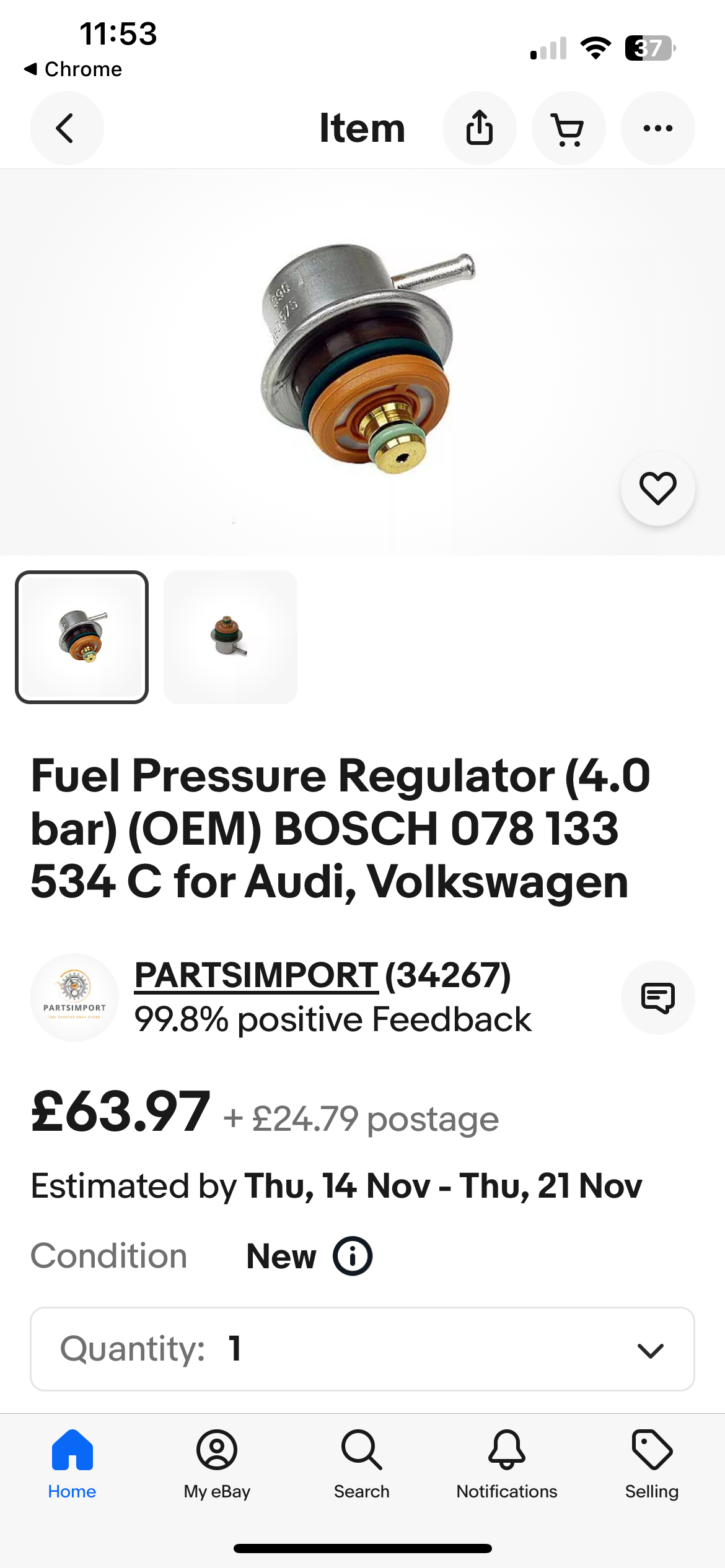

As Ben has mentioned, it’s on the fuel rail (circled).
Pretty easy job to change once the airbox has been removed. Remember to release the fuel pressure otherwise you will get an eye full
- Posts: 2956
Re: Breakdown
Cheers Ben/craig.
The one I am about to order is 4 bar rated.
If it is faulty then I have it available.
If it’s not faulty then it will be replaced during next full service.
